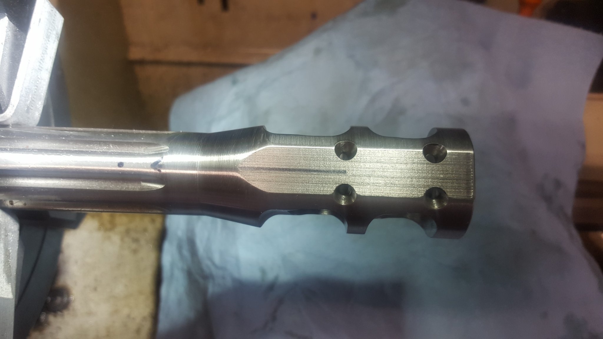

I make my own so tube size does not matter. Most any smith can build anything you want, but if your limited to plug an play it cuts the field way down. The nice thing about making your own, the correct exit holes size can be bored to your liking, if the muzzle is threaded properly. My exits are only 0.010 total over bullet size(0.005 both ways) which adds to the performance real quick.
