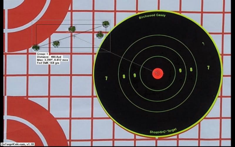

So I moved it to my next shortest range which was 400 yards and dialed in the suggested correction of 8 MOA or 32 clicks. I adjusted another average for the wind and shot a group…
As you can see, the group was a tad high and left. I misjudged the wind just a bit and it was pushing the round a bit but the elevation was consistent and that’s what’s important here. Since the group was high, I can safely assume that the muzzle velocity that I entered was too low. So I called the overall elevation offset 1.5” and then went back into the ballistics calculator and increased the muzzle velocity until the suggested correction was 1.5” lower than the previous correction. Low & behold… The MV for a perfect 1.5” turned out to be 2648 fps… lol… Pretty much as the box says of 2650… go figure…

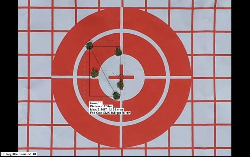

With everything all calibrated, you should be able to punch up any distance, and dial in the suggested correction and you should be right on target. I decided to test at 200 yards…. From 400 yards, the ballistics calculator suggests -5.5 MOA or 22 clicks so I dialed that in and headed over to the 200 yard range, and there she blows… Don’t laugh at the group ROFL… Me and the bullet are getting blown all over like crazy and I’m a little shooter fatigued at this point…. I was actually doing 2 different rounds on this day and shooting quite a bit more… I just extracted the info pertinent to this post *excuse*
