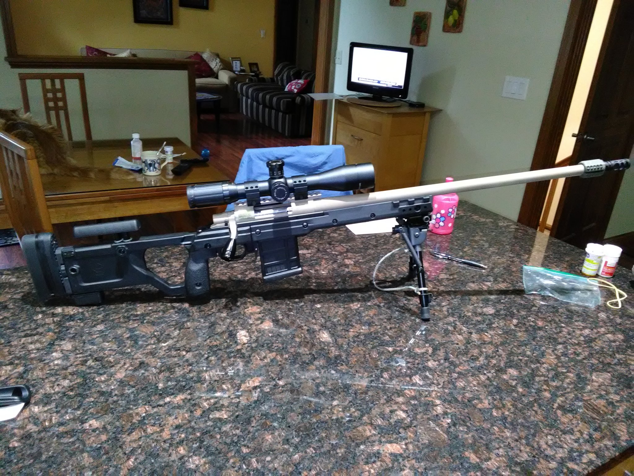

This is a 7 saum with a Area 419 brake.
recoil is very mild.
it is possible for different muzzle devices to affect harmonics to some extent.
a good brake cuts recoil in half.
