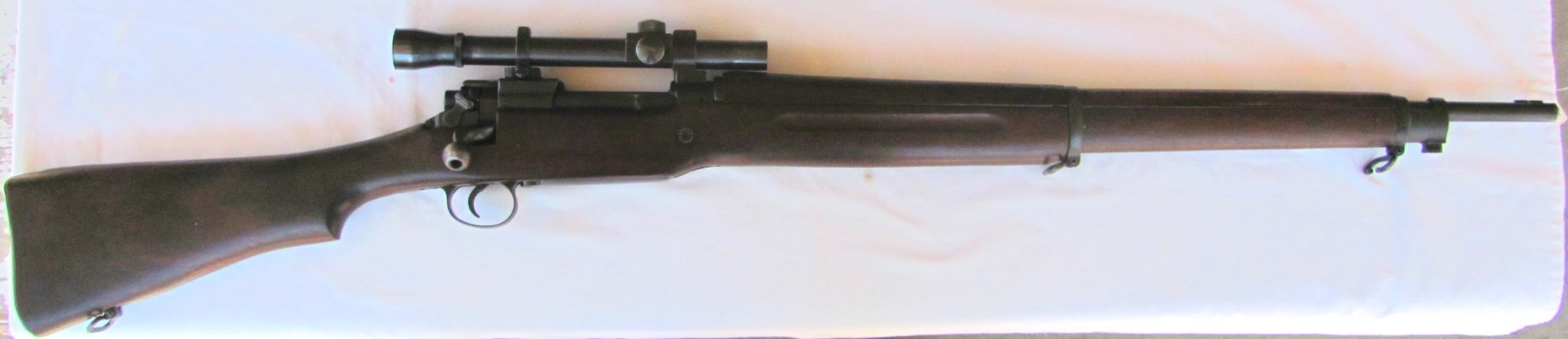

Decades ago, a friend of mine was into reenacting and wanted a cheap sniper rifle to play with. So he took one of his 1917s had the sights removed and 2-piece Redfield bases added. Then we used split-top rings and added an M82 scope. Like so many of the sniper rifles of the era, there are no National Match modifications done to accurize the rifle. With the .30-06 cartridge and a 26" barrel, this rifle will reach out there and touch someone. As my friend aged past shooting, he passed the rifle on to me

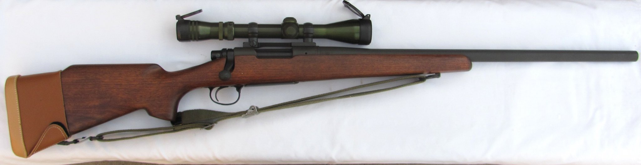

After the economy collapsed back in 2008-09, I decide to stop buying original sniper rifles. Another friend of mine was into building reproduction M40s, I decided to jump onto his band wagon. I purchased a scoped Varminter Special for $585, sold the scope and began working on the stock. I believe that Remington called these stocks M&Ps. In the mean time, I had the receiver cut by a local gunsmith whom my friend had given the blueprints of an M40 to. Then engraved with "U.S.", the next stop was having the receiver and barrel parkerized. The Redfield scope was iodized green, and the base and rings nitrided. This rifle loves 180 grn. bullets, which I used to take down an elk years ago. In my older years, I added the sissy-pad.
