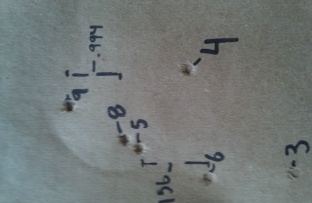

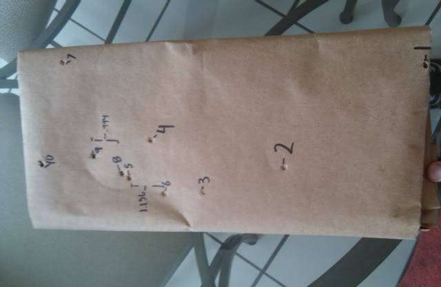

Here's my ladder test day 1(450yds)

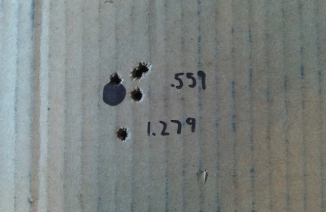

Here's ladder test day 2 refining accuracy node.(450yds)

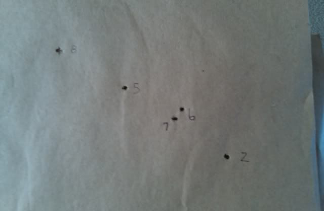

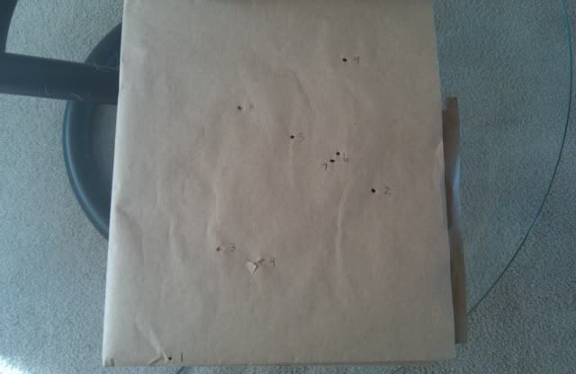

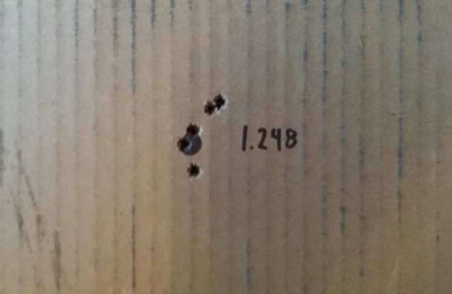

Here's today 5 shot grouping.
.010 jammed
touching the lands
.010 jumped
It clearly shows the rifle likes the jump instead of jam or even just touching. Rifle is a savage model 12 with varmit/bull barrel. Im using speer 100 SPBT bullets, behind 40.9gr of H4831, remington 9 1/2" primers.
Im sure my case prep, and bullet prep isnt the greatest yet, but Im pretty happy with under a .5" group minus the flier in my 5 shot grouping.
