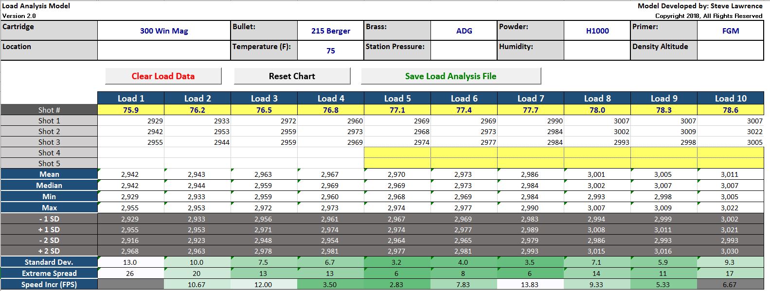

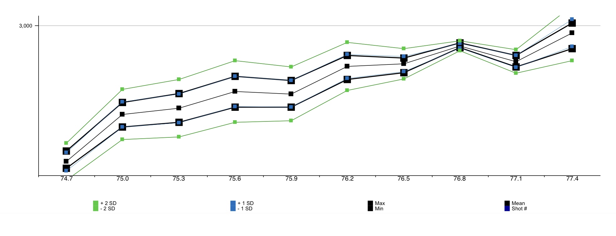

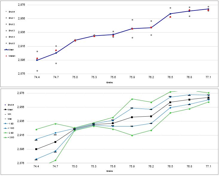

    I started with new ADG brass on this work up. I am very happy with the numbers compared to my old setup. I am going to work the node and it looks like there may be another one at the top of my chart. I had no pressure signs yet either.
    - ADG 300MW brass
    - Berger 215 Hybrid bullets
    - H1000 powder
    - Federal GM primers

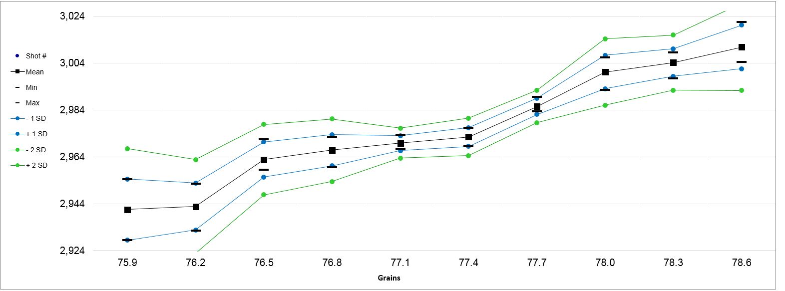

    View attachment 7372810View attachment 7372811
    Man this chart is legit! The results too! I have the same components going to start working up soon. Thanks for sharing

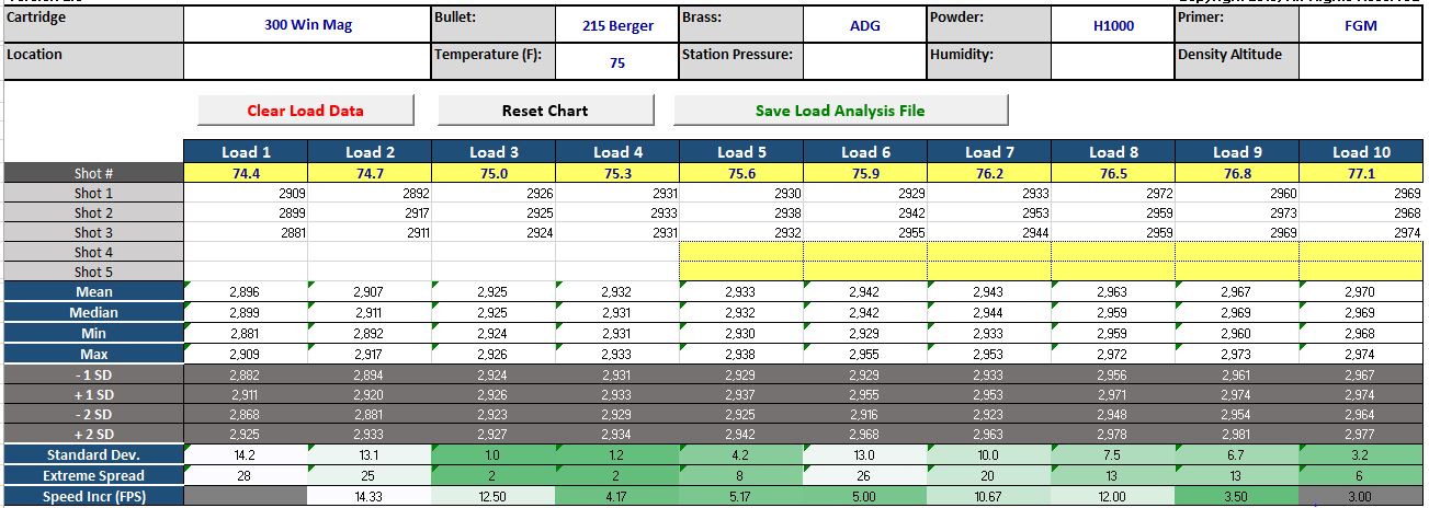

    I loaded some more a little hotter and finally settled on 77.1.
    I am very happy with all the single digit SD's. All the new gear is definitely paying off

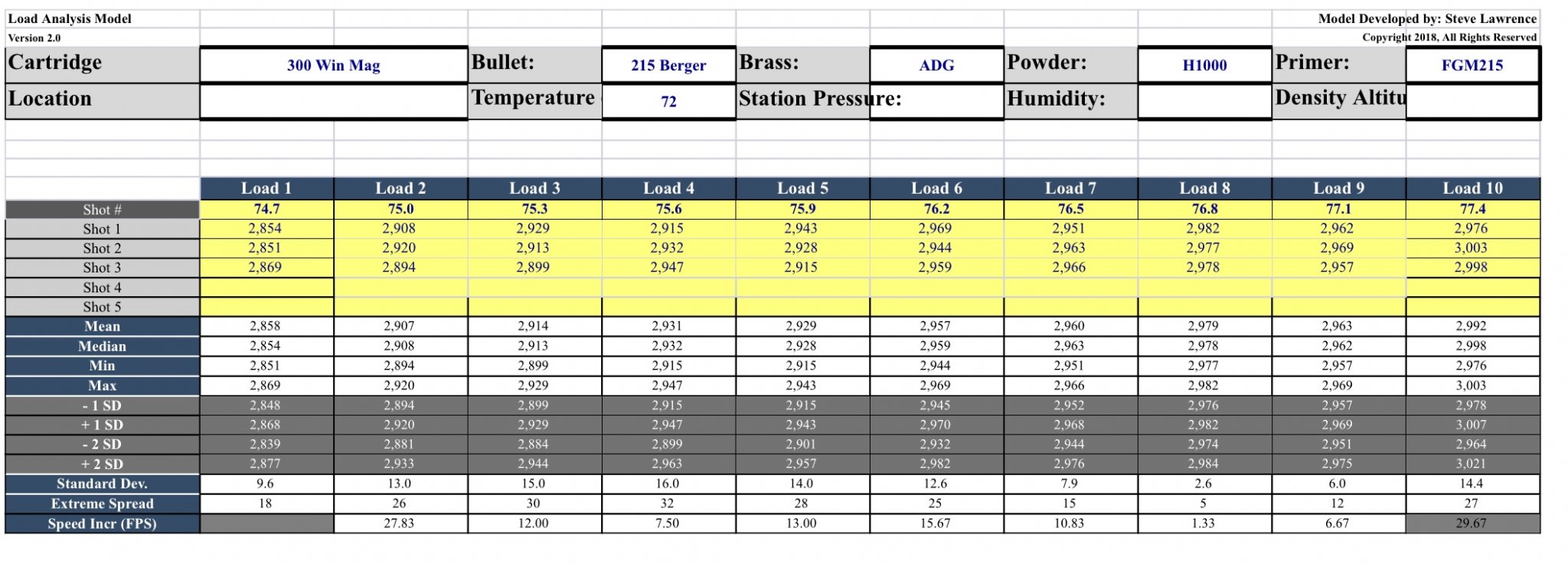

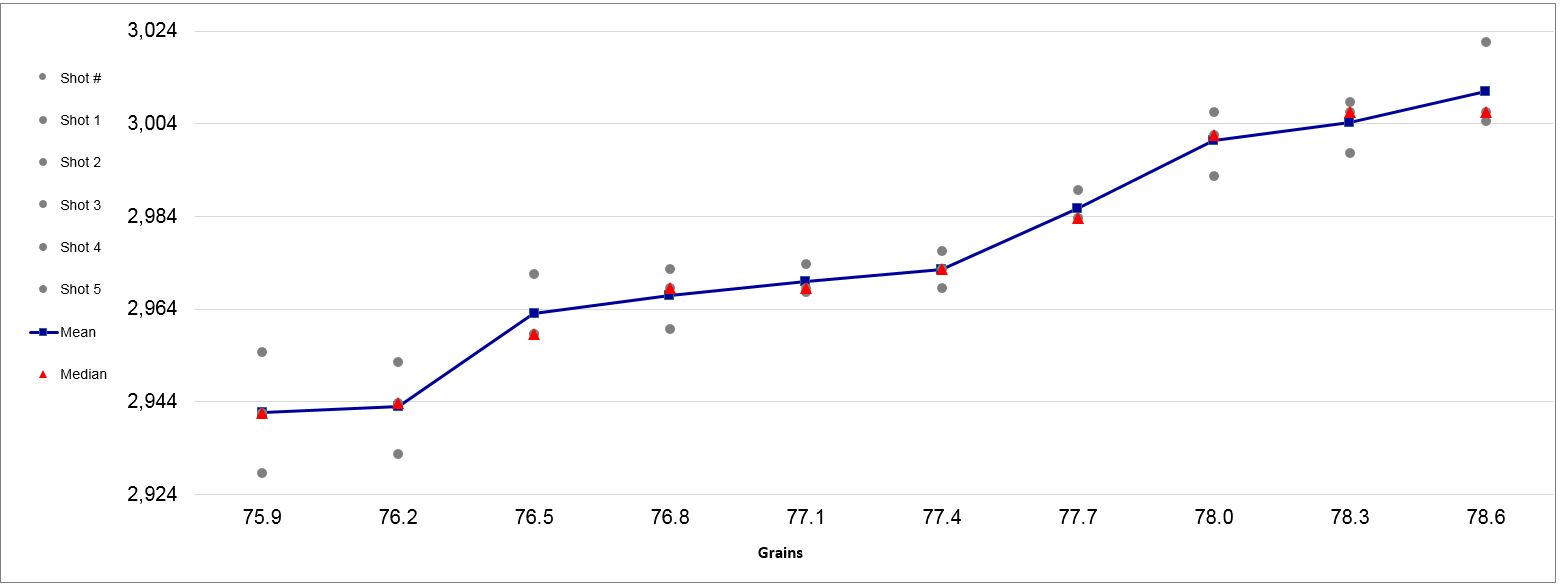

    I just finished up my testing using the same graph you sent me the link to using the same power charge weights and components. .015”
    off the lands. I settled on 76.8!
    I’m going to test seating depth a lil bit more next.
