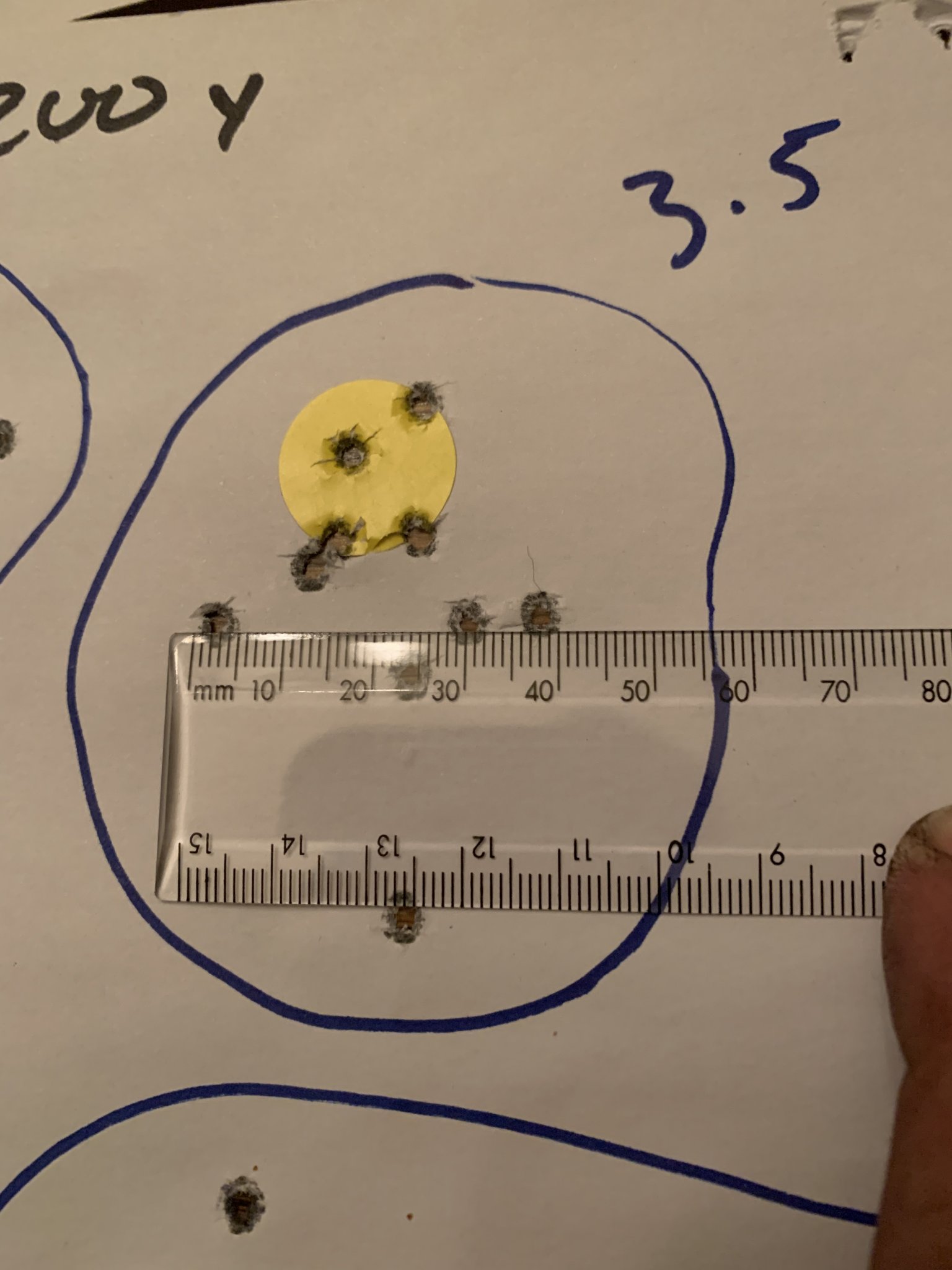

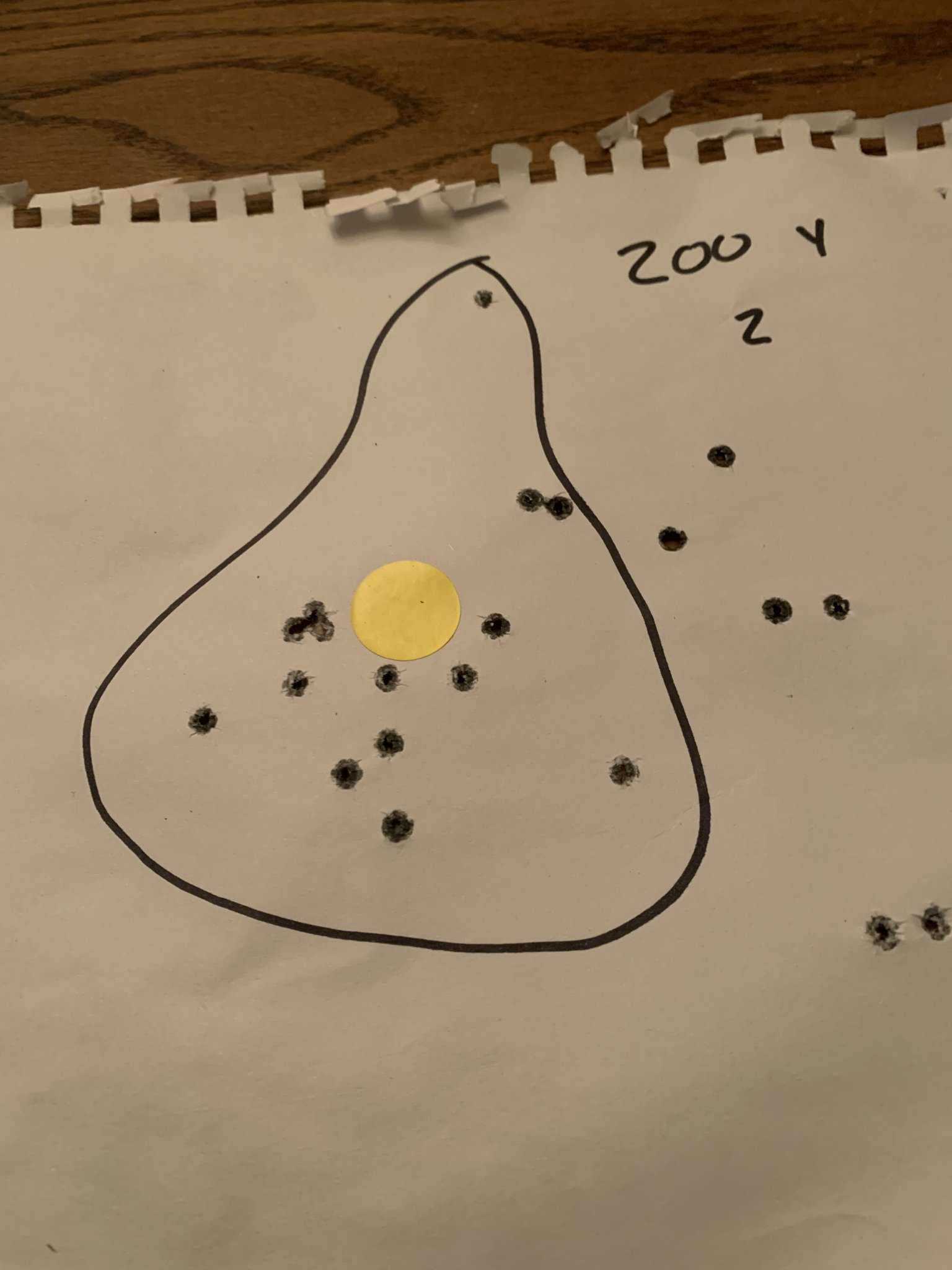

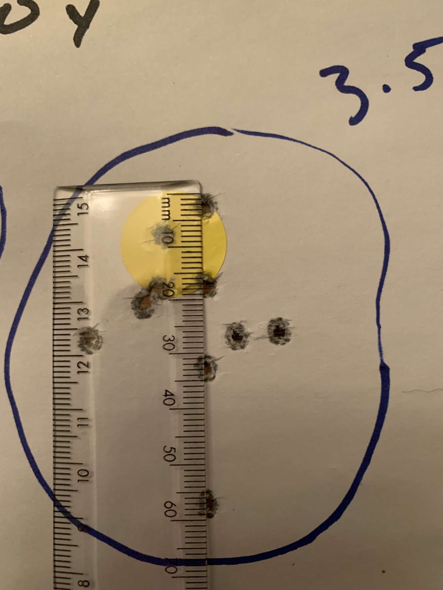

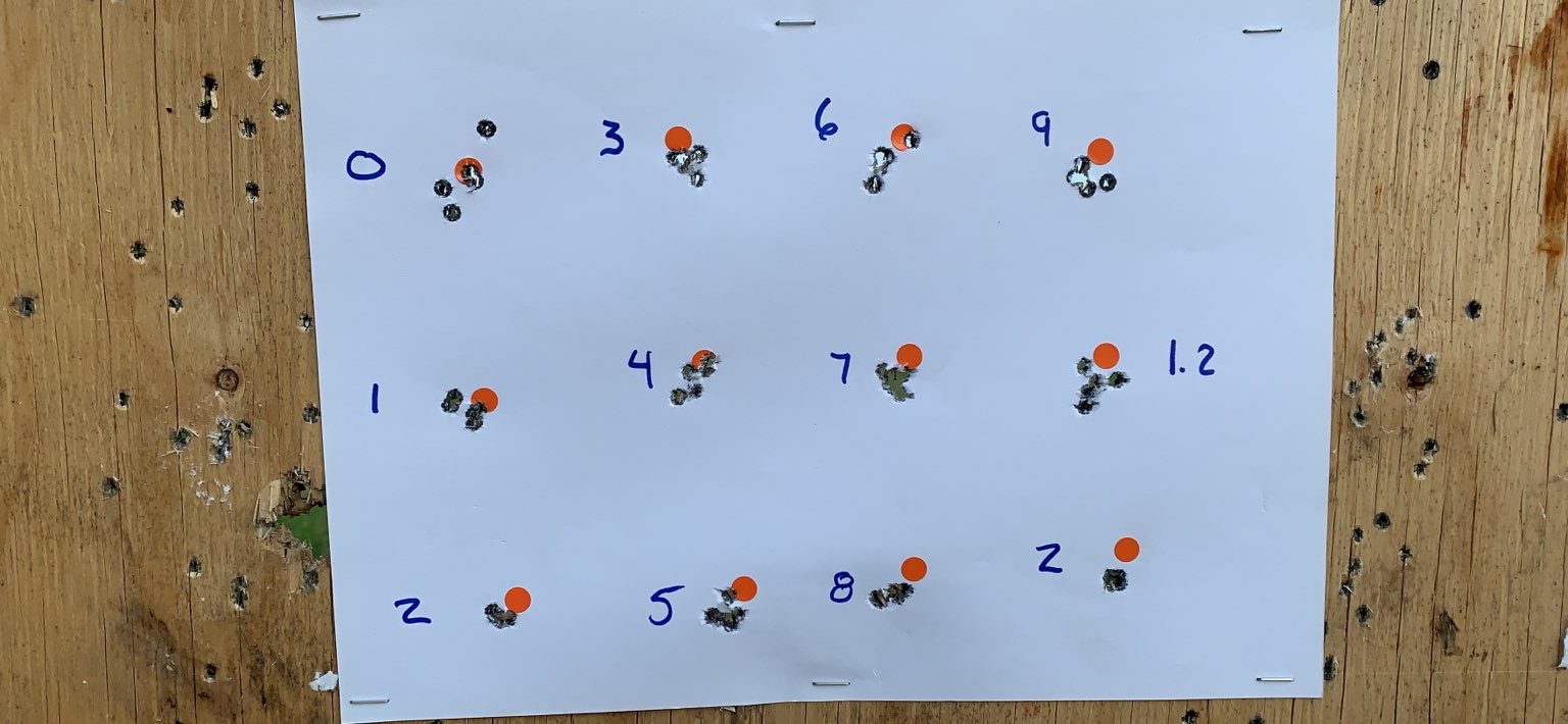

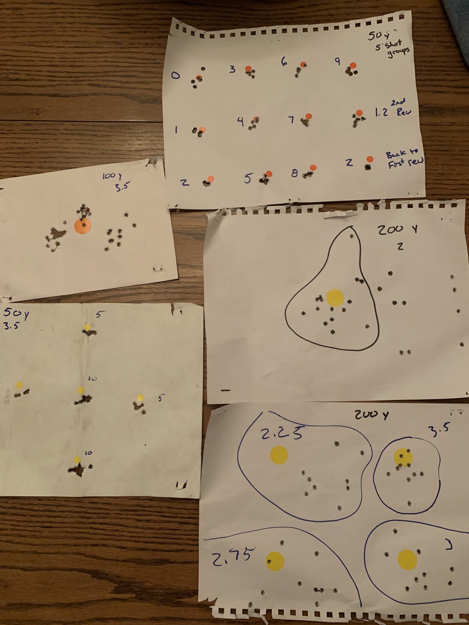

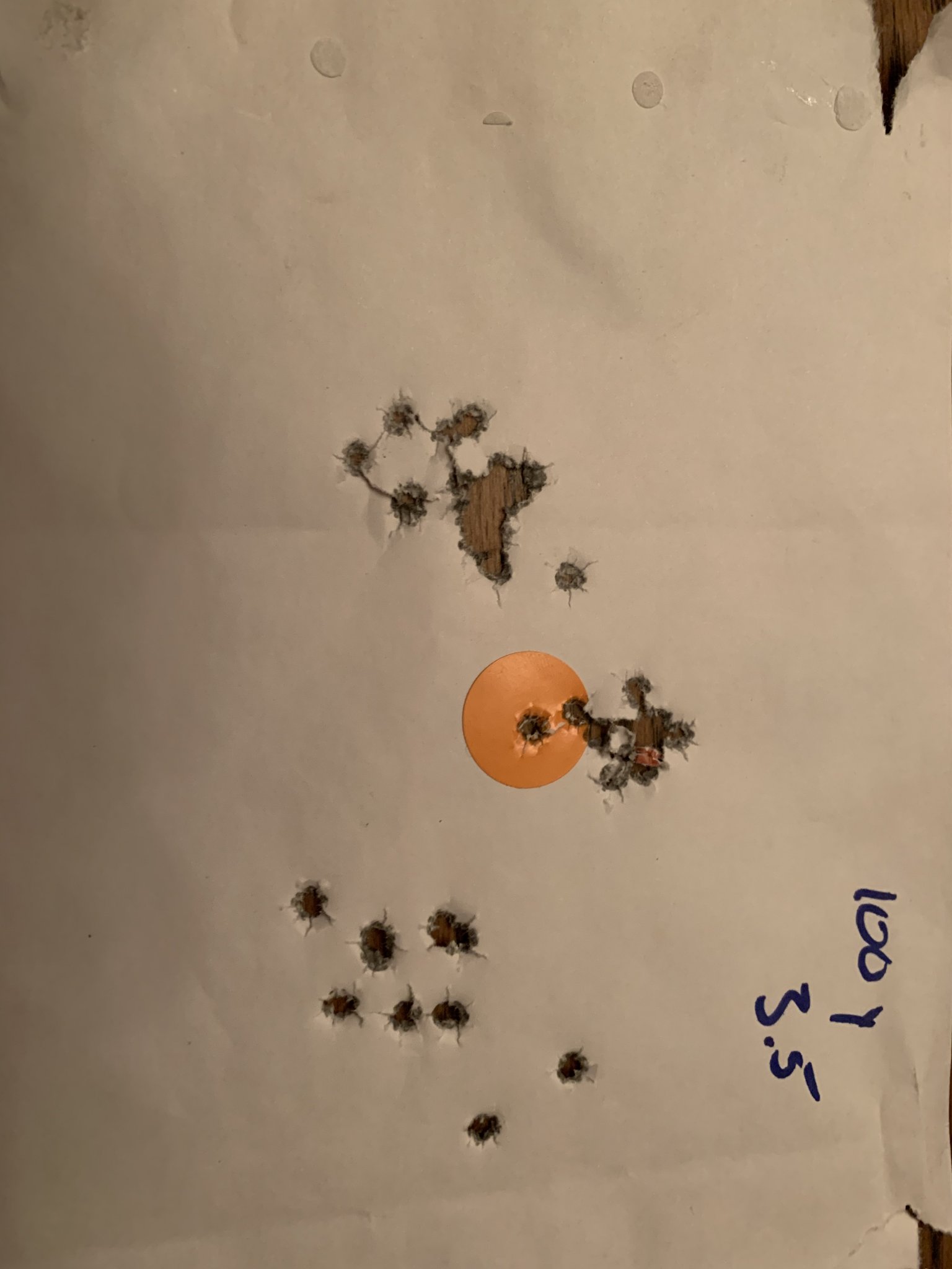

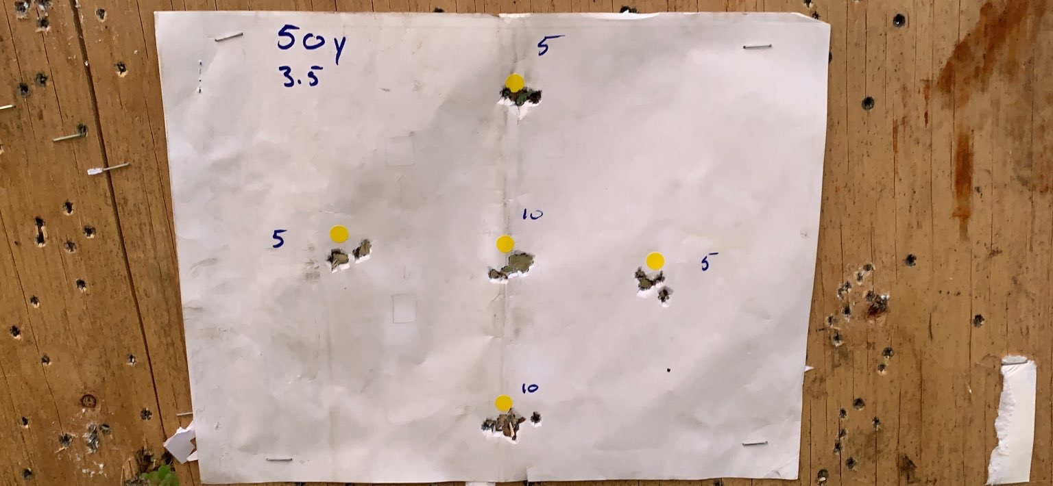

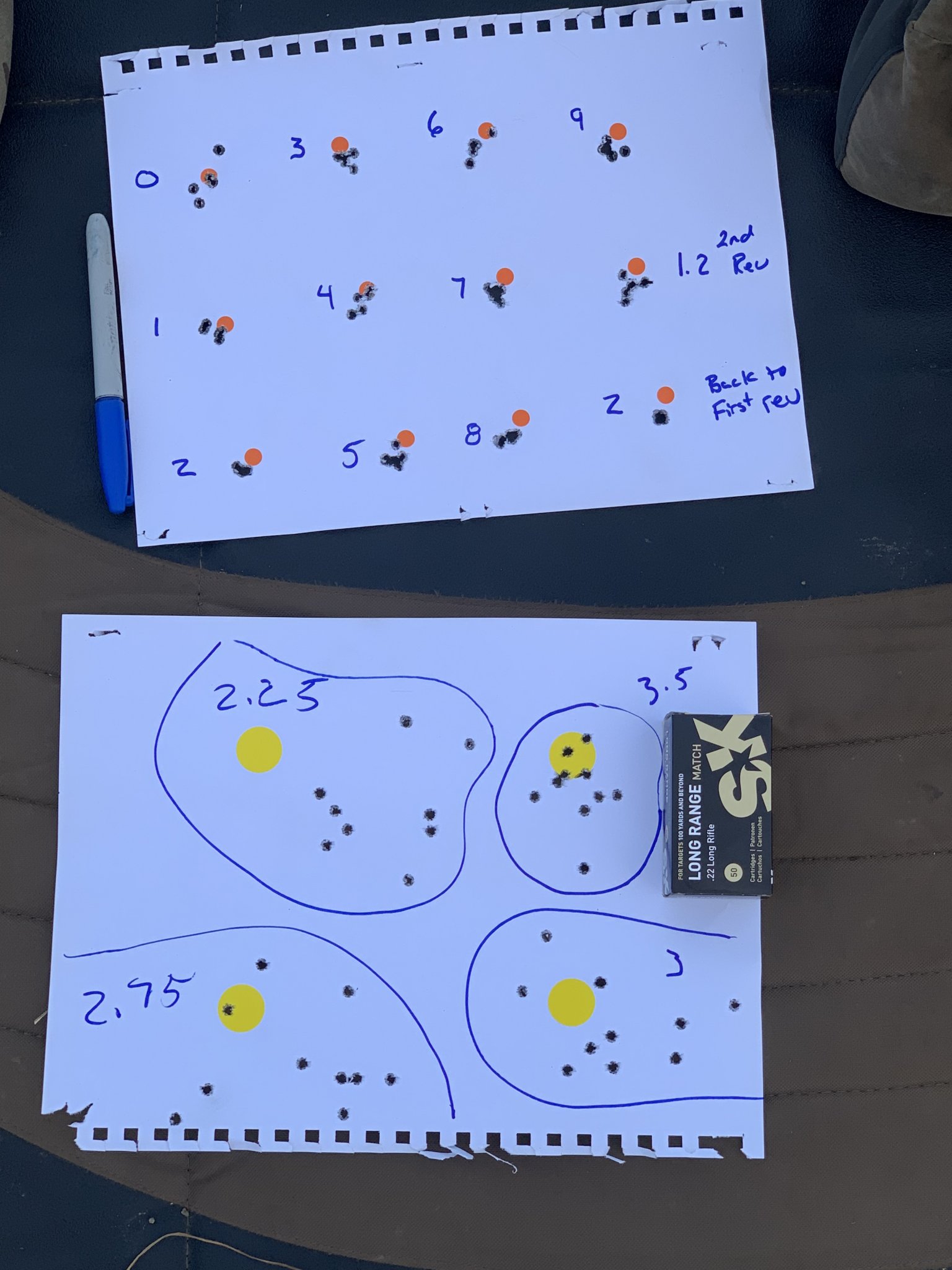

Well my first post in a quite some time and it’s going to be a lengthy one. I had heard a lot of good things about the tunacan 22lr barrel tuner from reddnobb, so I decided to give it a try. It arrived in the mail today, so after work I threaded it on and headed to the field I shoot at. I shot 5 round groups at each of the ten full settings on the tuner to see where the tightest nodes were. Setting 2 gave the best results at fifty and they were repeatable. So I moved out to 200 yards. First mag I didn’t hold wind and was at edge of target so I held wind and sent 15 rounds. Target was icky, so I put up a new sheet with four aimpoints and tried smaller adjustments from 2.25-3.5. I shot a few groups at 200 last week and will post a pic of one for comparison, but at setting 3.5 I shot one of my smallest 200y groups. I then moved the target in to 100, shot at setting 3.5. The one group I had a really bad flier on shot three so I sped through the mag really fast. Then I moved in to 50y to verify setting 3.5. I was a little skeptical at first but the proof is on the paper. I’m 100% convinced barrel tuners work. And now for the pictures.

I wasn’t sure how many photos I could add at one time so here is the group from last week versus today’s 200y group.

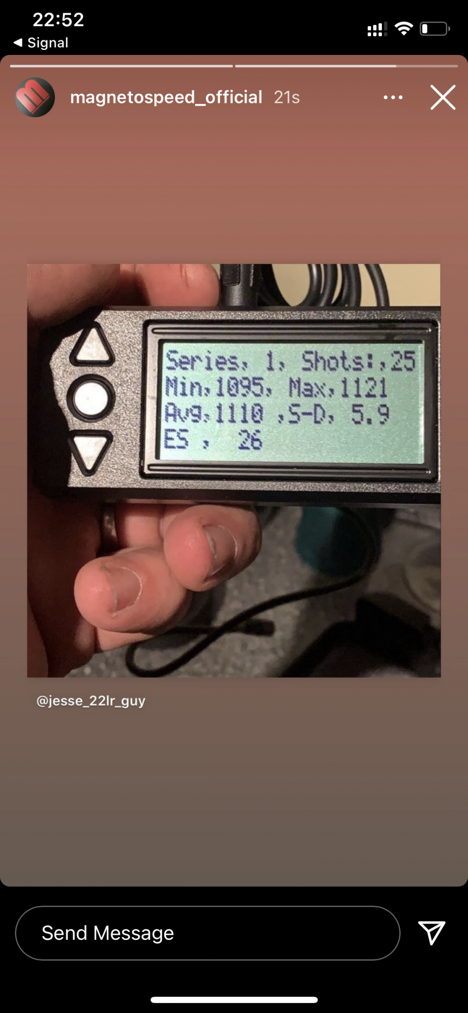

Here is what the magnetospeed shows for this lot of sk long range match. And a picture from before I got my tuner, a little something to hold you over till I get home from work.

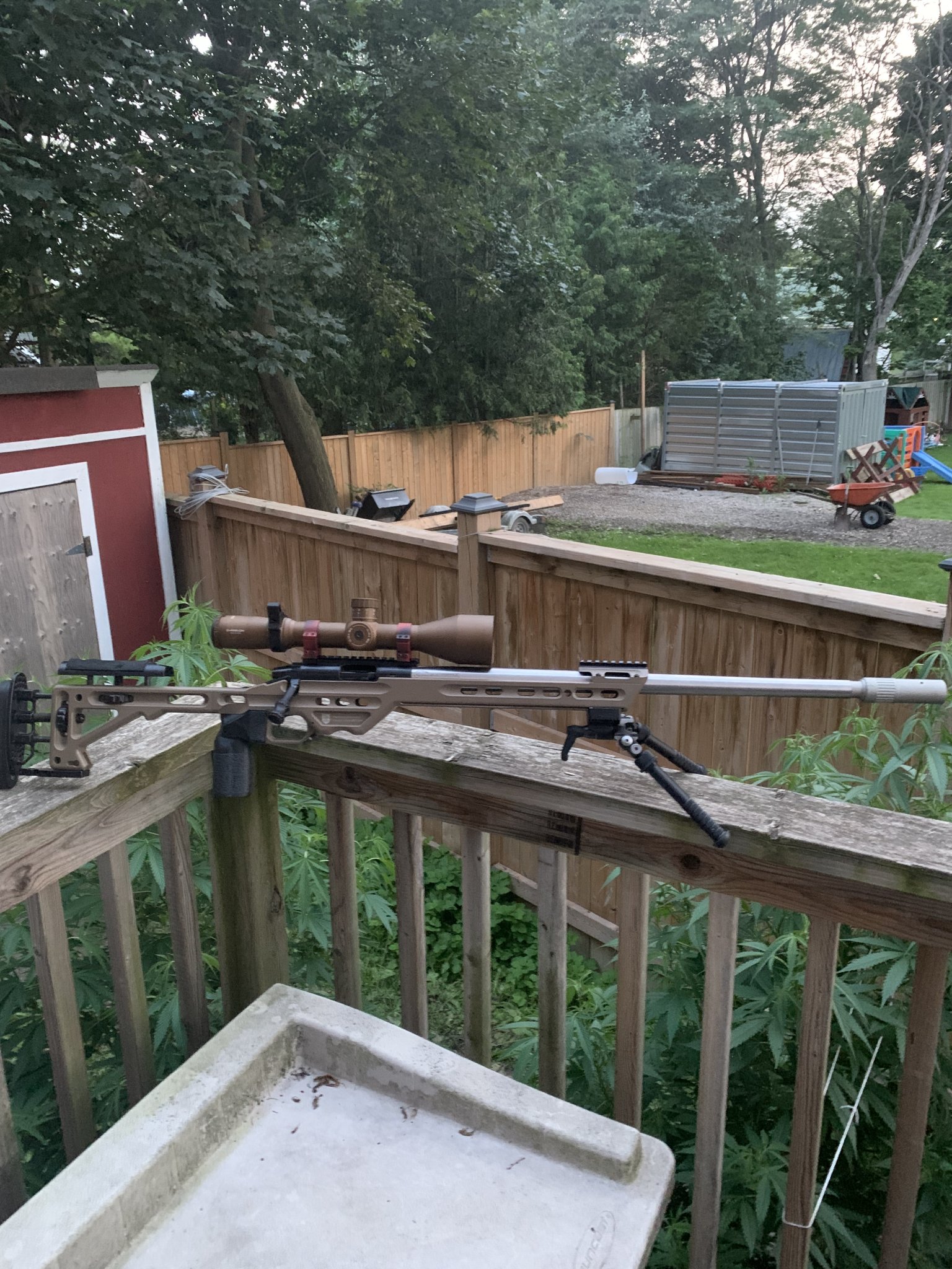

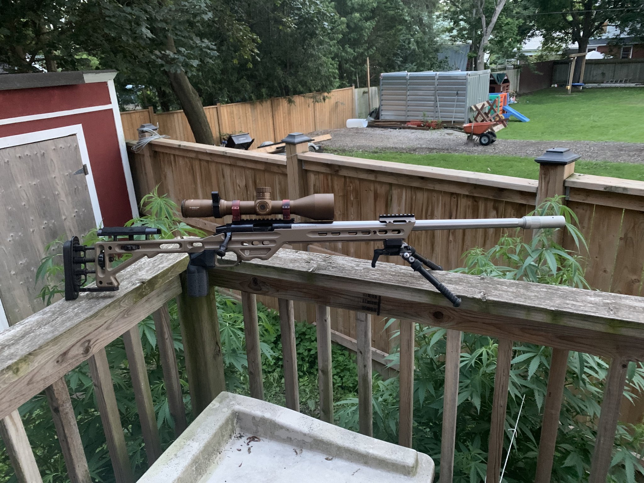

And with no further ado, here is a picture of my baby.
RimX action
Lothar barrel chambered by PVA
1:12 twist
22” long
Athlon cronus
Atlas biood
MPA ba comp chassis
Tunacan barrel tuner
Triggertech diamond, set silly light
Oh it makes me happy every time I look at this. The chassis will be cerakoted northern lights, a cooor shifter that changes from titanium blue to metallic green. Rings will be burnt bronze to match the scope.
