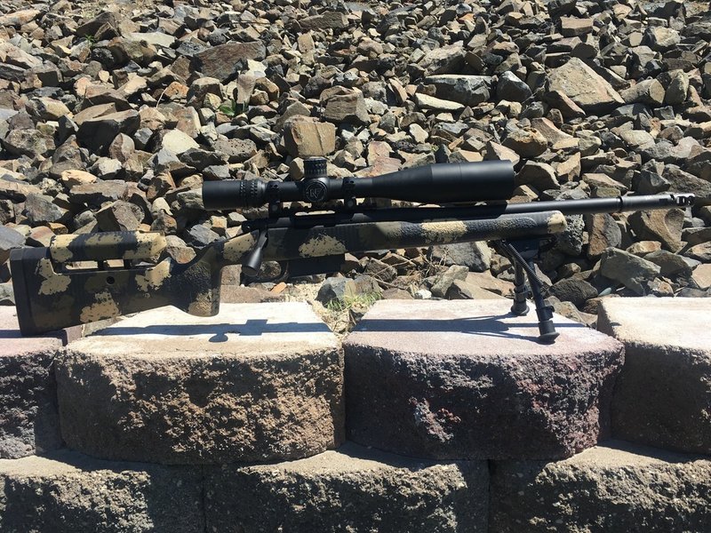

Found this picture of someone else's build on here, and it's almost exactly what I'm going for, minus the short barrel. It's got the break, the stock, (almost, its a T-2A from the look of it) the camo, etc.

If you do go with the surgeon, most definitely leave it alone mechanically. If your $1300 actions needs truing, you should get your money back, not dump more into it. Also, the factory remington extractor is a plus in my book. It has an integral lug, and a side bolt release as standard.
Having said all that, I love the Bighorn tl3. It's absolutely a work of art that wont need any extra attention, and has all the features you want in the surgeon, plus some extras for less money than the surgeon. The money you save in the action price will buy you a barrel vice and an action wrench, and you wont need SAC do any work for you as you'd assemble it yourself. Same bolt knob threads as the surgeon, so the knob you wanted for the surgeon, will fit the Bighorn. Really no change to your build but swapping the surgeon for the tl3. On the brake, I can think of a dozen other brakes that i'd choose over the surfire. Only reason id run one was if I had a surfire can.
There are other good brakes out there, but in the end, what are you going to love? If you have an APA but wish you had the Surefire, then get the Surefire. I've been running Silencerco ASR, but that's because I run my can on it.
