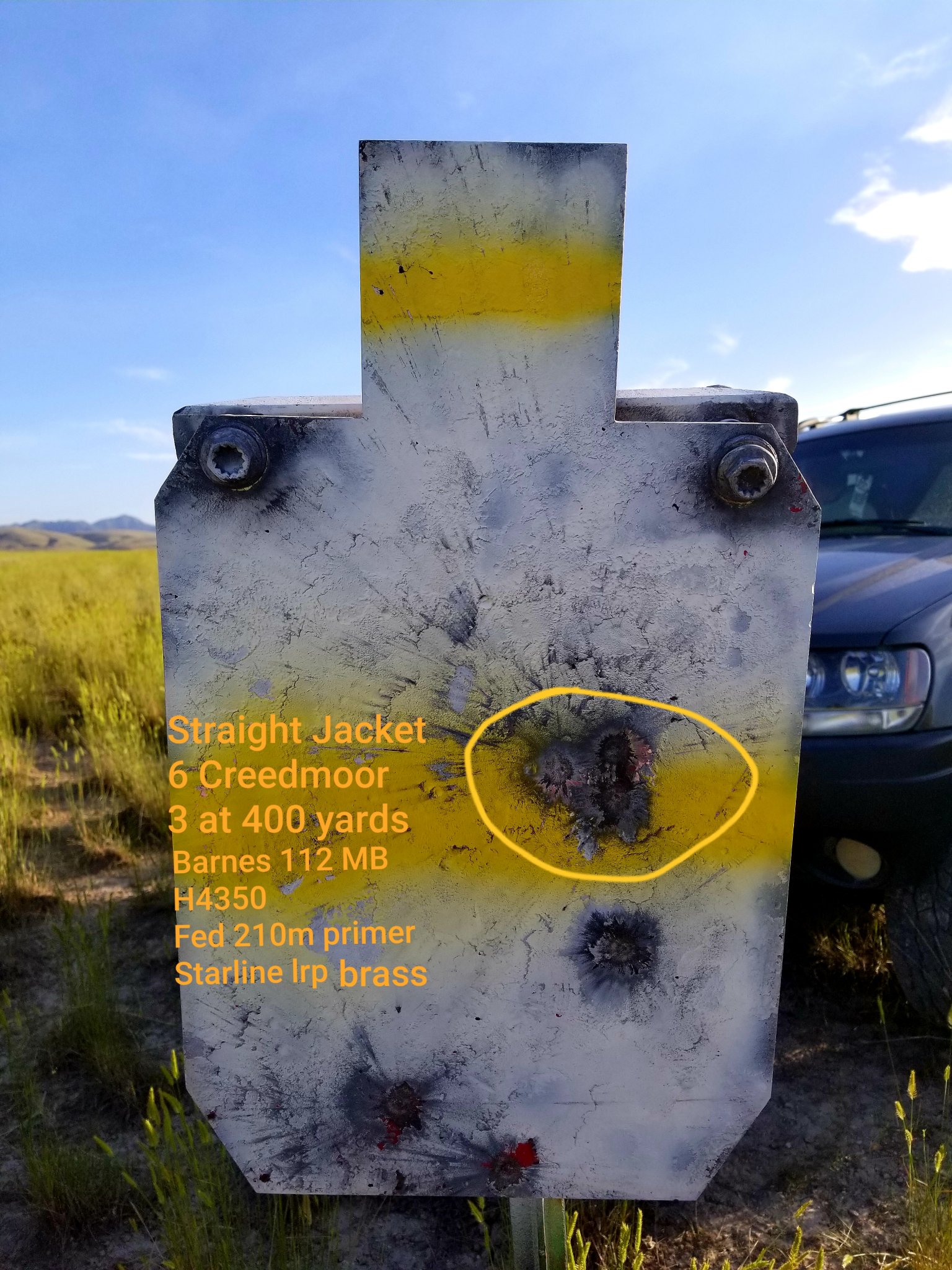

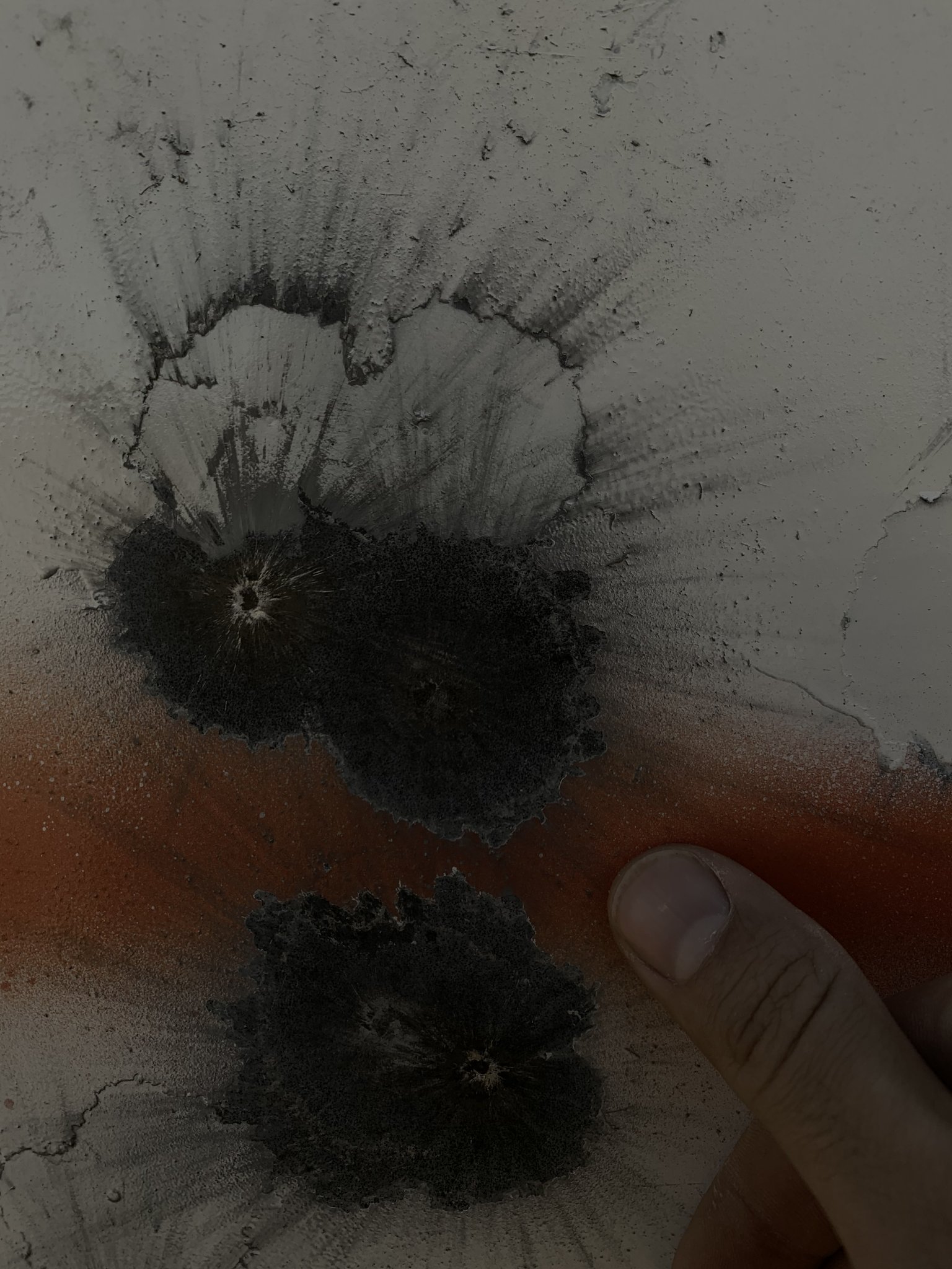

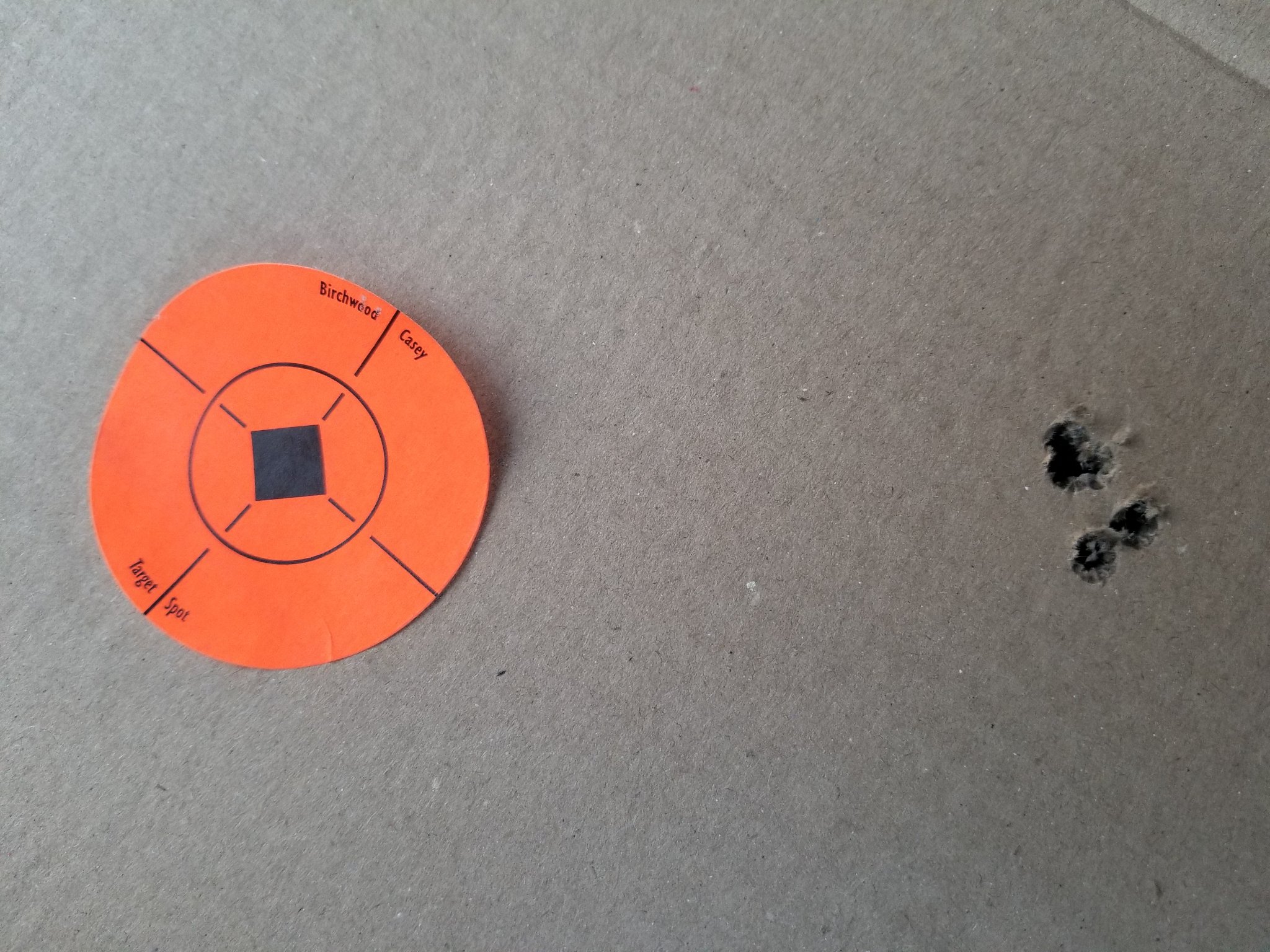

Loaded 30 rounds for my 20 inch 243 Winchester. I did zero load development. Jumped right in at the same load I use for the 105 Hybrid. Velocity was measured using a Labradar.
•Winchester brass
•IMR 4451
•Cci 200 primer
•Barnes 112 match burner
.010 off the lands.
•Average velocity 2921 fps with an SD of 13.
Right 3 shots are at 996 yards from a 243. Calculated BC was .320 G7.
Left 2 shots are from a 6mm creed using the same bullet at 996 yards and the same calculated .320 G7 BC lines up for both.
Second picture is 5 shots at 100 yards.

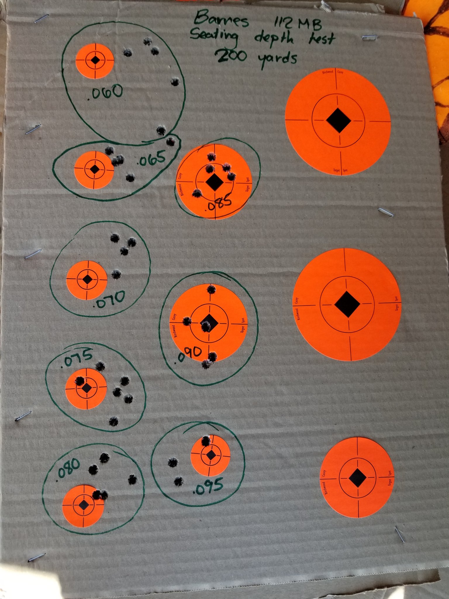

Today I did a little more testing with the 112MB. First I shot a ladder test using my AIAT chambered in 6mm Creedmoor. I found a nice Node right at 2940 fps.
Then I put together a seating depth test to determine the optimal seating depth. My 6mm creed barrel has ~1400 rounds on it. It shoots well but is pretty long in the throat. Loaded to magazine length 2.960 they are jumping .060. I proceeded to seat deeper and shot consecutive 5 shot groups at 200 yards. Here are the results.
Then I put together a seating depth test to determine the optimal seating depth. My 6mm creed barrel has ~1400 rounds on it. It shoots well but is pretty long in the throat. Loaded to magazine length 2.960 they are jumping .060. I proceeded to seat deeper and shot consecutive 5 shot groups at 200 yards. Here are the results. View attachment 6939572
If those are all five shot groups, the .070 and .095 look best.
Did you chrono the seating depth velocities?
I've read that changing seating depth can move the MV off the accuracy nodes.
I did have the LabRadar running while shooting the seating depth test loads. I didn't see too much difference in velocity but near the end the mirage was getting pretty bad and it was hard to make out the 1 inch orange dot at 200 yards. They are mostly 5 shot groups. .095 was only 3 shots and I accidentally shot one of the. 070 bullets at the .075 target. Thanks for the input!

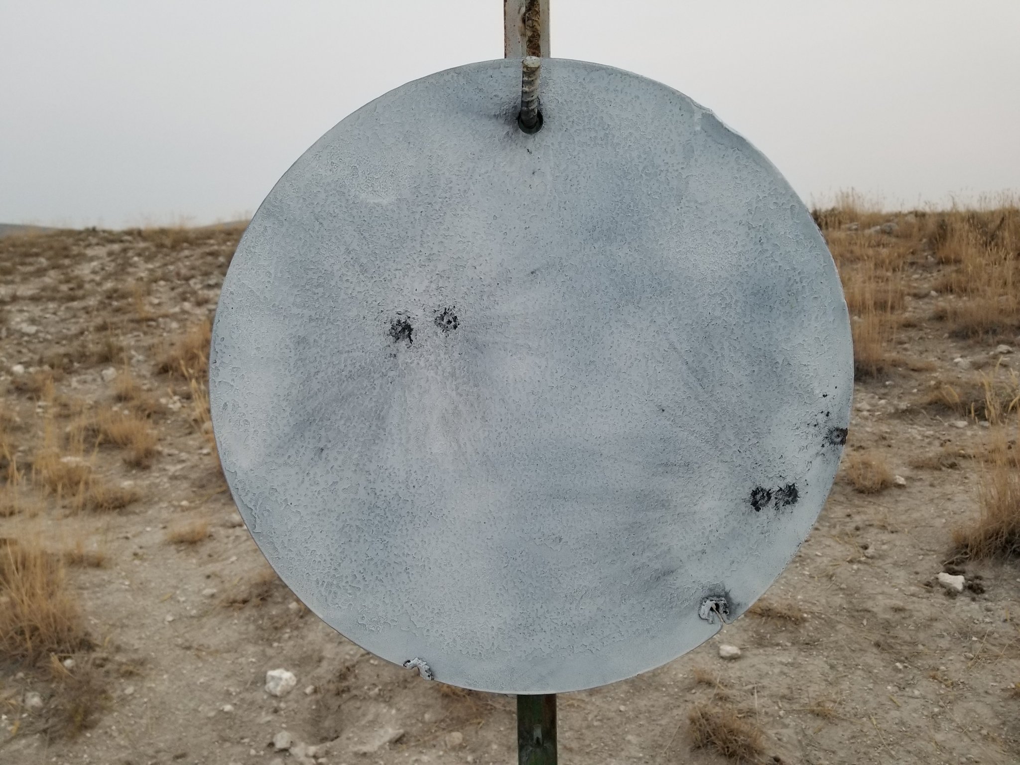

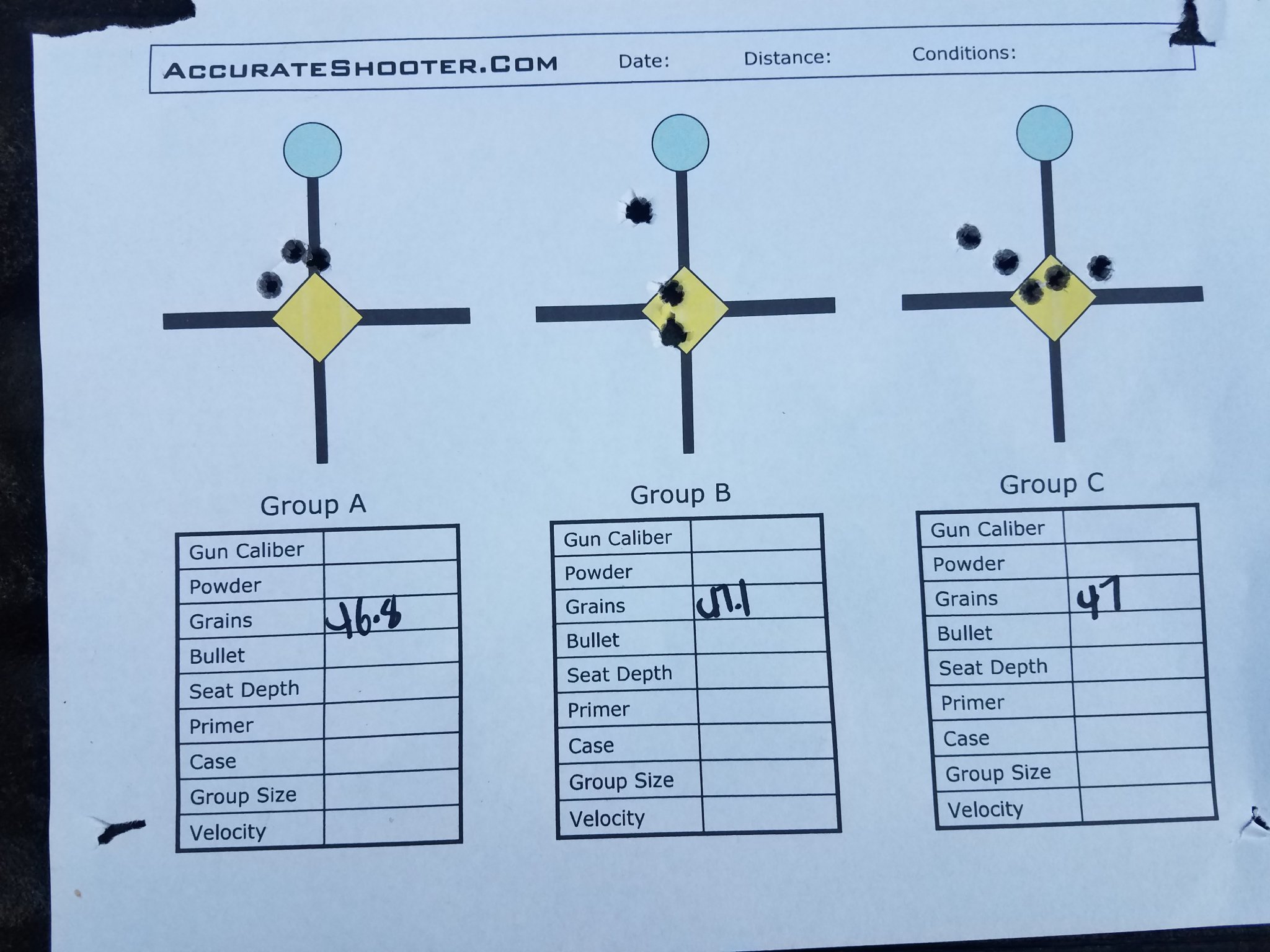

Finally got out and shot the loads. Loads ranged from.2950-3050, with SDs of 12-25. 100yards, 26" 1/7
looks like you have some potential there! I shot another 50 of these over the weekend and they were spot on from 200-1000 yards. Even jumping .080 didn't seem to matter.

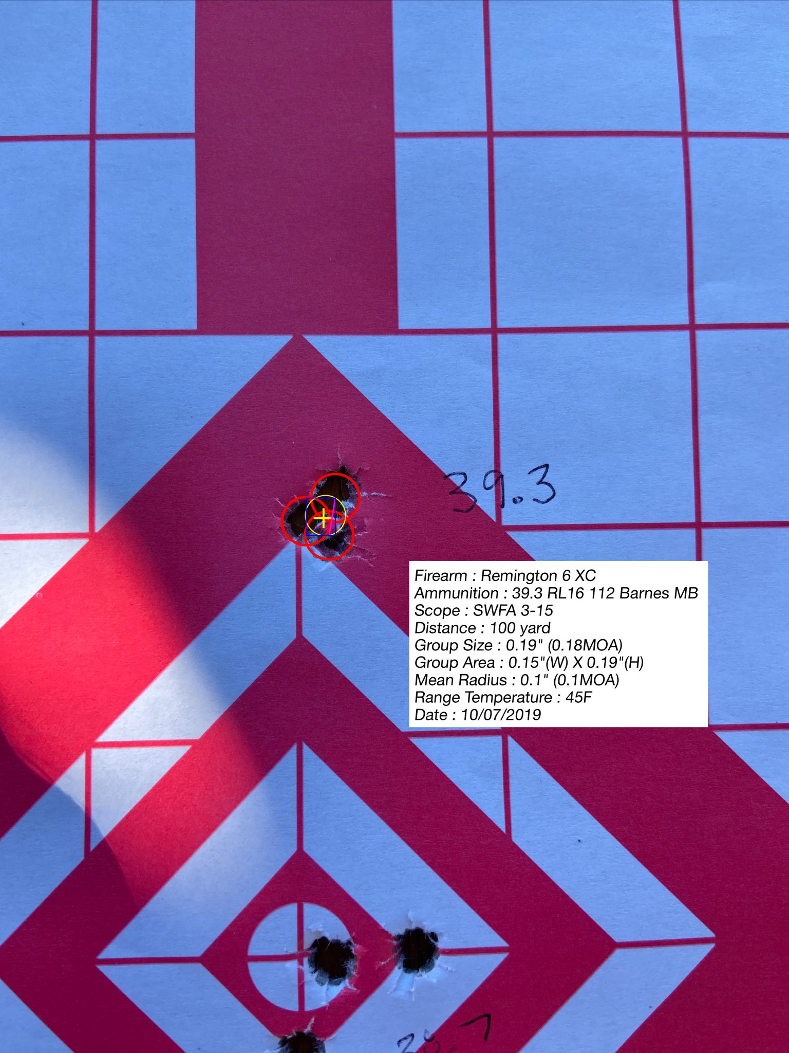

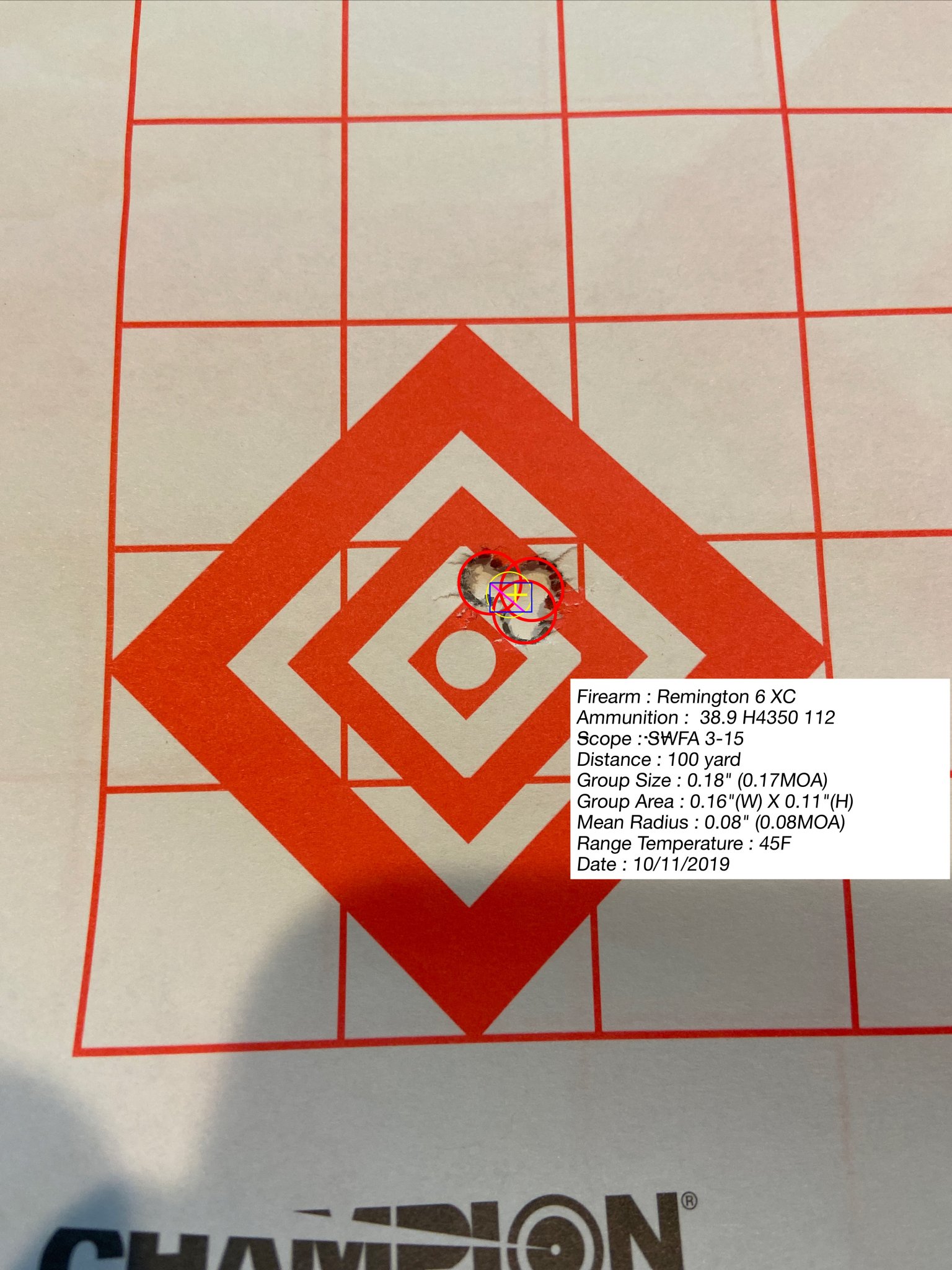

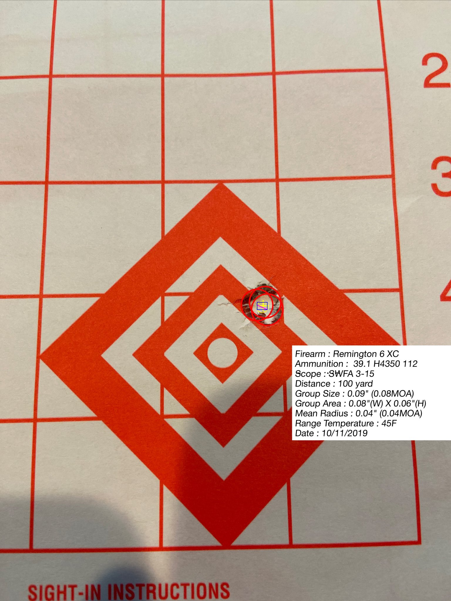

These things are absolutely hammering out of my 6XC with RL-16 and H4350. I’d love to hear some “on game” performance.
@Hiwayman92 - What powder charge and resulting velocity are you getting with H4350? Also curious how much jump you have? Thanks for sharing, man.
I’d have to look at my book, but I believe I’m jumping them about .100. 38.5, 38.9, and 39.1 all shoot .3 or less. I have a magnetospeed so I haven’t been able to test velocity at the same time, but I believe I’m in the 2880 range. 39.3 of Reloder 16 is a little faster, around 2900. This is out if a 22” 4 groove Proof Research barrel.

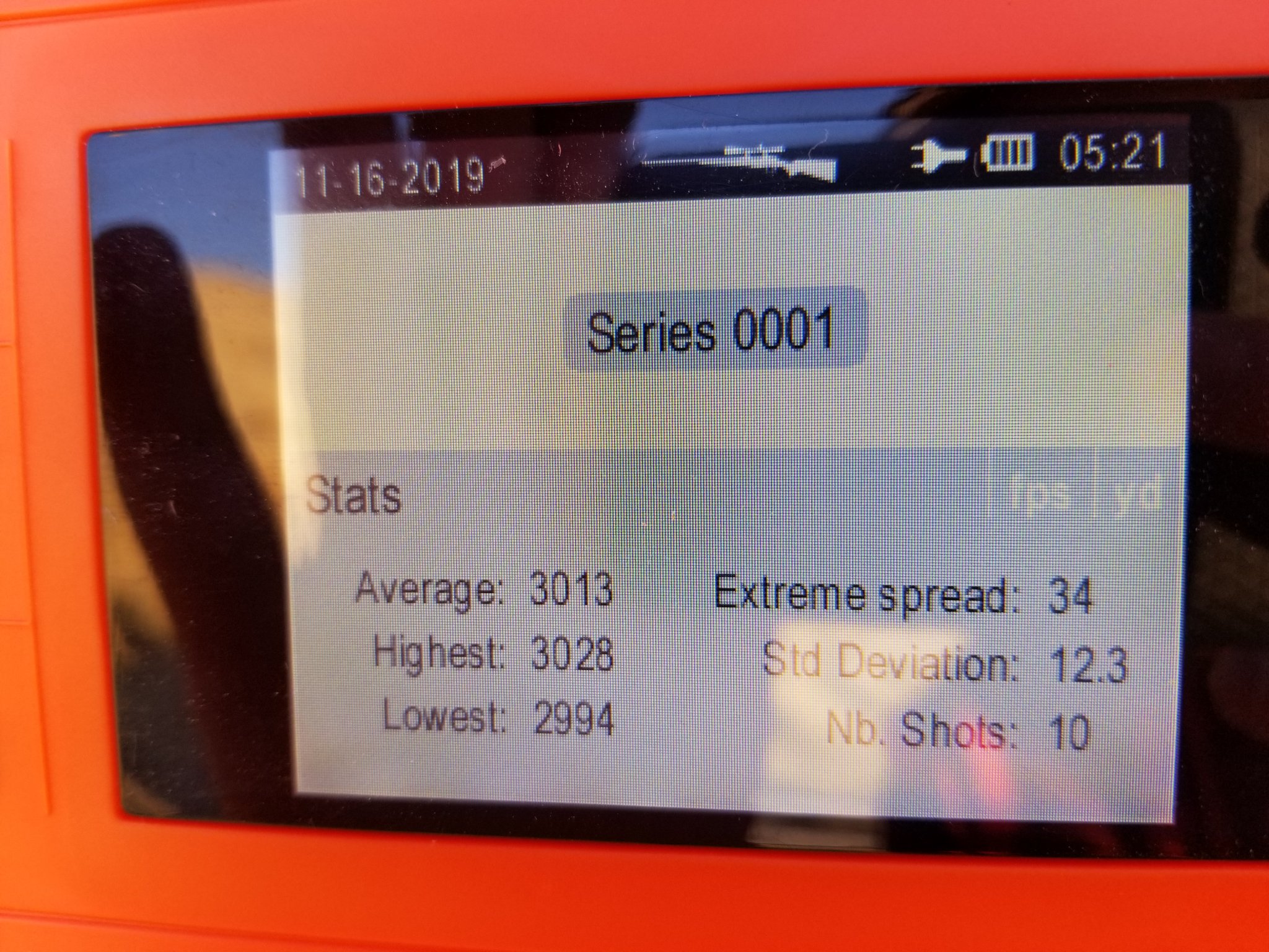

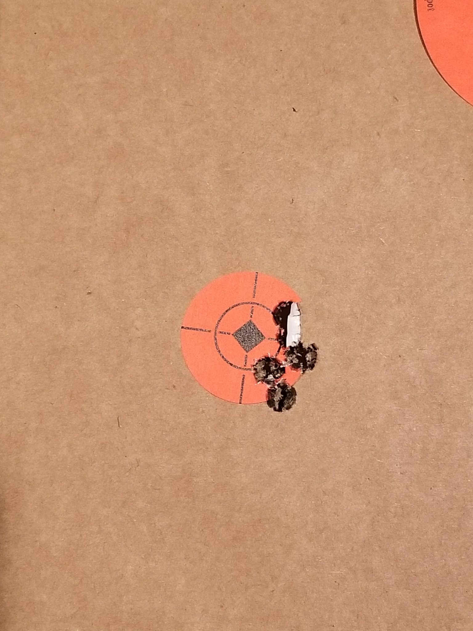

Fresh barrel on my AIAT from Straight Jacket Armory. 24 Inch 6mm creedmoor. Barnes 112 MB. These were loaded fully on a progressive press. (Dillon 650) and I throw powder from a Charge master. After shooting this group and I also exploded a rock the size of a softball at 996 yards with a 4th round impact. These 112's continue to hammer. Especially for the price.
Not a bad SD for 10 rounds off a progressive press.
I had a interesting phenomenon. My gun has 100 rounds down the barrel and all brass is fire formed now. I loaded my best two load recipes (39.3 RL-16) and 39.0 H4350 and shot them both at 250 yards. I had a 1 plus MOA group with 4350, and 1 plus MOA group 5 shot, 1/2 MOA 4 shot group with RL-16. I also noticed light ejector marks, so apparently I’ve gotten a little warm as things are breaking in? I can’t imagine a stability issue at 6k feet with a 1:7.5 twist barrel...
There are a lot of variables here. How far are you jumping them? Also what brass? I am running Starline brass, CCI200 primers and 41g H4350.
They’re jumping about .100, but shot one hole groups with virgin brass. CCI200’s Peterson LRP,
