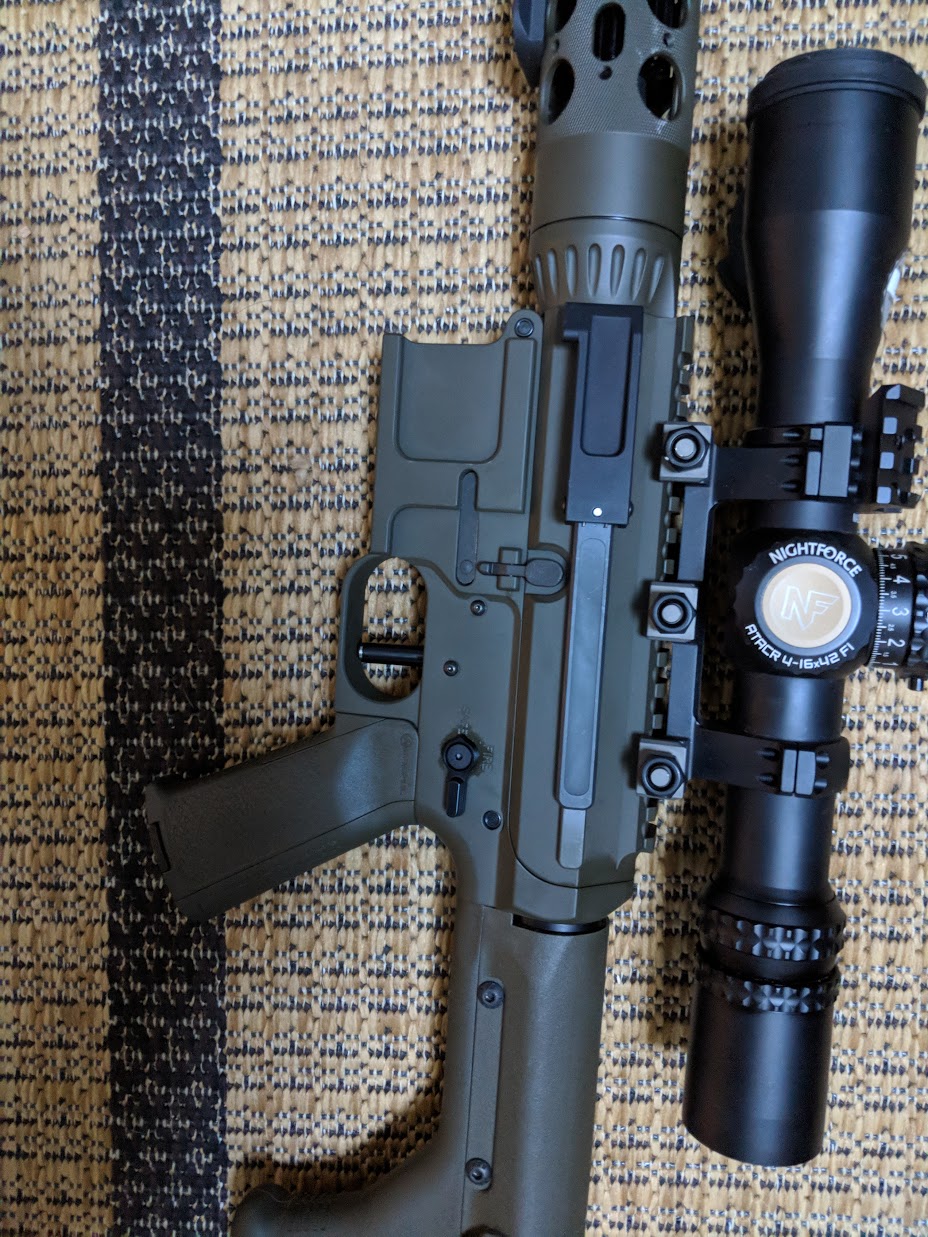

    Was teaching class this past weekend, but got the Call that my Valkyrie Shipped from JP
    Super psyched to shoot this rifle,

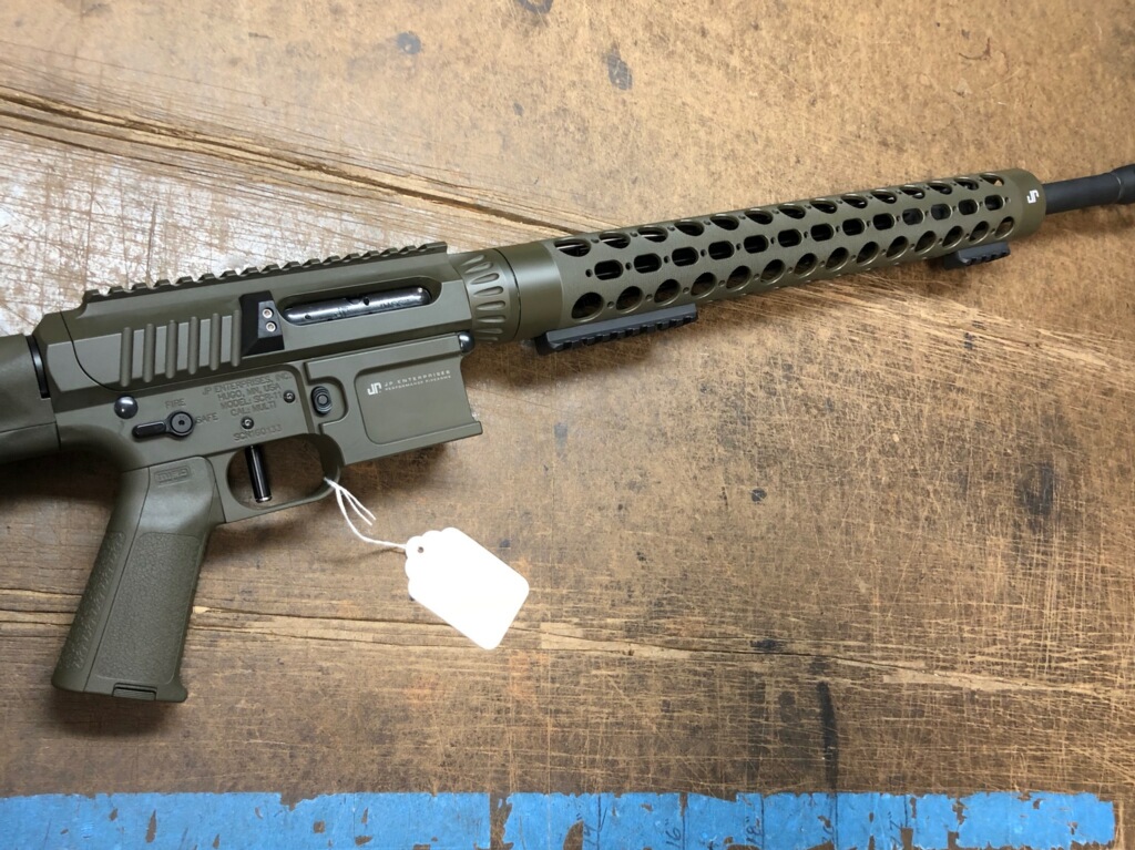

    Excellent!! I'm just a tad jealous since I so far only have a barrel on order and that's not even shipped yet. What trigger is that on that JP build?

    The Trigger is the Tom Fuller designed Roller Trigger JP Uses, I like them, not everyone else does. The trigger shoe rolls to index the finger.
    I had never heard of that trigger. I think that I would have to try it out first to see if it worked for me.

    Am I seeing one of their thermal dissipators under the handguard? Always wondered how well they worked.
    Looks great. With the scope, I have to put the eyepiece forward, flush with the rear of the receiver in order to get a usable eye relief. Curious, how are you getting it done with the scope so far back?
    It's a picture don't look too much into it yet, as I have not shot it.
    Plus I am short, my LOP is short too which is why I am using a Gen 2 and not a Gen 3 stock

    I set the stock length on the magpul PRS such that I get a good cheek placent on the adjustable check piece before mounting the scope. This usually puts the eyepiece an inch or more to the rear of the end of the receiver, but not quite as far as in Frank's pic. My experience has been that eye boxes on high mag scopes are too short to mount as you suggest, and keep my face on the cheek piece...
    The scope I am using now on an AR platform is the Sig Tango 6 3-18x44. This particular one has a pretty far eye relief compared to everything else I have. I actually have to get even a little further back with this one. But in my experience, the right spot for me has always been eyepiece at the aft receiver with pretty much anything.

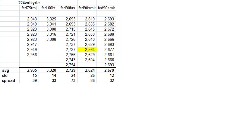

    I have a 24" JP and am getting 2900fps out of the 80 ELDs with reloader 15
    Anybody shooting the American Eagle 75s? Real world velocity? It's 7.99 at a store by me. Insane.
    24", 9.5 twist (edit, that would be 7.5twist...)

    Wow. That SD, with American Eagle.
    Yeah this new lot I have is pretty damn good, the previous lot was about 50-60fps 20fps SD which is still on the good side IMO for factory blasting ammo. Both lots are sub 3/4 minute in my gun too. Only shot it to 500 yards but a few people who have shot it out to 1K+ have been getting a .400-.410 G1 BC.
