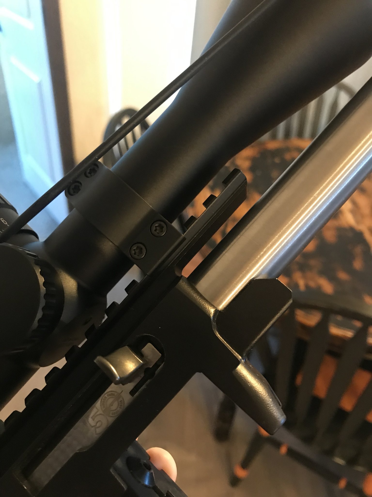

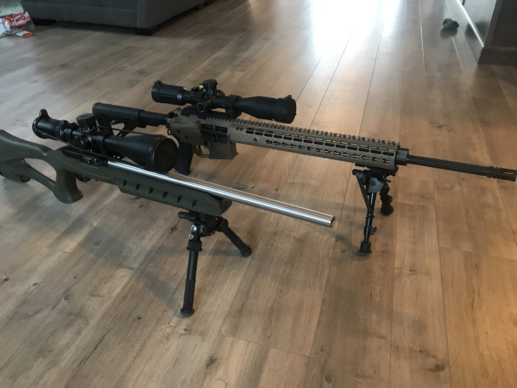

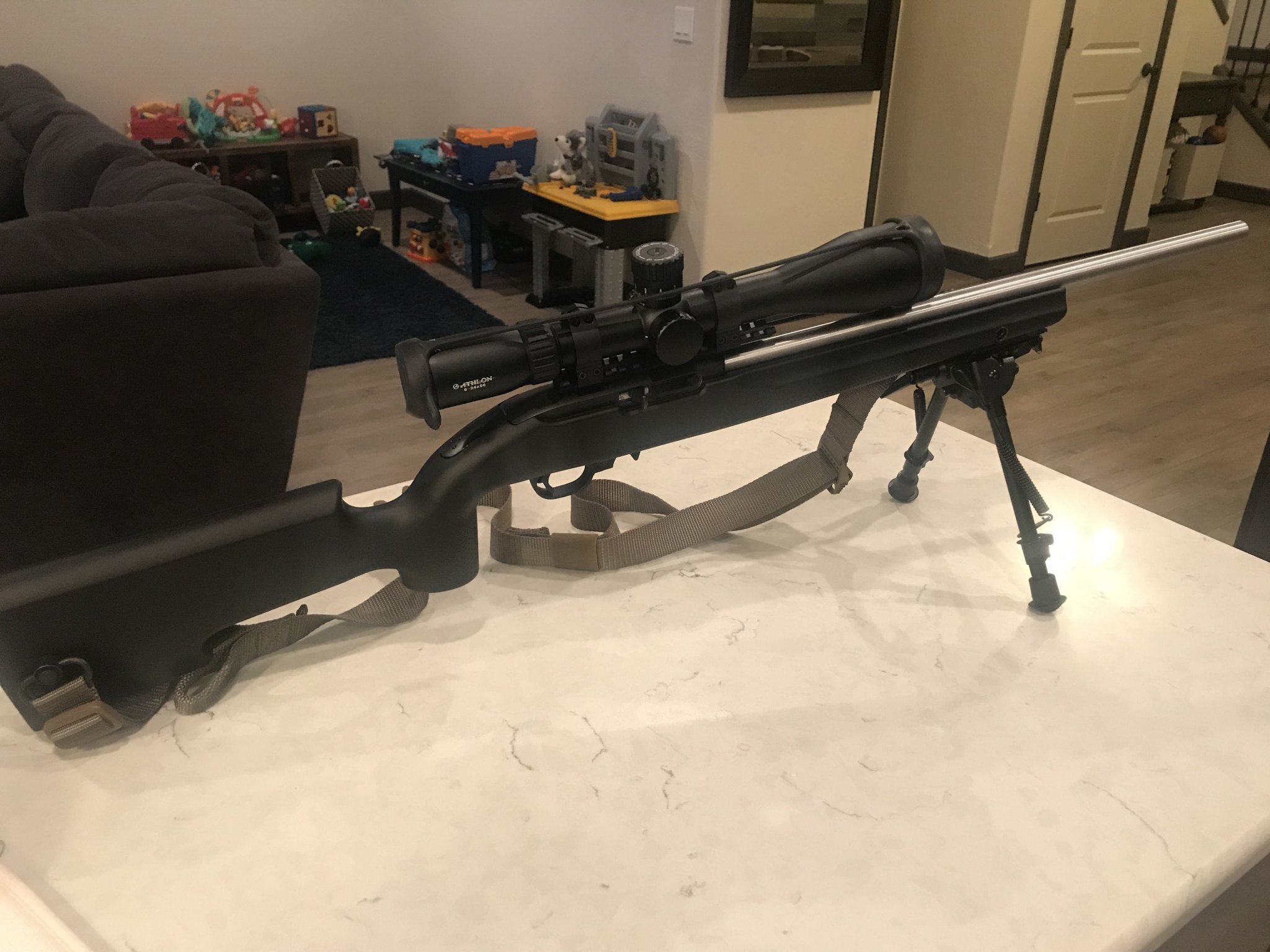

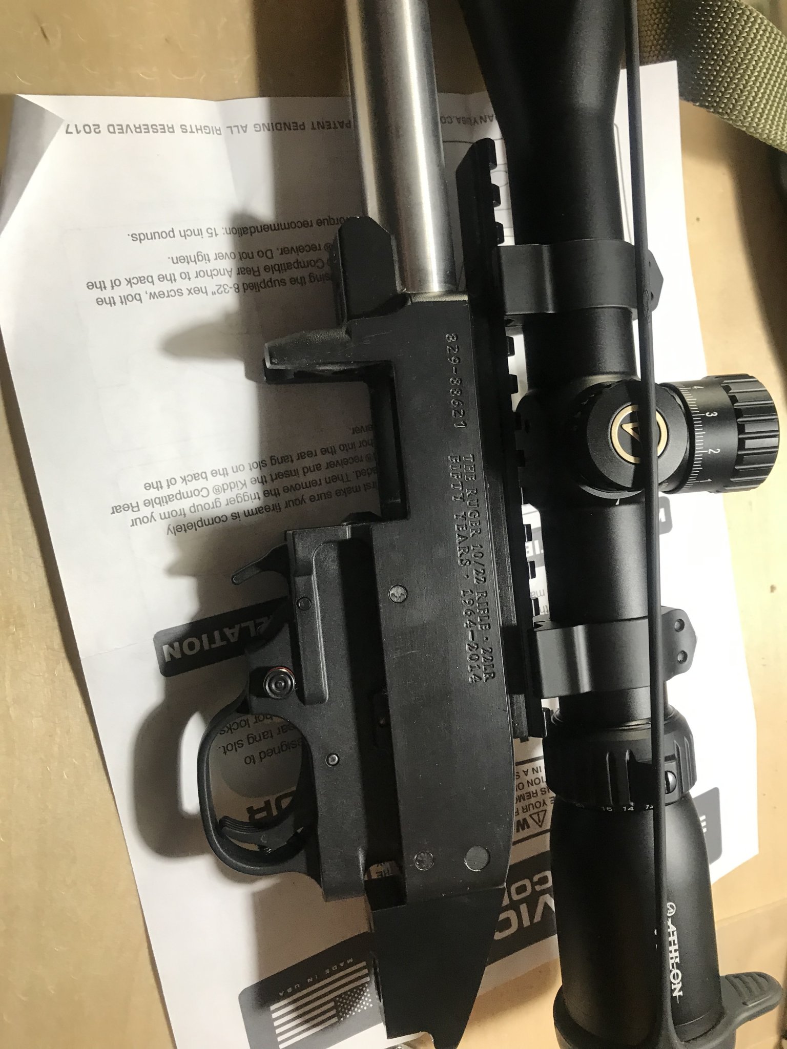

What I found out quickly is if you don't have your 10/22 in a decent stock you're wasting your time and ammo. I originally had this BA in a archangel deluxe stock which was stiff but still had up and down movement of the receiver. Since I put it in a Titan with a rear tang it is a night and day difference! I mounted a Athlon Midas Tac 6-24 on top. The only thing I didn't realize is how short the comb is on the Titan so I think I'll have a better check weld once I get their cheek riser system.
Btw this BA came with a cleaning port and the cutout for a Kidd rear tang.

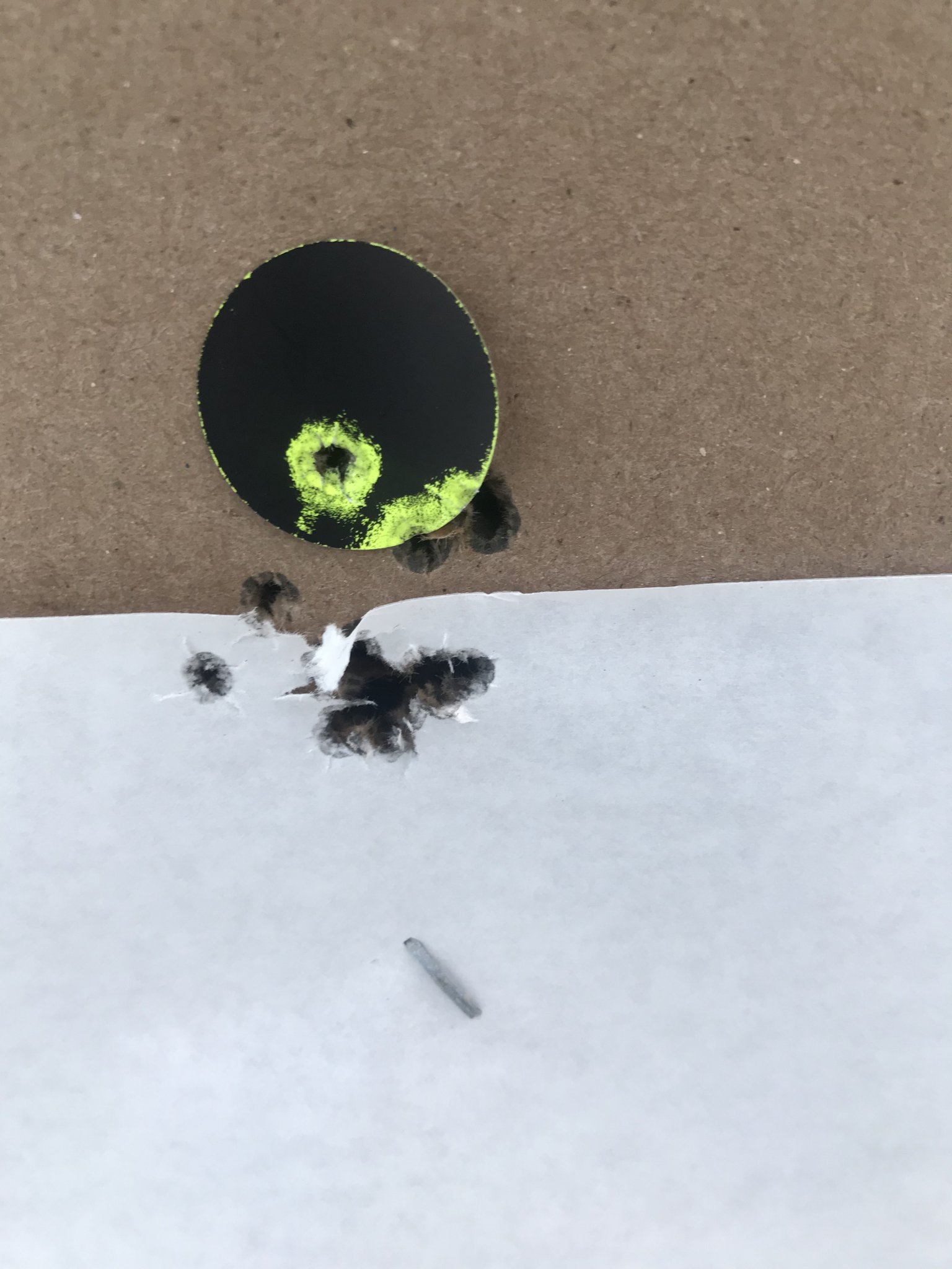

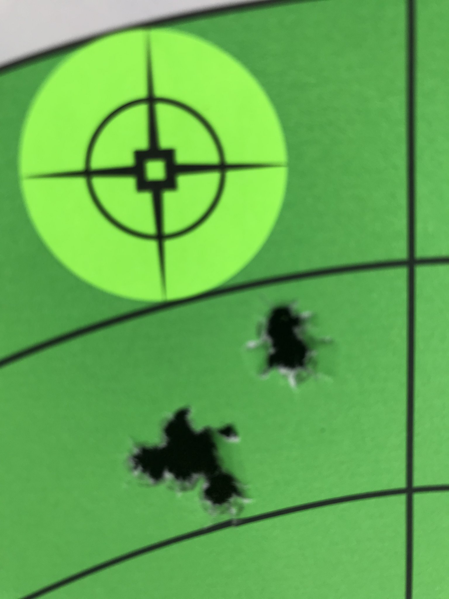

Here is the rig with the titan stock and a few groups.. the shoot and see is at 50 and my best group at 100

Did CPC modify the receiver to accept Titan rear tang? When I was looking over the CPC 10/22 services a few months back I must have missed it.
I've read some very good things about CPCs work before. From what others have said Randy takes a base 10/22 and make it a whole other class of rifle.
Yes.. Mine has a rear tang and cleaning port

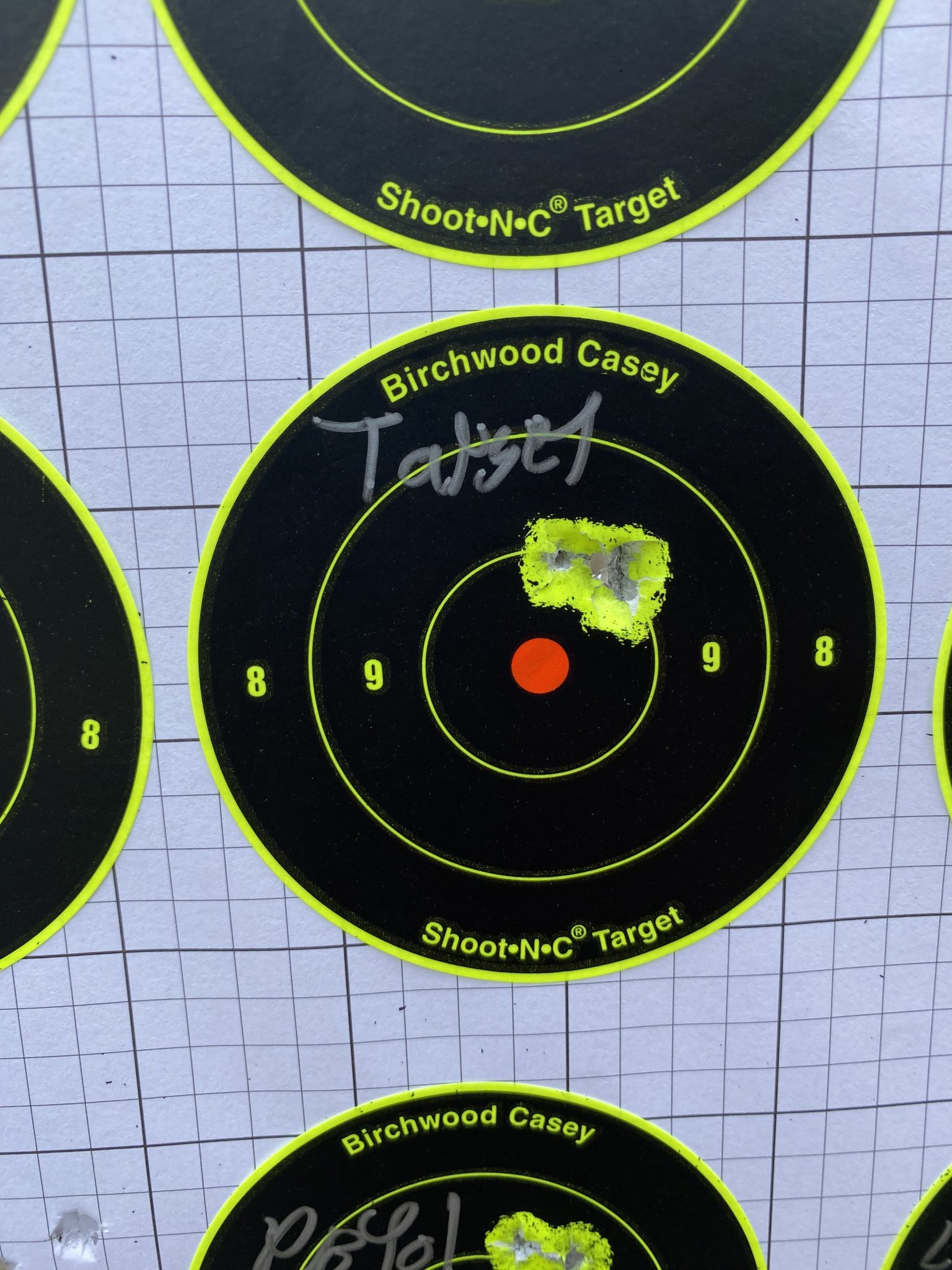

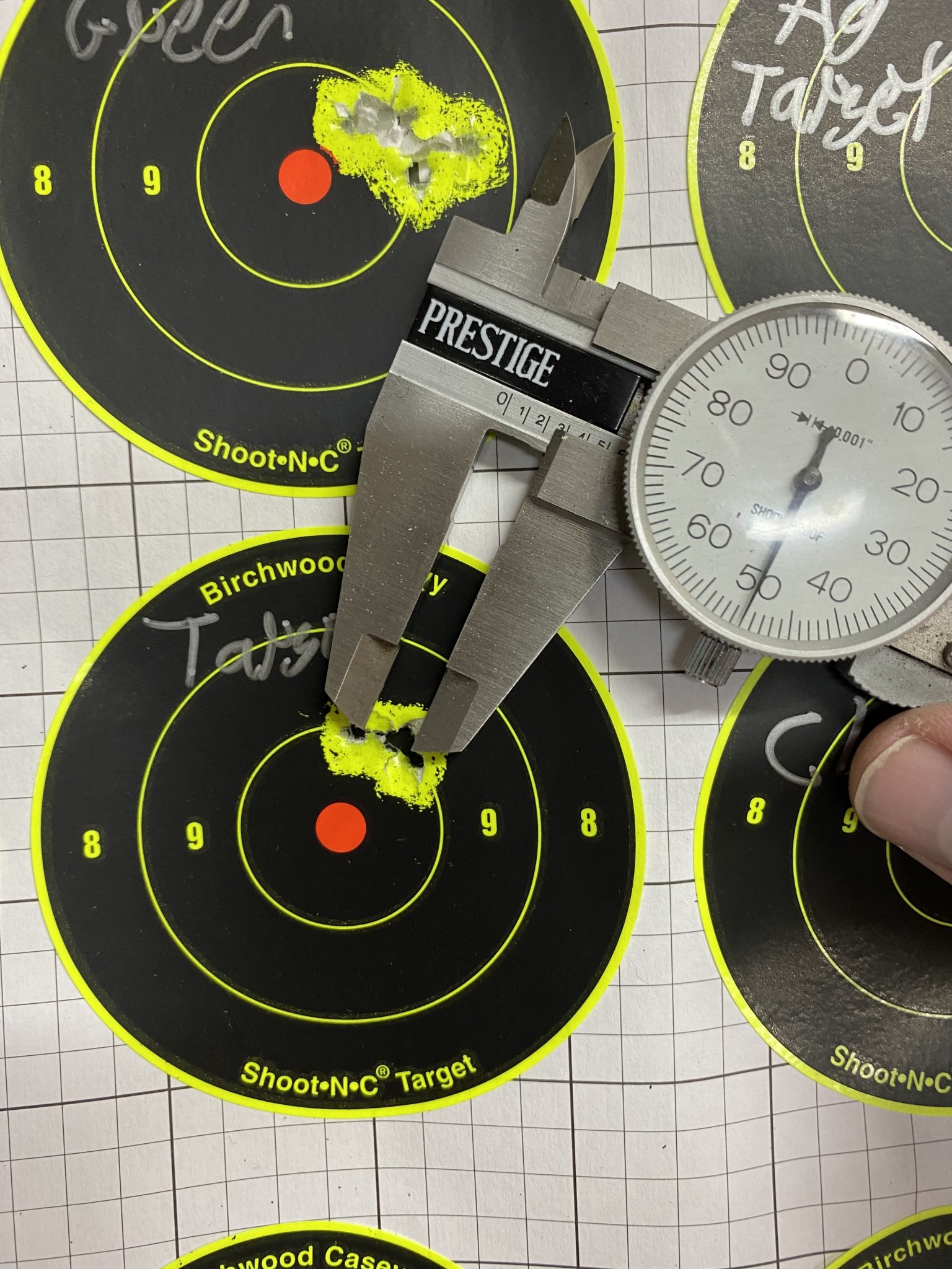

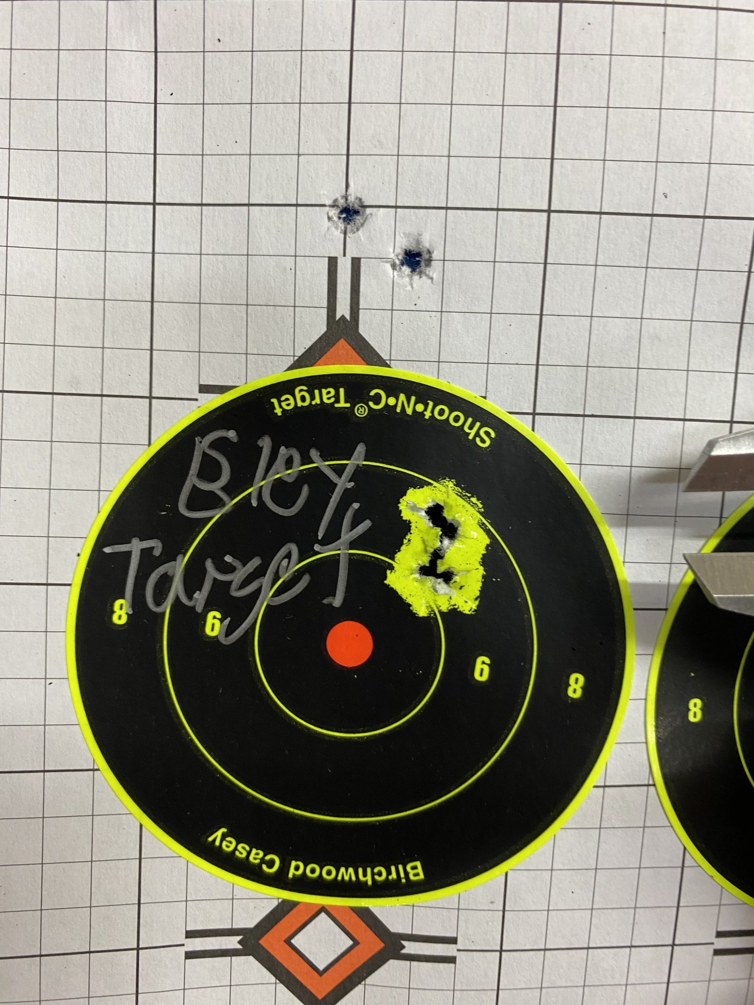

Here is my all factory CPC tuned rifle with a Victor Titan stock. I just used the Victor recommended action torque and shot groups, the gun has maybe 300-400 rounds through it, so it could get a bit better yet. Groups are at 50yrds 5shots 3-9x scope off a sand bag. Best deal in the gun world and it’s more reliable now he had it back to my porch in less than a month too. Eley Target and Force are the best I’ve tried $6.50 a box too. CCI standard shoots almost as good with throwing the occasional flyer but even 10-shot groups are about 1/2” at 50yrds. With these red I have not bothered to get any of the pricey stuff. Cheers
