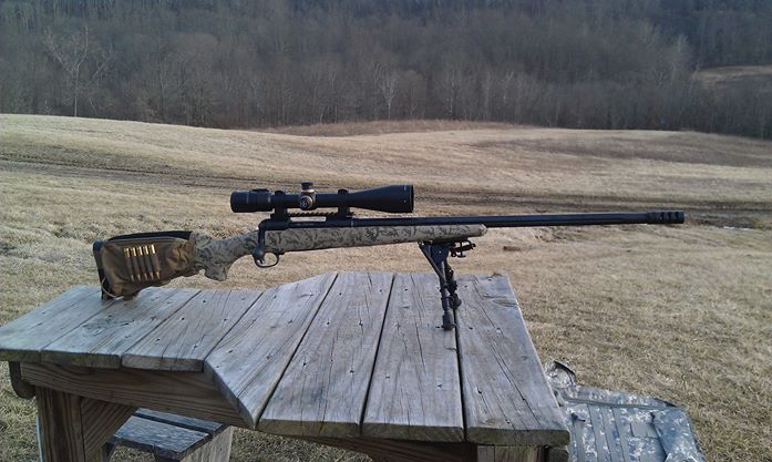

This is my first post here on the Snipershide forum and I just want to share my recent long range rifle build. So, late in 2013 I decided it was time to part ways with my Remington 700 SPS Tactical in 223 and move up to a larger caliber, and better equipment. I have always been a fan of Savage rifles ever since I bought one several years ago chambered in 17HMR which happened to be my first bolt action rifle, and is what introduced me to the world of precision shooting.
While waiting for the sale of the R700 to come through, I was doing lots of browsing and research on the internet to find out what kind of rifle I can get the best bang for my buck with, while having good quality and accuracy. The R700 sold and after a couple weeks of searching I decided to go with a Savage 10fcp-k in 308 Win. I purchased it just before the end of 2013 before the prices on them went up so I was very happy! Right out of the box I was pleased with the quality of the rifle and it's components and was eager to start purchasing things to get it out to the range when it warmed up.

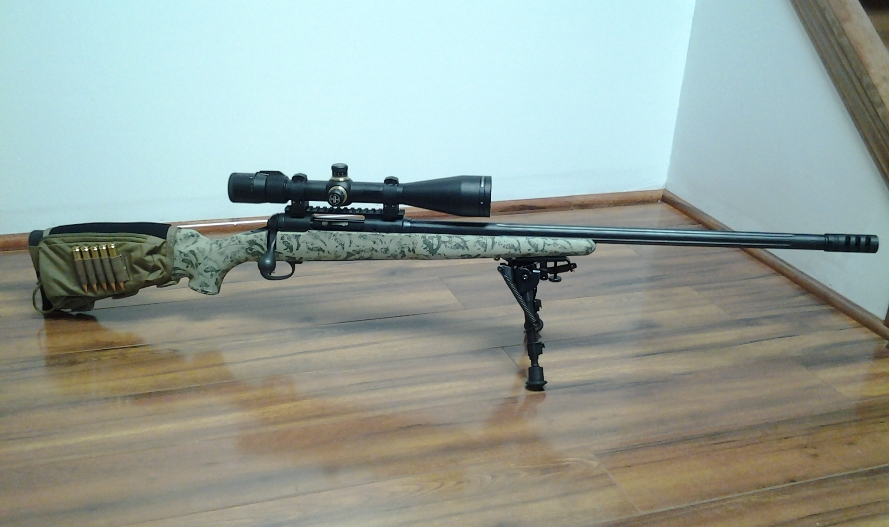

Piece by piece I ordered several things and by March it was all together and I was ready to get it to the range. Here is a list of everything I have done to the rifle so far, any and all feedback on the rifle and parts I chose is welcome and I honestly would love to hear what you all think.
Savage 10fcp-k 308 Win.
Accutrigger set to 2 pounds
EGW 20 moa HD base
Vortex Viper 30mm medium height rings
Vortex Viper 6.5-20x50mm mil dot scope
Harris HBRMS 6-9" bipod
Triad Tactical stock pouch

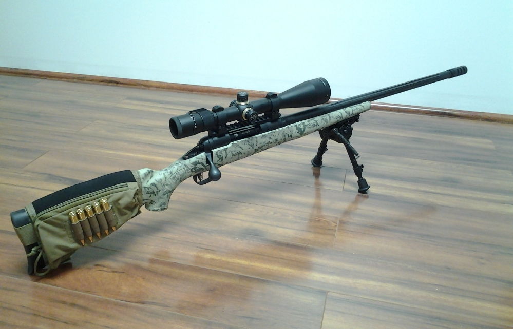

Accustock was taken off to sand down the barrel channel to ensure barrel was free floated. I took the butt pad off and removed the foam on the hollowed out inside of the stock and added nearly a pound of plumbers putty into it to balance out the rifle as it was pretty front heavy. I also did a rattle can paint job on it with Rustoleum Camo.
The next items I will throw on it will be a Wheeler anti cant bubble level, and a bolt handle from Glades Armory. Eventually I will save up to upgrade the stock and get a reloading setup, but for now I am happy with it and just want to get used to it and improve my skills.
So far I have been on two outings with this rig and I couldn't be more pleased with it. The only ammo I have fired from it has been some PMC 147 grain fmj-bt and even with that it has performed very well I think. As soon as I got to the range I setup a sight in target at 100 yards and after about 15 rounds I got a solid zero on it and then lifted the turret on the scope up and indexed it back to the 0 mark. I then fired another 9 rounds in 3 shot groups on the target to ensure my zero is where I wanted it to be and also get an idea of just how accurate it was.
For only using some PMC 147 grain fmj ammo I was very pleased with the type of groupings I got out of the rifle while it wasn't even "broken in" yet. The 3 groups I shot using 3 rounds for the group were between 1" for the smallest one and the largest group opened up to about 1.5". These shots were off a bench using the bipod and my hand for rear support.
After this I headed down to the long range area where I was excited to see how well it could blast some steel targets at 400 yards. I am not sure on the size of the targets I was shooting at as they are provided by the range, but I would have to guess it was about 12" wide and 18" long. The wind was fairly calm this day with maybe a 5-10 mph wind at full value at times. I looked at my ballistic chart I made from the Hornady Website and dialed up 7 moa on the turret and took my first shot in the prone position with no rear bag only suported by my hand. First shot was a miss and looked to be a tad high, I took aim again at the center of the target and fired... again a miss :confused:. I then went down to 6.4 MOA and also held towards the bottom of the target to see where it would hit, fired my 3rd shot and a second later.... DING :D. my face lit up with a big smile and from that point on I fired about 30 more rounds at the same target only missing maybe 2 times.
I ended my day putting some rounds through the AK, and then went home very happy and eager to take the new long range rifle out to a further distance next time I came to this range. The range I shot at was Rayners Range in Ohio which goes out to 1000 yards. It was my first time at this range and certainly not my last. It is about 30 minutes of a longer drive than the range I usually go to, but very worth it on the days I want to shoot further distance as my regular range only has a 300 yard rifle range at this time.
Anyhow, this story ended up being a bit longer than I expected and maybe I got a little carried away rambling on. Hope you enjoy reading as this is my first post, and I am looking forward to hearing what you all think!
