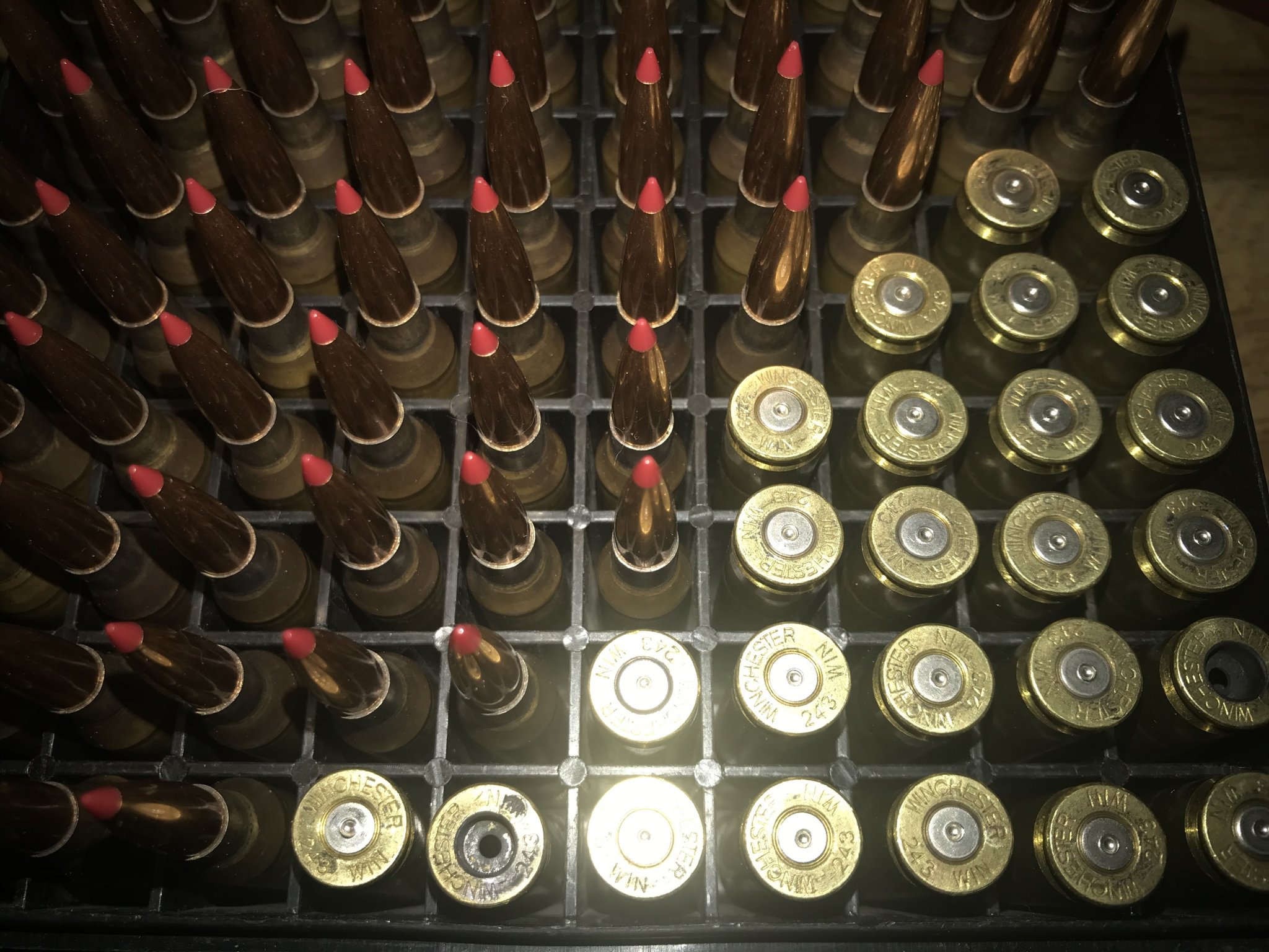

    Had a few primers fall out on firing today.
    This is with an absolutely sane load.
    They were kinda sketchy loose on loading.
    I’ll have to check my notes but it was on it’s 39th firing and that lot killed two barrels already.
    Got my moneys worth!
    I should probably check my bolt face but is back on the savage,,,my red headed stepchild rifle.
    Yep,,,39th firing.
    At about 25th firings I to cut the primer pocket depth back to spec as brass flow had made the primers flush or a bit proud.
    About 5 of the loadings were low node 140 loads at 2710.
    15 loads of 140 hybrids and eldm’s at 2810 with H4350 and rest with 147’s at 2805 with IMR4451 and R16.
    Ignore the cratered primers, it’s a savage and cratering it’s its signature trademark.
    Extractor is trashed on that rifle and I need to deal with it eventually.
    All three barrels headspaced less than two thousandths from a go gauge.

    Not bad at all.

    All three barrels liked those loads.
    I could go faster but I’d get issues when it got hot outside.
    Those loadings were 100% stable.
    a bit of water on them wouldn’t be a big issue.
