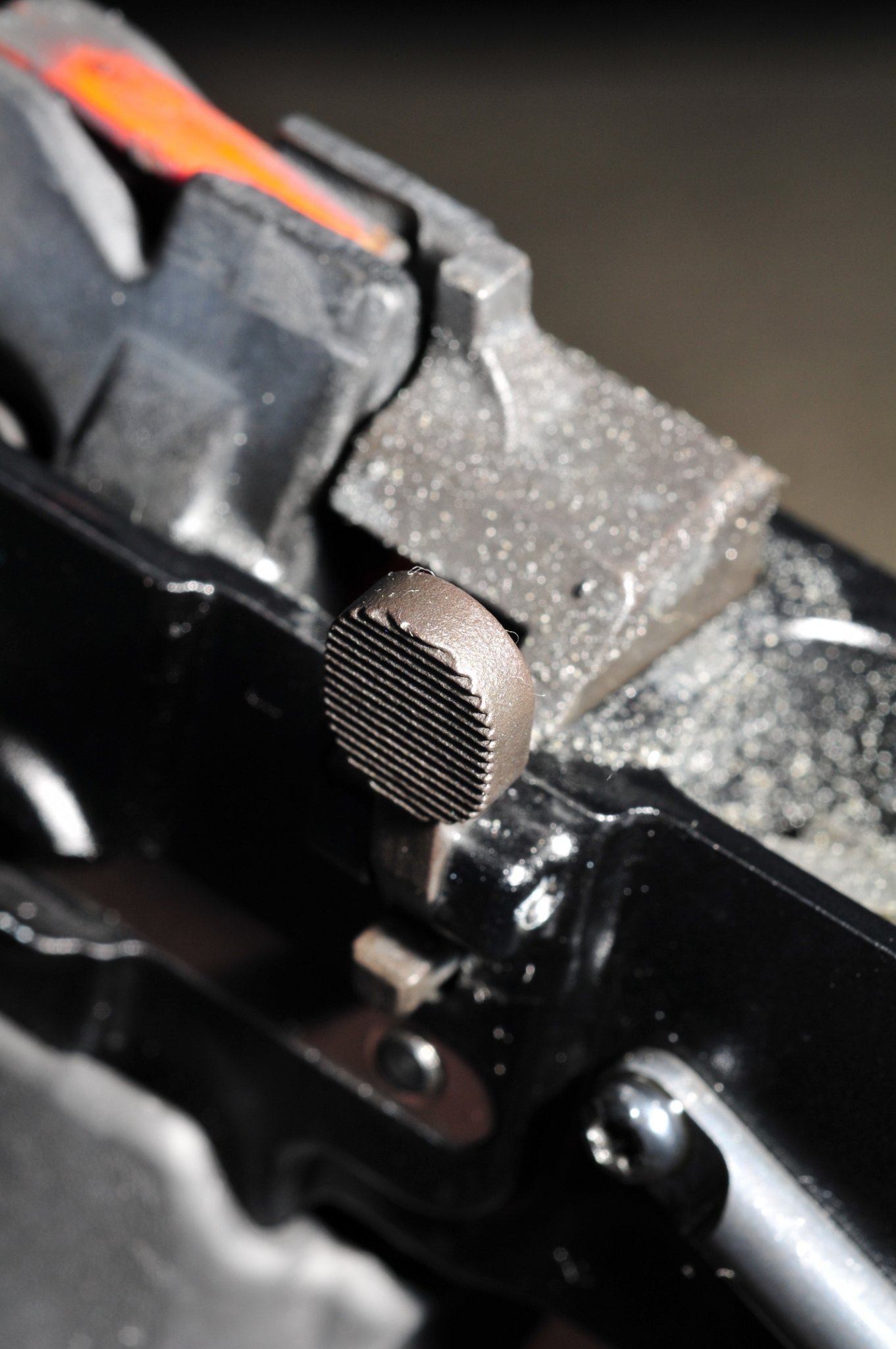

That's pretty much what Kriss went with in their .22 AR (probably the same part with slight dimensional differences):
(Yeah, it's dirty.)
It does work (and better with S&W mags than with the Kriss mag). I'd get a couple of those and some of their MP15-22 magazine shims, some S&W mags, and be done with it.
