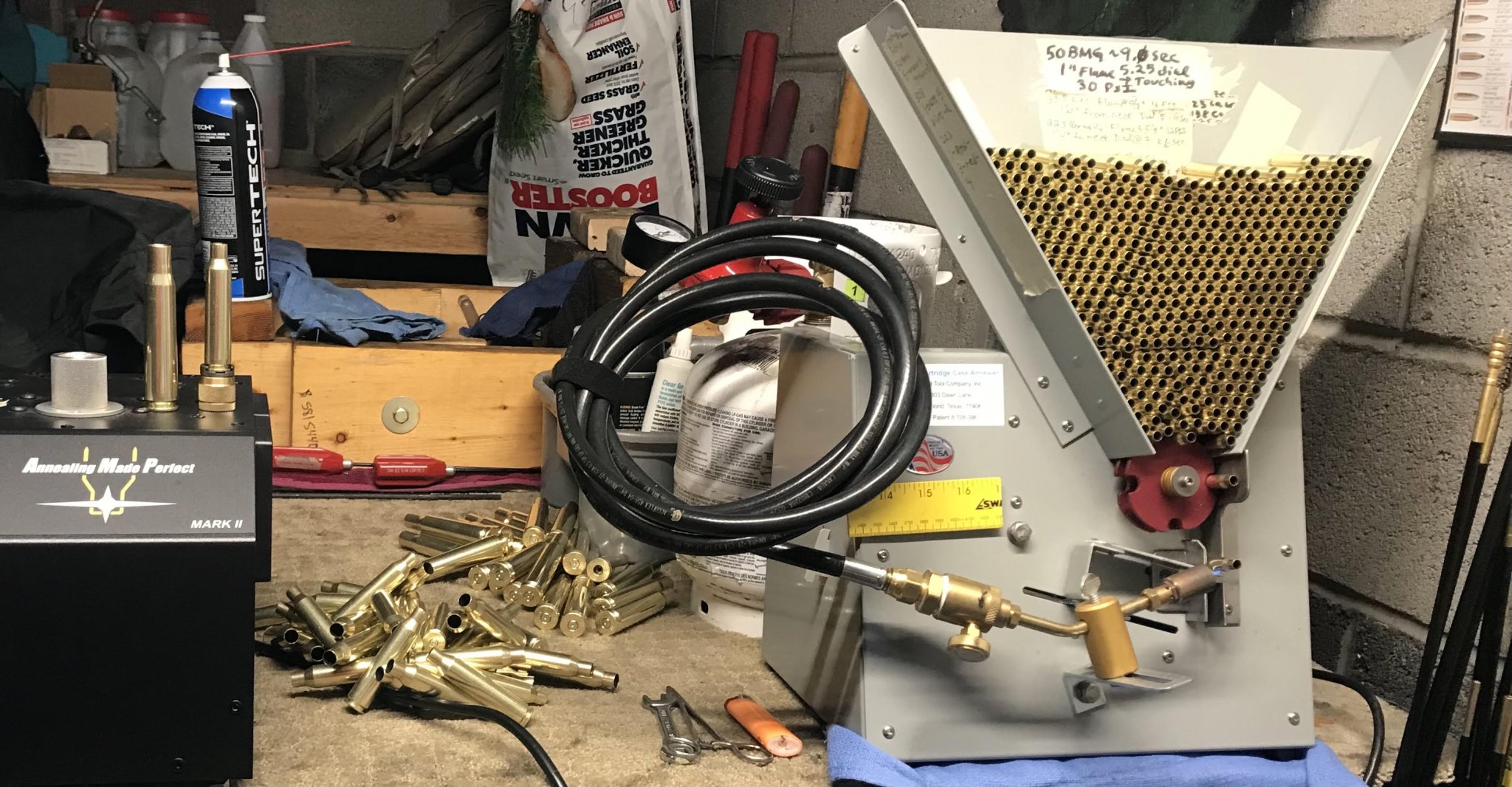

    The Giraud annealer pictured above may be just the ticket for you. It's less than 1/2 the price of the AMP, and you can set 200-300 6.5 cases on the hopper turn your back for another task and let it do it's thing. Despite what the net experts say, there is nothing wrong with good 'ol fashioned flame, and while it may not be as good as AMP, it's better than nothing and way faster!

    Annealing is probably the part I dislike the most.
    Light up a cigar
    Put on some music
    Get er done.
    you may have seen this already but this Elfster style machine cost me around $100 Cad to build, quick, easy cheap.
    Reactions: Hkmiller

    This is how i anneal brass. Been doing this way since 2008. Every loading
    I enjoy reloading, not as much as shooting but I do enjoy it
    When I anneal that's how I did it. Sometimes in the dark to see the case light up and stop. But cheap easy way to do it. But I need a new torch head so haven't done it in awhile I guess that reminds me to buy one haha
    I don’t need to do it in the dark. I turn the brass with my fingers holding the head. Soon as I feel the temp change at the head it’s done. You’ll burn yourself and drop the brass before you can over do it.
    Yeah I hold it bare hand it gets very hot and that is my timer it's done. I just did it in the dark a few times to watch the color change.
    Reactions: jasent
    You should watch the video orkan did years ago on annealing.
