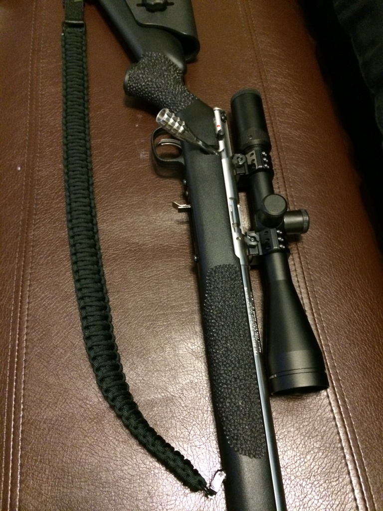

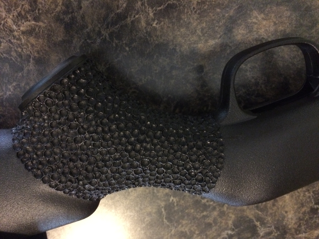

Looks great! Here's what I did to my tupperware savage stock using a wood burner instead of going Marine-Tex texture. Added the Karsten Cheek Rest to fix the bad angle of the factory cheek rest. Picked up one of the blems cheap and was surprised couldn't even tell.
