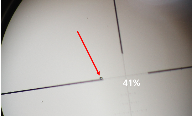

Yes, I believe my Schmidt & Bender needs to go in for repairs. The scope is a 5 -25 PM II, (two years old), it sits on my Accuracy International At rifle in 6.5 CM. I noticed this issue with a fish eye type spot on the inside on the glass (see picture). For those of you that have dealt with repair in the past. My big question is, how long is the wait? and is it a big hassle in dealing with their customer service? The rifle and scope have been sitting in my safe for about 2 months. What do you think it is?

S&B had a batch of 5-25's (about 2-3 years ago) that had an issue with the batch of grease. I had one too. I lived right around the corner from the service center so I dropped it off and picked it up a few days later. Call and talk to Jerry, he'll get you squared away and the scope will come back better than new.
the same think with internal grease I saw at friends March FFP 5-40x56 scope. He thought about lens damage (crack), but it was inside tube and in the inner area of FOV. He left the scope this way, because sending it to Japan from Europe after warranty would be expensive.

With regard to March, this would be a manufacturers defect which they cover for life, I would have your friend inquire with March in Japan as they are making an effort to ensure quick turnaround time especially for overseas customers.

My PMII has the similar issue in 2018: there was a spot in the image (it is possibly just an oil drop spill on the lens). I called Schmidt Bender USA and sent it back for service. It came back surprisingly fast, within 2 weeks if I recall correctly, the problem was fixed and the whole process was completely free. I'd say Schmidt's customer service is a A+ for me.
I had a Canon camera that did exactly that, it was the same thing, grease dot from manufacturing
I had one 3 years ago with a few spots.
Sent it in, they paid shipping both ways, even did some "repairs" that the tech thought it needed (he thought the parallax knob was too stiff) and had it back to me the following week.
Didnt cost me a dime short of dropping it off at UPS.

Drove up to Winchester to drop mine off with Jerry here a while back for the same exact issue. I talked with him about it for a while and they have a newer, less temperature sensitive grease to replace the one that spatters. He said something about the price of the new grease being a few hundred Euros per ounce or something, and my eyes glazed over.
They'll tear the whole thing down, clean out all of the old grease and replace it with the new stuff, along with a fresh purge and cal of course.
You'll be fine sending it in - as has been said 1000 times, Jerry is top notch.

I vote grease spot.
My Premier has them on occasion.
It shouldn't be there and if it drives you batshit send it in, they will clean it.
If you can live with it or need your scope in the moment just carry on.
