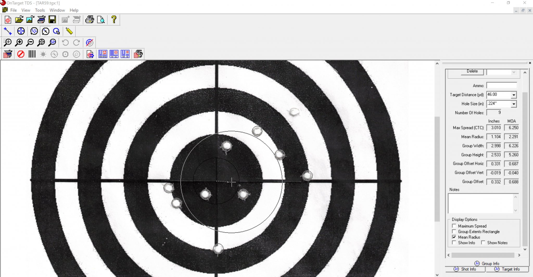

In one sense you are dead right. Any rational discussion has to start with an accuracy or precision goal. Then do what Bryan Litz calls a WEZ analysis, WEZ the acronym for Weapon Employment Zone. Terrible name. Should be Precision Factor Analysis or Accuracy Factor Analysis depending on whether precision or accuracy is your game. The idea is the determine the importance of each of the factors. Then only have to be concerned with those factors that are significant at level of accuracy or precision you want. Which is exactly why my game is shooting standing offhand. All the shit that degrades accuracy is immaterial in comparison to the degradation from my marksmanship. I can go to the range under calm conditions not worrying about the ammo, wind, nada but breathing, aiming, trigger pull and follow through. And hoping I do not have too many damn outliers.
On the other hand, if you game is to understand the causes of dispersion, you cannot overthink the situation. Understanding interior and exterior ballistics is not high school physics and chemistry. Done right you are doing ballistics research which requires both careful experimentation and analysis using very non-trivial math. If you do not do it right, the kind words would be numerical speculation and the unkind firearms blather.
A nice example of the effort is contained in link http://www.arcanamavens.com/LBSFiles/Shooting/Downloads/EnglemanChronographStatistics.pdf
although what he considers complicated equations are actually trivial.
A final thought. The more you record at the range and the more you anal-yze the the data the closer to ballistics research and the farther from "shooting". Certainly not for everybody. However, if you are going to measure a lot of variables at the range consider analyzing the targets with the software On-Target TDS. www.ontargetshooting.com. Dirt cheep in scheme of things. If nothing else you can print many different types of targets from the software.
Attached shows target and information derived. Scanning and locating the bullet holes takes a couple of minutes. You may be able to locate the bullet holes more accurately than otherwise. Since I am very causal about sighting-in, just bench-bag-shoulder, I monitor the group offset from the aimpoint to determine if need to make any adjustments. Separating the dispersion into horizontal and vertical components is the real meat for comparing observation and theoretical prediction.
One aspect I have never tried is automatic aimpoint and hole recognition for targets with single shots per aimpoint. Have to use a On-Target target, but after recognition program does the statistics for all of the shots. How good is that?
I did not include one shot in the analysis because consider it a flyer, offset > 4.0" from AP, a unfortunate lapse in one or more aspects of my standing, offhand marksmanship.
