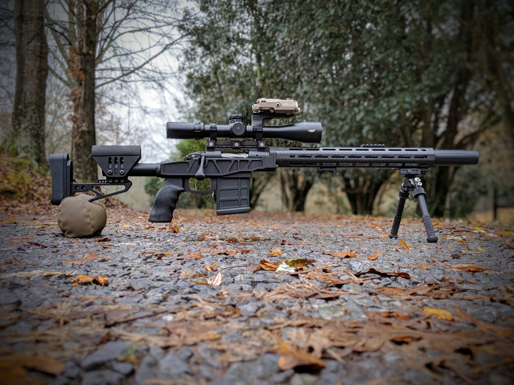

    Going to try it out on some night time hog hunting next weekend.

    I think I want one of those for the same reason.
    Care to share some build specs?

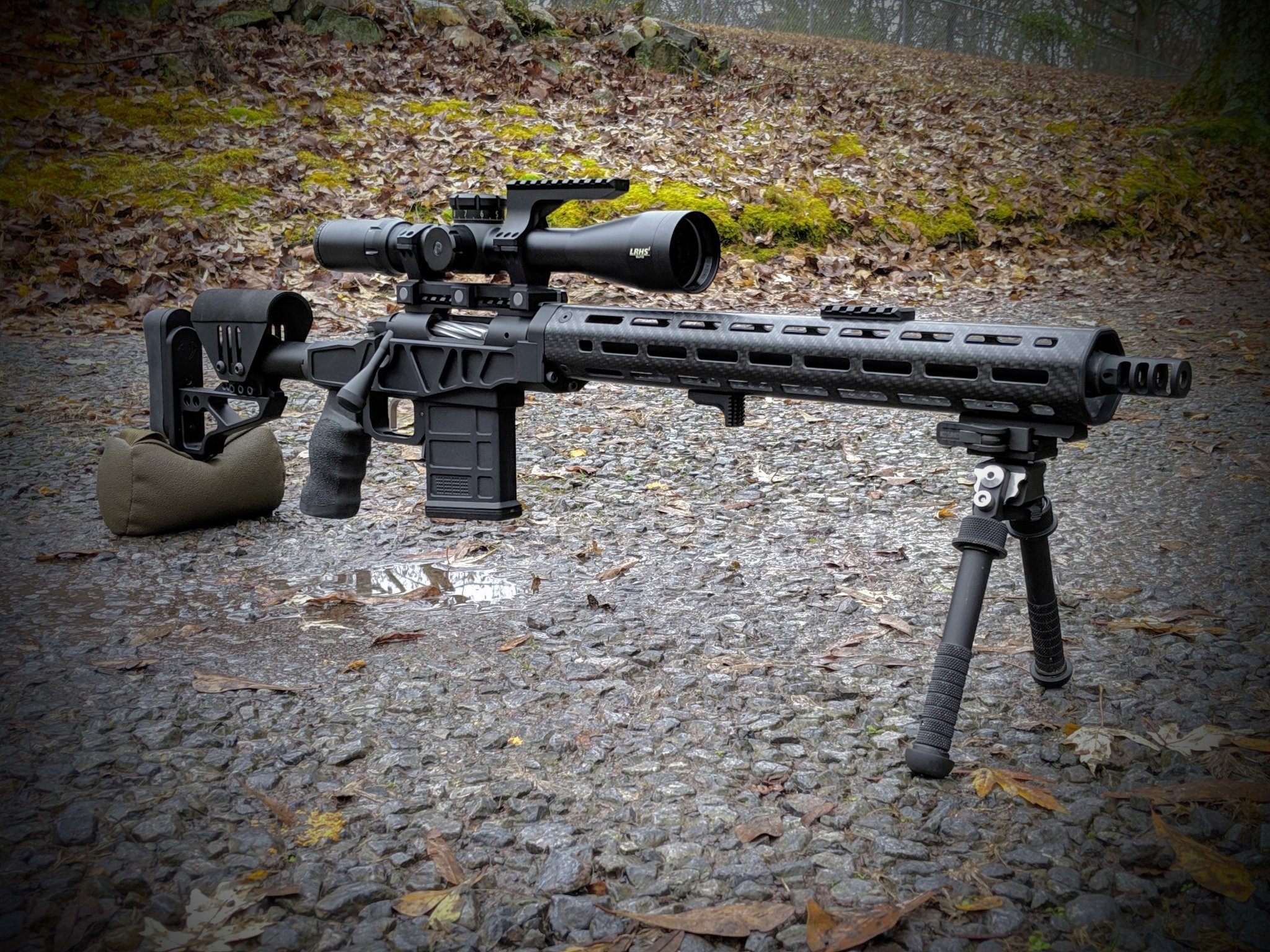

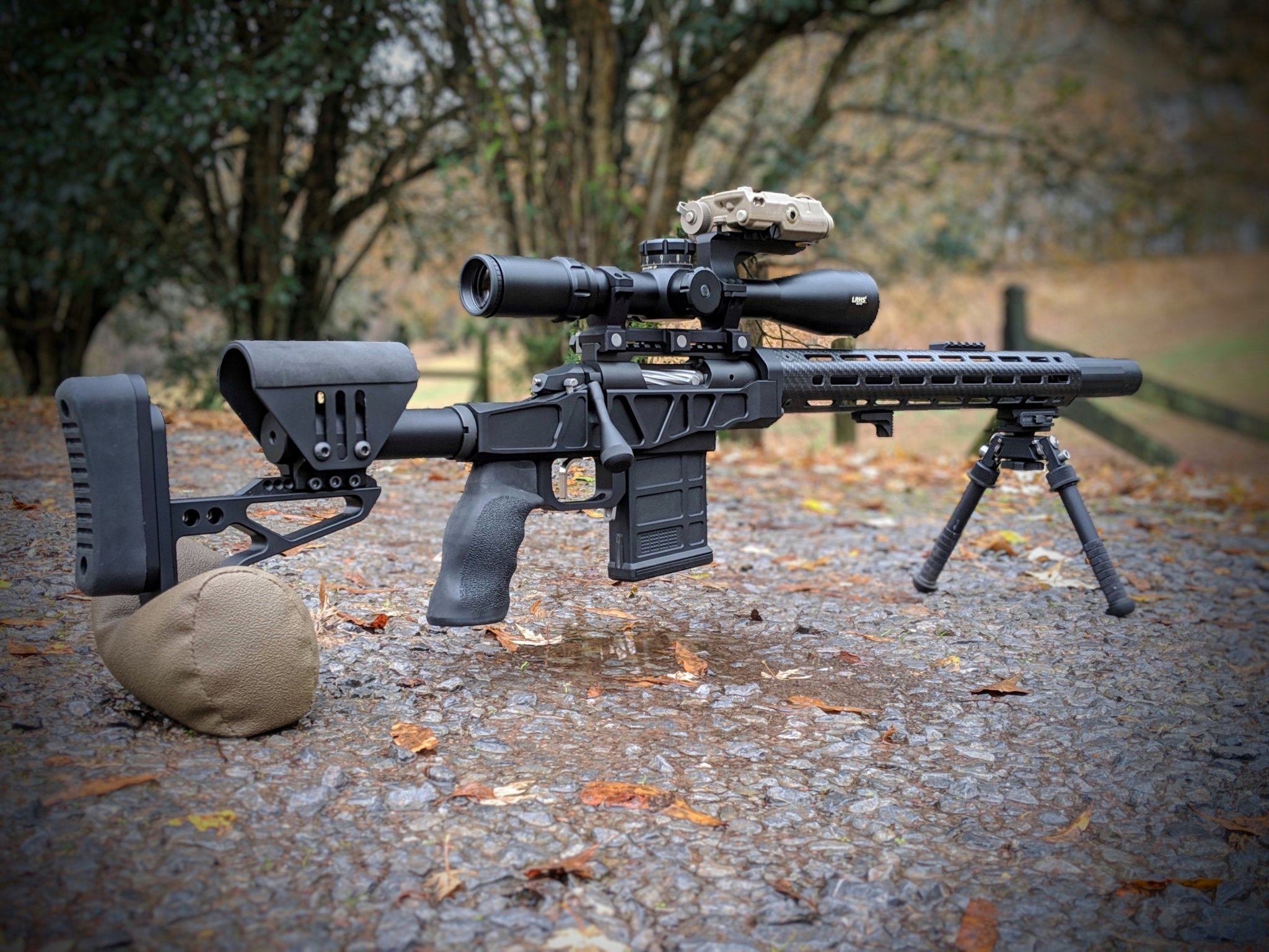

    Bergara Premier Barreled action w/ Triggertech trigger (pulled from HMR Pro)
    16-ish inch barrel 6.5 CM
    XLR Carbon Chassis
    Nightforce Magmount with RAP
    Dead Air Sandman K Suppressor
    Bushnell Elite 4.5-18 LRHS
    Atlas Bipod
    Reactions: niteshooter

    11 lb 2 ounces as it sits in the picture with no bipod, or laser. Which means the removal of handstop, the laser mount and the removal of the small NV pic rail piece should get you at about 10.5 lbs.

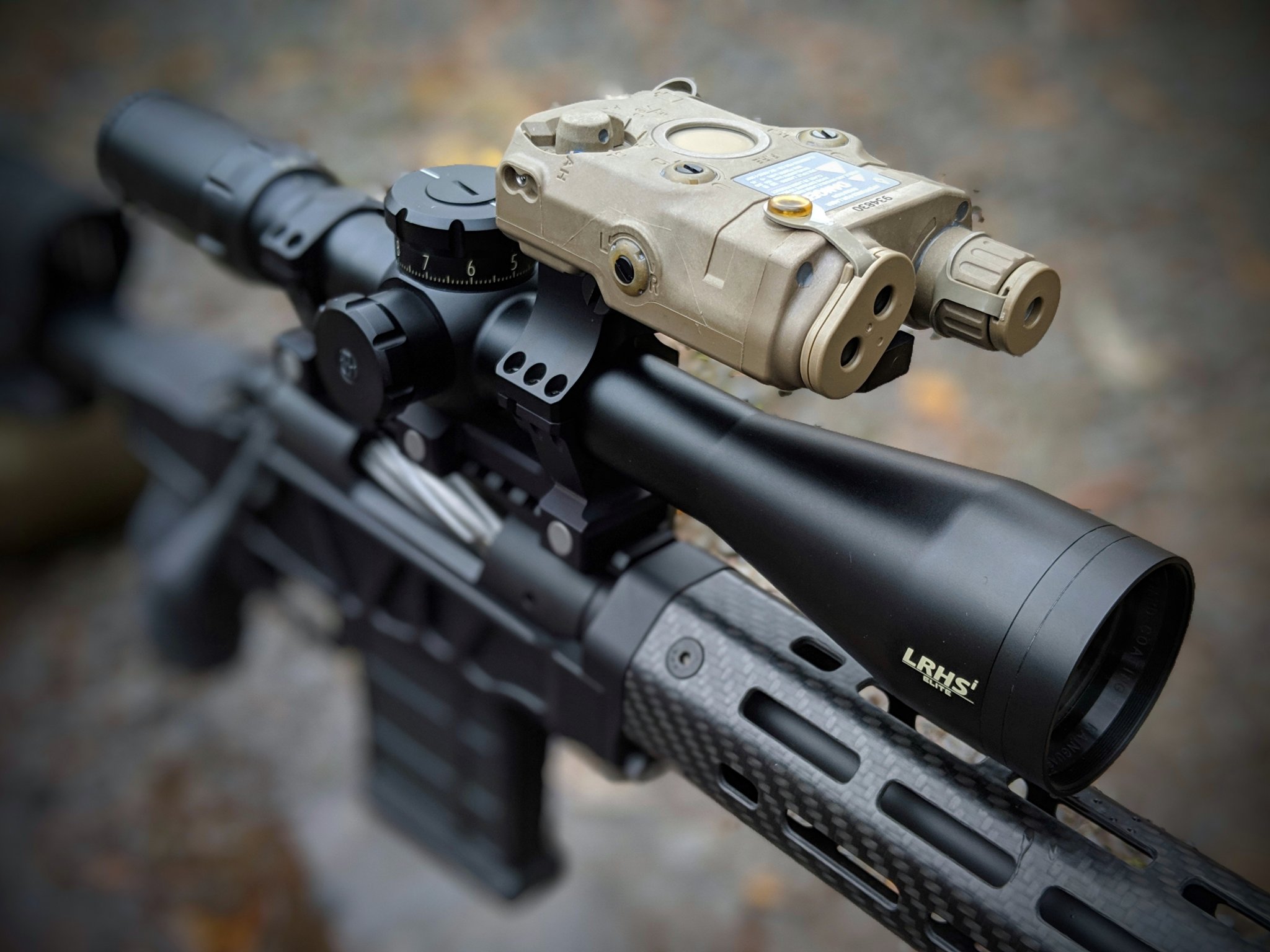

    Blanked out. Me and 3 of my buddies killed 22 last year, but they rotated the peanut fields out for cotton this year and it made for a tougher hunt. I did get to use the gun with the M2124LR on some steel at night and the PEQ-15 mount worked out wonderfully. I now want a top rail on all my rifles that pull nighttime duty.

    I like that. I would have gone that route if I didn't want to run NV. The chassis systems just make it easier for that. How much does this one weigh?
    How do you like that stock? Is it pretty solid or hollow?
    I like it a lot. It's as rigid as any of my manners stocks and it is genuinely superlight at 1.3lbs. The ergos are great. Here's a short video somone made:
    I don't consider 10.5# "lightish" in any sense! Very cool rifle though.
    Touche'
    However, its all relative. It is fairly light for a gun with all its capabilities. I would say most chassis, NV capable, adjustable LOP/Comb guns weigh between 12.5-15lbs with optic. I would have like to have seen just under 10 lbs and I may try to get there with a different scope/mount combo and maybe removing the brake and going direct thread with my Nomad or Sandman Ti. Going to wait until after SHOT for any firearms related buying decisions so we will see.
