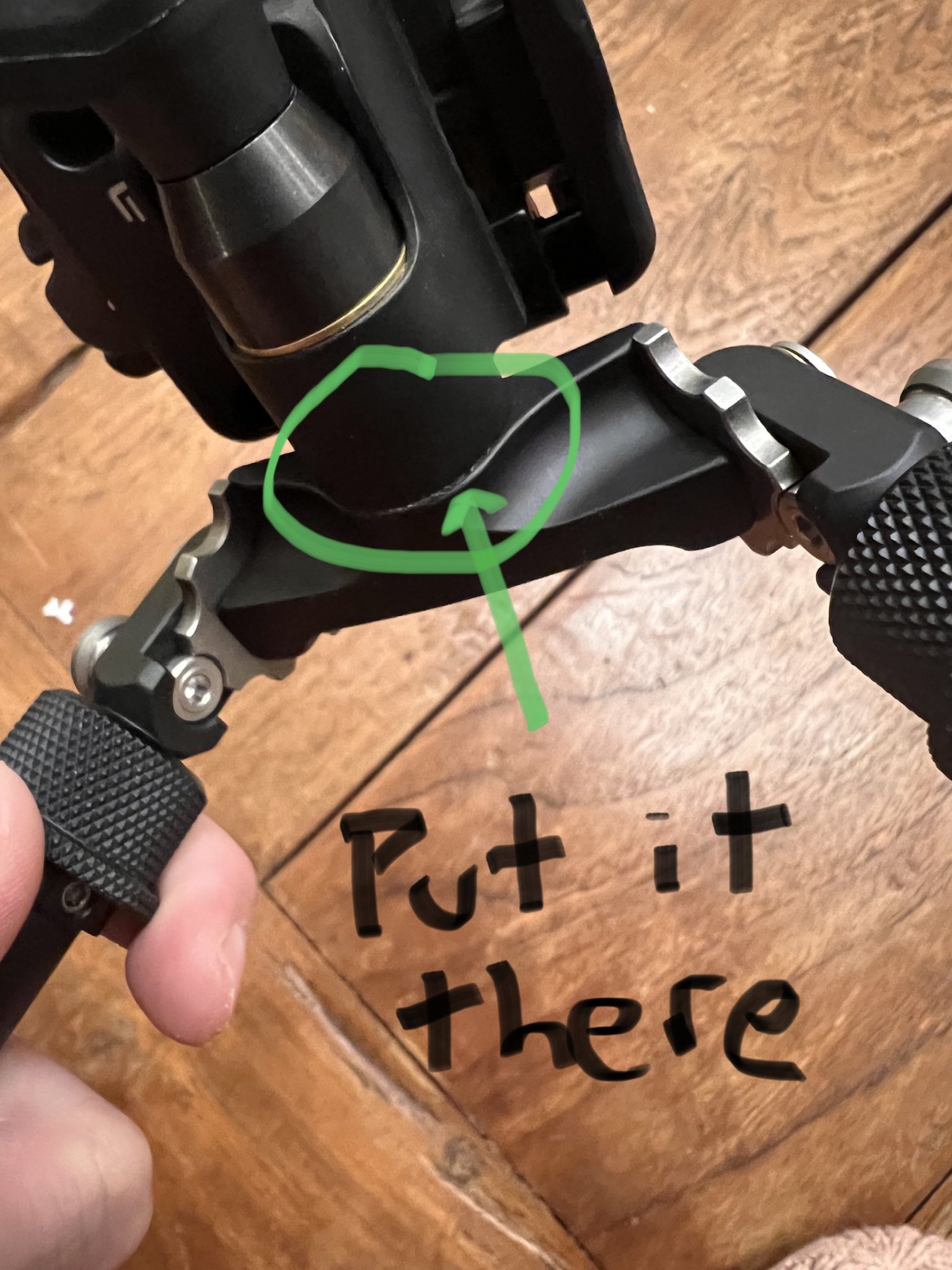

Ok, sparked by this post by @Old Man with Gun:
I began a quest to find a carbon fiber drag washer for my CAL v2 bipod. Drag, as for fishing reels, not for drag shows.
Anyway, I found one, which amazingly needed no cutting, sanding, fitting, cursing, or anything! Heads up: I shoot from a bench, I want to lock the cant ability off (or make it very, very stiff). The CAL, for me, was not cutting it even after messing with the locknut's gross tension adjustment, and I was ready to sell it.
My mod doesn't give me 1000% lockup like my Elite Iron or LRA bipods, but close enough for government work. I wiped off the existing grease that was in the area where the original washer resided before slapping the new CF one in there. I didn't use acetone to remove ALL of the grease, which maybe wouldn't be the worst idea if you want max max max lockup.
I did alert @Kasey (owner of Atlas/B&T Industries) to my research and he's looking into washers like these. Btw, @Terry Cross, the creator of the Pod-Loc cant tightening device that's on the Atlas (and other) bipods told me that his invention works the way it does is by design, a design which was driven by his end users. Out of shape lusers like me were not his focus lol (nor should they have been).
Anyway, I use bipods at the range sometimes because they are light, and I want to set it and forget it. Can't guarantee anything if you like to have a looser cant. Kasey said the previous CF washers his team tried were grabby; if they added lube they didn't lock off enough. Maybe I got lucky…mine is not grabby either.
THE SECRET WASHER​
----> Ask for model number: 8** (yeah, with two asterisks) <-----
Carbontex Drag Washer - 19.54 x 8.06 x 0.76mm
https://www.smoothdrag.com/wp/
Fits Atlas Cal pretty much perfectly. I see no need to trim.
I texted (760) 949-0271 and they texted back. Or you can email, whatever. $2.85 + $0.68 for first class shipping. Ask 'em how to pay.
I got one for free. It wasn't a comp for review thing. They just offered as I suppose they usually get larger orders.
Don't ask for a free one you idiots. It's tree fiddy!!! Do you live in your mom's basement???

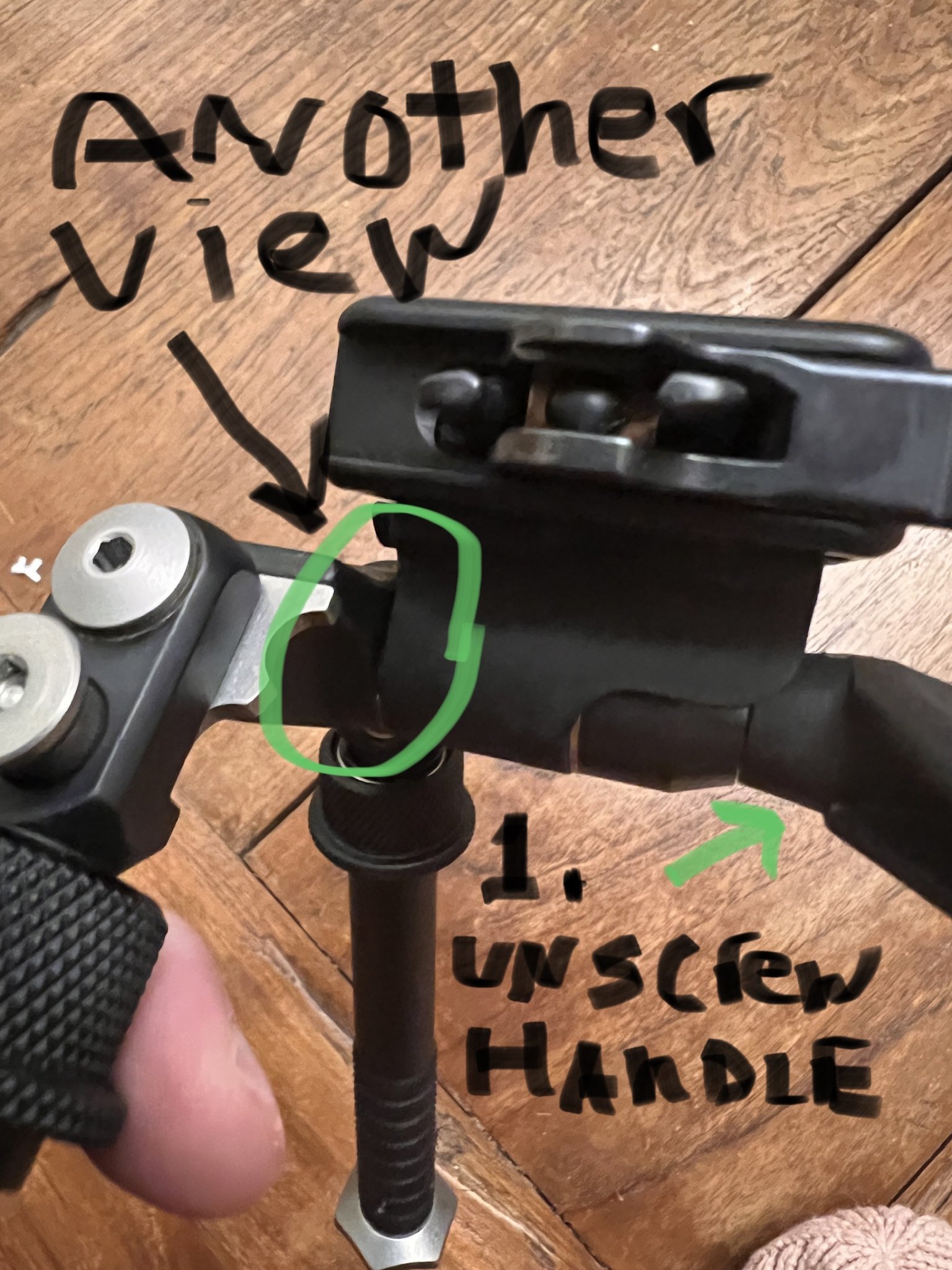

  1. Unscrew handle
  2. Use socket or wrench to remove locking nut. Various other parts will slide off.
  3. Slide "mount" off of spindle. Kinda tricky.
  4. Remove white plastic washer, decide if you want to remove all grease or just wipe excess off
  5. Put your new CF washer on
  6. Reassemble and fine-tune the gross tightness by tightening/loosening locknut
  7. Spin on handle and go shoot
Carry on.

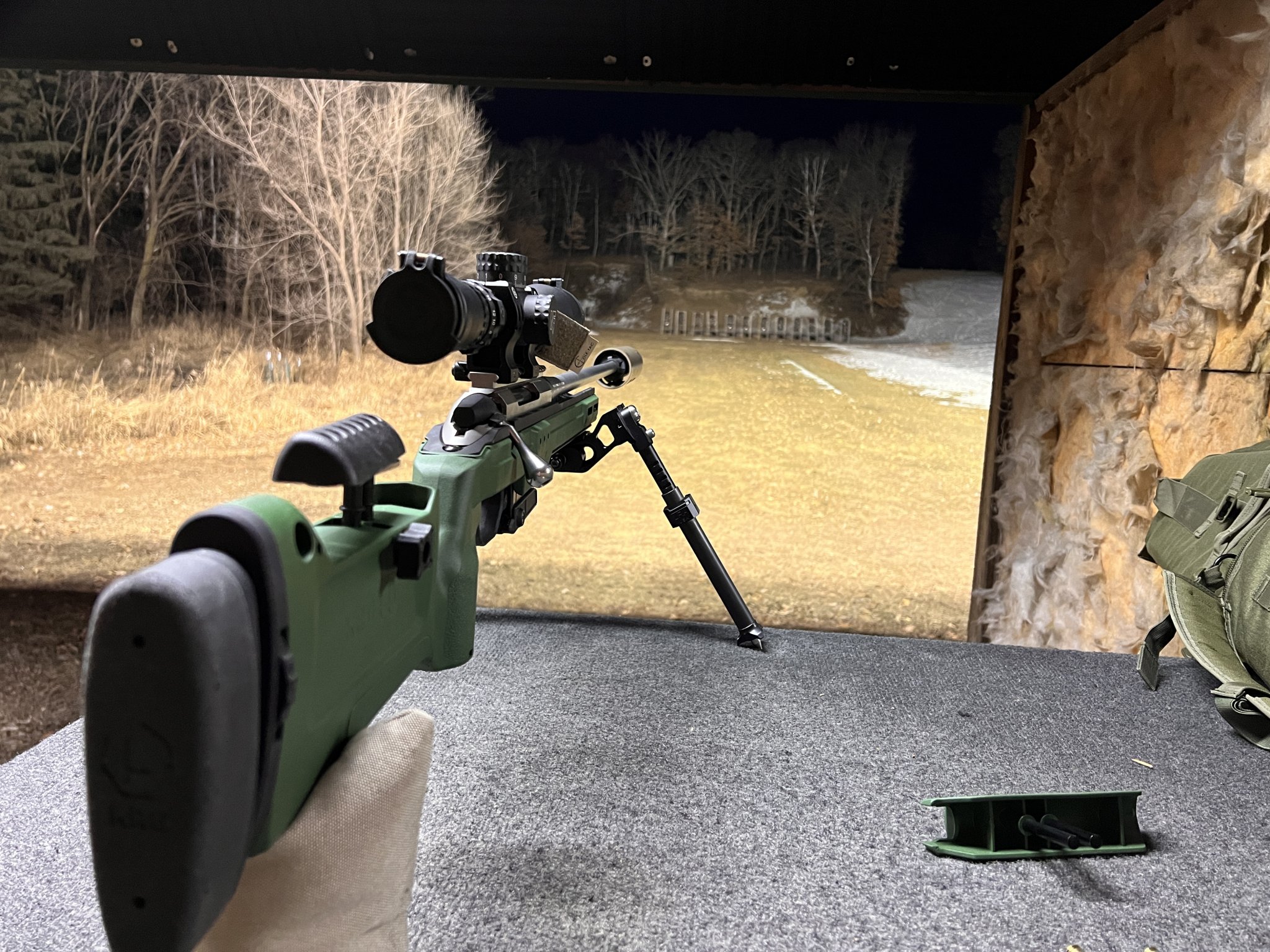

LRA F-class Lite-Tactical in action with an AIAT and a KRG Tikka Bravo . LRA needs shorter names for their bipods.
I have one of those too, though I need to find a decent way to have both picatinny and arca quick connections on it, without adding too much height.

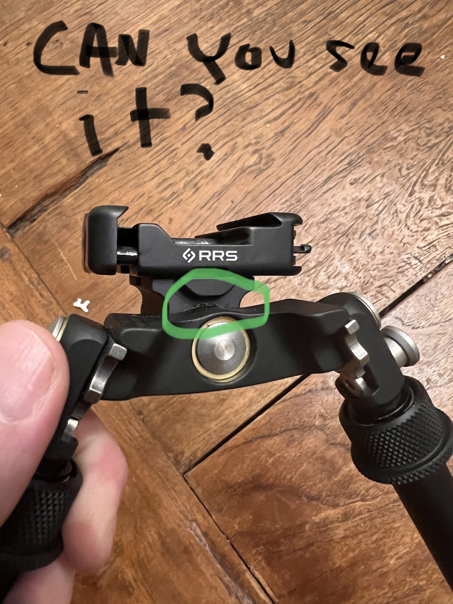

Only way I have done that is one of those 17s pic rail adapters to the bottom of a RRS SC-Arc BTC-PRO screw clamp (the SC-ARC lever clamp won’t work due to lever clearance issues).
Currently I just go native LRA pic rail because I’m sort of tired of Arca.
Only way I have done that is one of those 17s pic rail adapters to the bottom of a RRS SC-Arc. Currently just go native LRA pic rail because I’m sort of tired of Arca.
Me too, but mine isn’t quick connect, so it’s a bit of a pita to me. As you said, it doesn’t fit the case with it on.

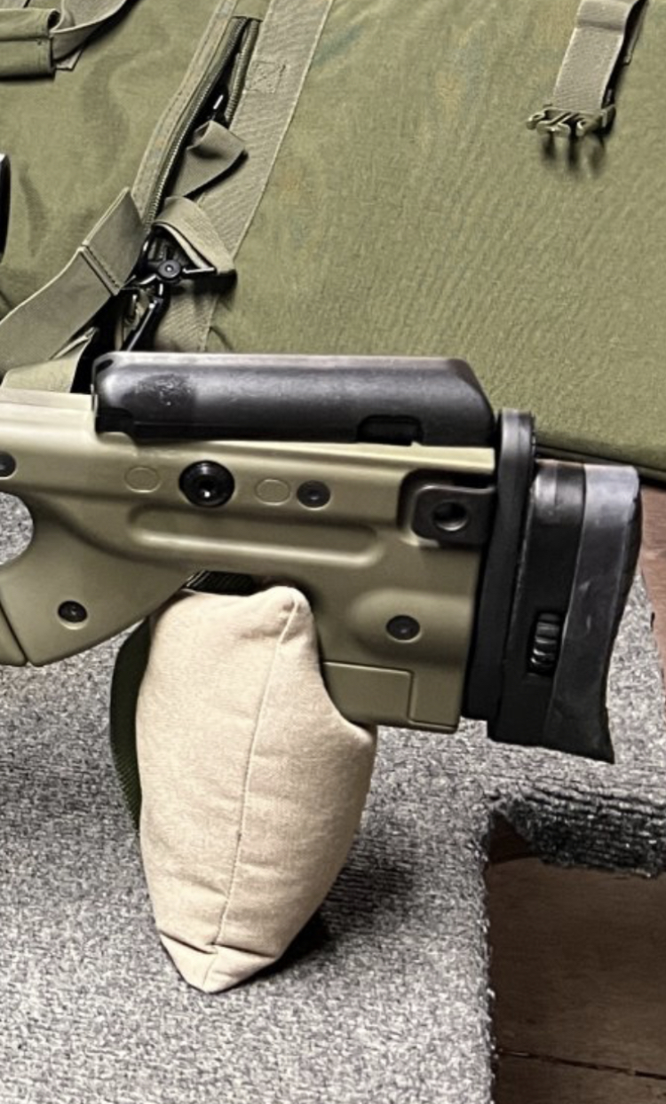

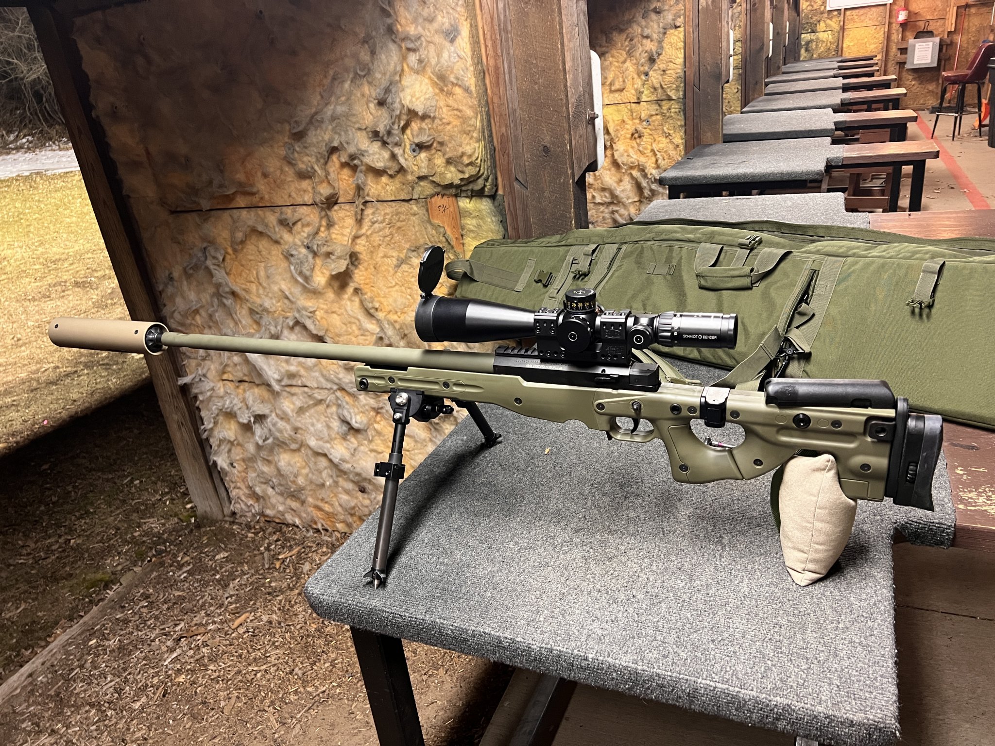

Off topic:
Is this some aftermarket madness as well on the cheek rest?
Yeah, I’m a weirdo and like angled cheekpieces. The stock one on an AT does angle with no mods.
6br is probably the largest caliber I’d try with that setup. You can get a little “reminded” that recoil exists even with 6br.
I also have my KRG chassis (W3, Bravo) set up that way. KRG sells an optional kit to mod the stock cheekpiece. Only shoot 204 with those chassis.
Angling the cheekpiece allows me to get my head directly behind the gun’s centerline the absolute most for some facial geometry reason that sort of doesn’t make obvious sense?
Reactions: DubfromGA and lash
Just slide the whole thing over laterally to the side, at least the loggerhead and better chassis do that so you don’t smash your face with each trigger pull
Reactions: Baron23 and lash
I have tried just that in the past. The weird thing is…the angled orientation works/feels better? I can’t explain it.
I need someone to make a cast of my skull so I can grab it and move it around on the buttstock so I can see what’s going on from an ergo standpoint.
My guess is angling the cheekpiece the way I have has moved the back of the cheekpiece even further away from my face than just laterally sliding the entire cheekpiece over to the right.
My cheek still gets a nice reference point and my head is as straight up as possible.
Somebody must like it as KRG offers the option. That or I’m using it off-prescription lol
My mistake, I meant the BTC-PRO screw clamp from RRS, not the SC-ARC as that won’t work due to lever clearance issues. IIRC.
