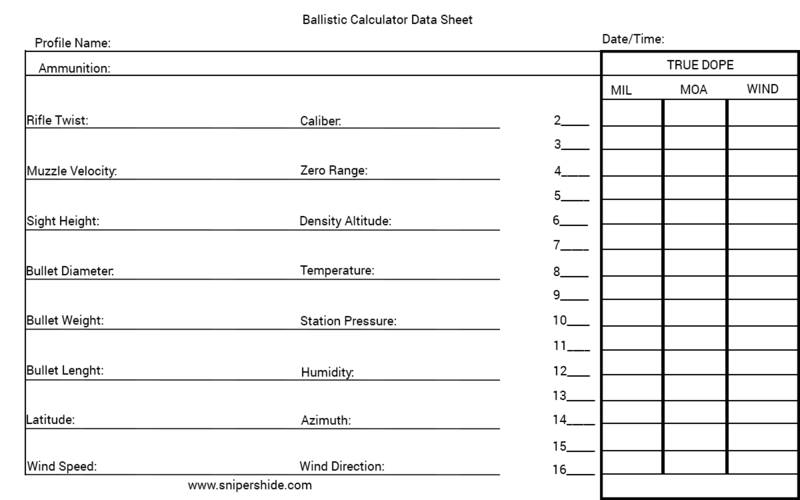

    My method of setting up software involves coming to the software after the fact. First I set up and dope my rifle. I zero it, I chronograph it, I take it from 200 yards to distance recording all my drops. These details include the atmospheric details for the day. All the same stuff you would have included in your databook before the use of ballistic computers. To others with this, I created a new databook page.
    I will be working with Tony at Impact Databooks to include this page and plan on using it during my classes so students will have everyone on one page.
    Using this page at the range will allow you to match the computer to your data, because we all know we cannot match the rifle system to the computer.
    Station Pressure I think needs to be renamed for shooting to Shooter Pressure. I still get guys questioning my Barometric Pressure of 25.25. They think it is impossible for me to have a pressure reading that low. They want to default to the same barometric pressure the weatherman uses vs using Absolute or Station Pressure. I did not include standard altitude for this sheet, only Density Altitude as many us DA for their Apps. They should get used to using Station Pressure vs Barometric Pressure, but that is another post.
    You can print this sheet, and eventually it will available through Impact Databooks.

    you could rename to just pressure and then next to it have an A (absolute) or a B (Barometric) then the user circles which one they used. in your sheet, i assume Azmuth = DOF?
    when Tony does it it will look slightly different, he can add in that stuff,
    we are gonna add in the wind block and things you find in most of the databook pages,

    Frank, since you are listing some bullet's data why not to add BC ? Just for the sake of completeness.

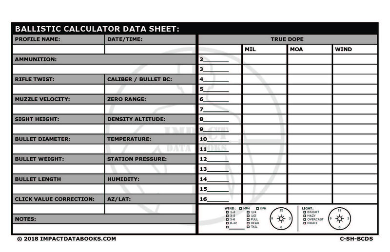

    This came across last night, it's 99%,
    Removing "Caliber" as we already have bullet diameter, so just BC will be there.
    Guys, this is why we work with Impact Databooks, Tony is so far on top of it, you have no idea how much I feed people and nothing gets down. On the other hand, you have Tony, I messaged him over the weekend, page is just about finished
    should have suggested sooner, think it went to print, just scribble it out
    plus i think people are too lazy, this was not meant as an everyday card
    Sorry just saw it... But Got it, Nice clean look
    I Gota say.. People are super lucky to have your help here.. Thanks for what you do

    I like the new data page. But unfortunately I don't have access to large flat areas where I can set up tgts every 100 yds. 500 yds maybe but anything farther it has to be across valleys etc where angles always come into play. Then there's up/down drafts. Any possibility of getting angles/wind calls included on the tgt lines?
    Any advise on setting up & truing with these variables?
    You can always just use the notes area to mark your angle.
    Use either MOA or MIl if you use put the angle in the other, this is help you true your software, it's not something to use everytime you hit the range or shoot.
    You take this back to true,
    With all those conditions, you have no way of knowing if the wind was pushing the bullet or what not, your data is not exactly "True" it's conditional

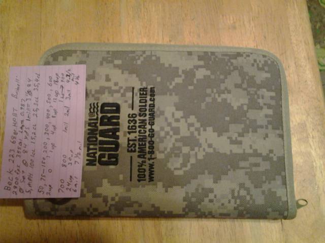

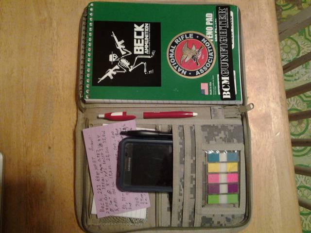

    I have a problem with my range book.
    I'm putting a new one together and this one is special to me.
    It was given to me by my son that served at one point 18 months in Irac at a high value detainees facility.
    It replaced Abu Grabie, (sp?) You know the new hole in the fence.
    Curiosily my other son did extractions and delivered some (people) there at some point not the same time.
    Not one data book I have found spirals at the top will fit my rig.
    Has anyone seen one?
