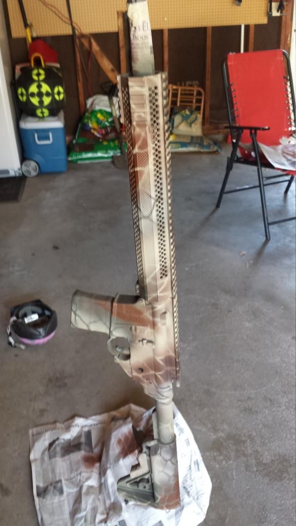

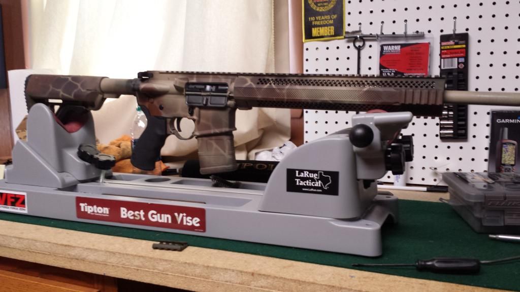

My take on Kryptek Highlander with rustolium
I used a cargo net from the trunk of the wife's van. I sprayed some alternating colors down and let dry. Then laid the net down and used a different color over the netting than what was under it. I used flat khaki, dark earth, deep forest green, and another brown that I can't remember the name of right now.
I saw a video on YouTube of a guy doing it this way.
Just plug the muzzle with a foam ear plug, mag in and lots of blue tape. Prep and degrease and go for it. The high use areas (grip, forearms, cheek weld) may come off overtime but if you use it fine. If a safe queen may want to get it professionally done

Looks awesome! I've painted some with a fishnet shirt. They look alright but I like this bigger netting. The flat clear coat is they key. I put about 5 or 6 coats on. Without it it just scratched off easily.
