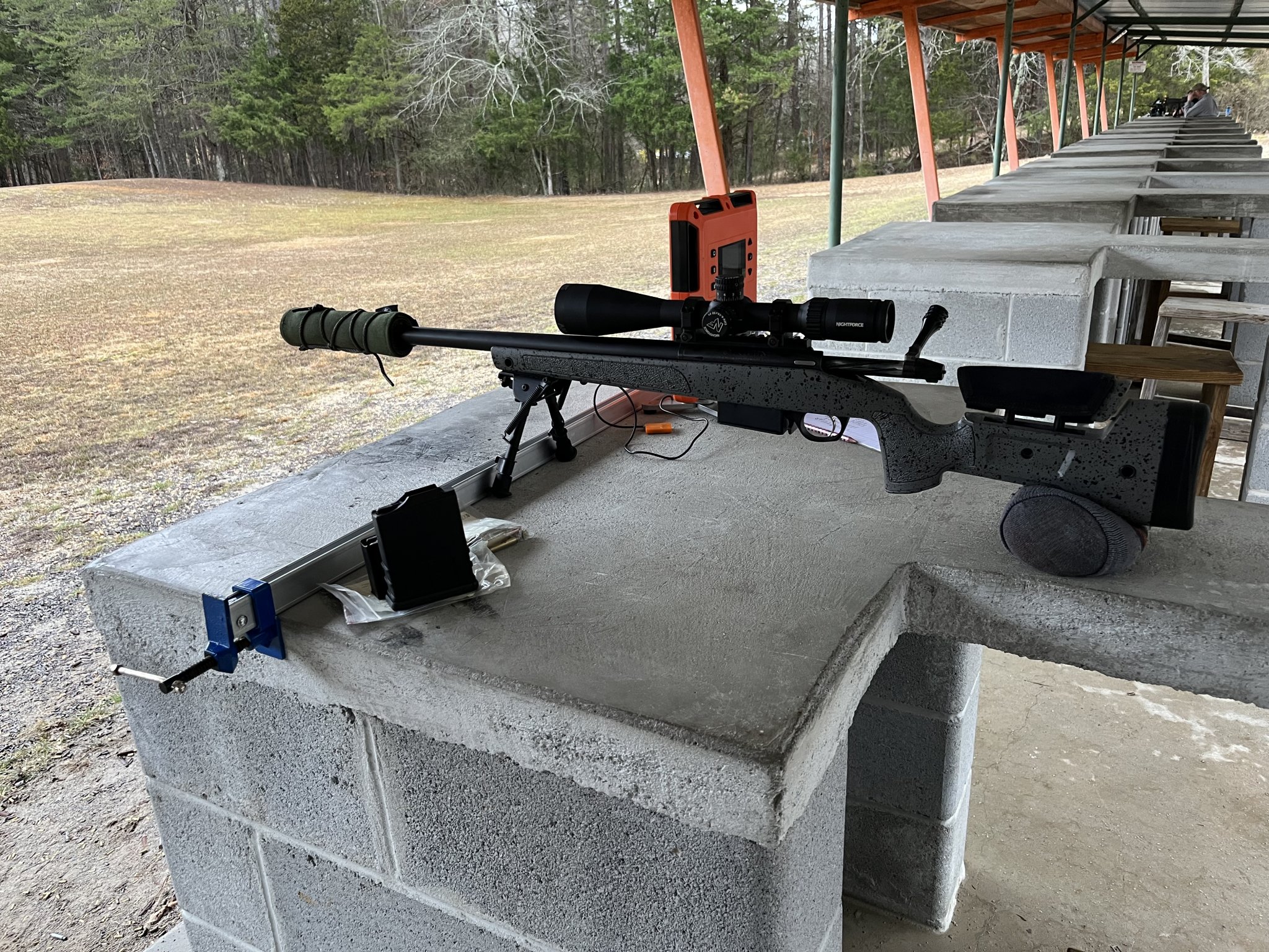

I’ve ran one on a bighorn origin. Had to open up the bolt and barrel channel. Easy enough with files, sandpaper and socket just take it slow.
Ran it with a crown ridge barrel nut also. I’ll dig out some pics.

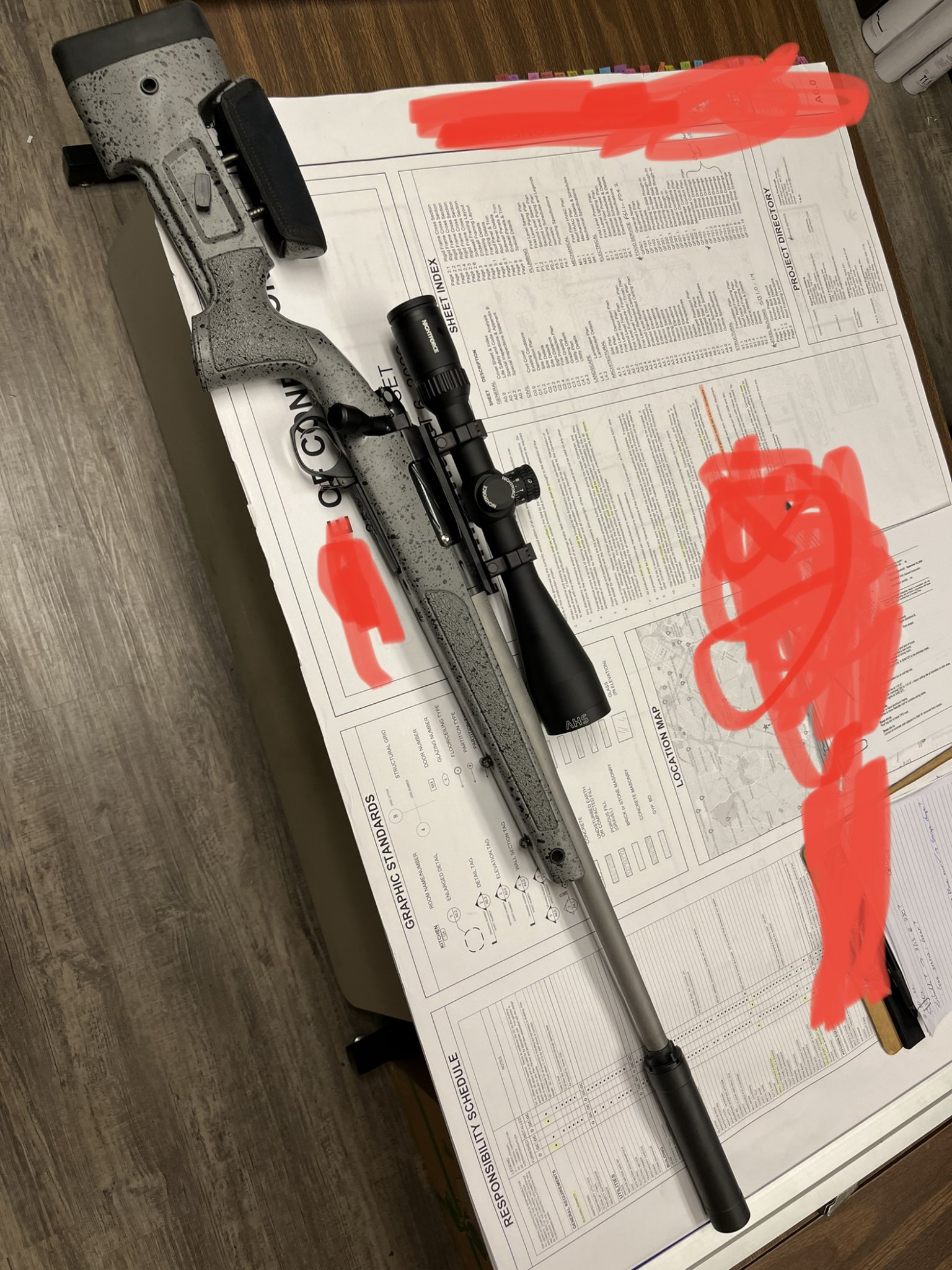

Another pic…shouldered barrel

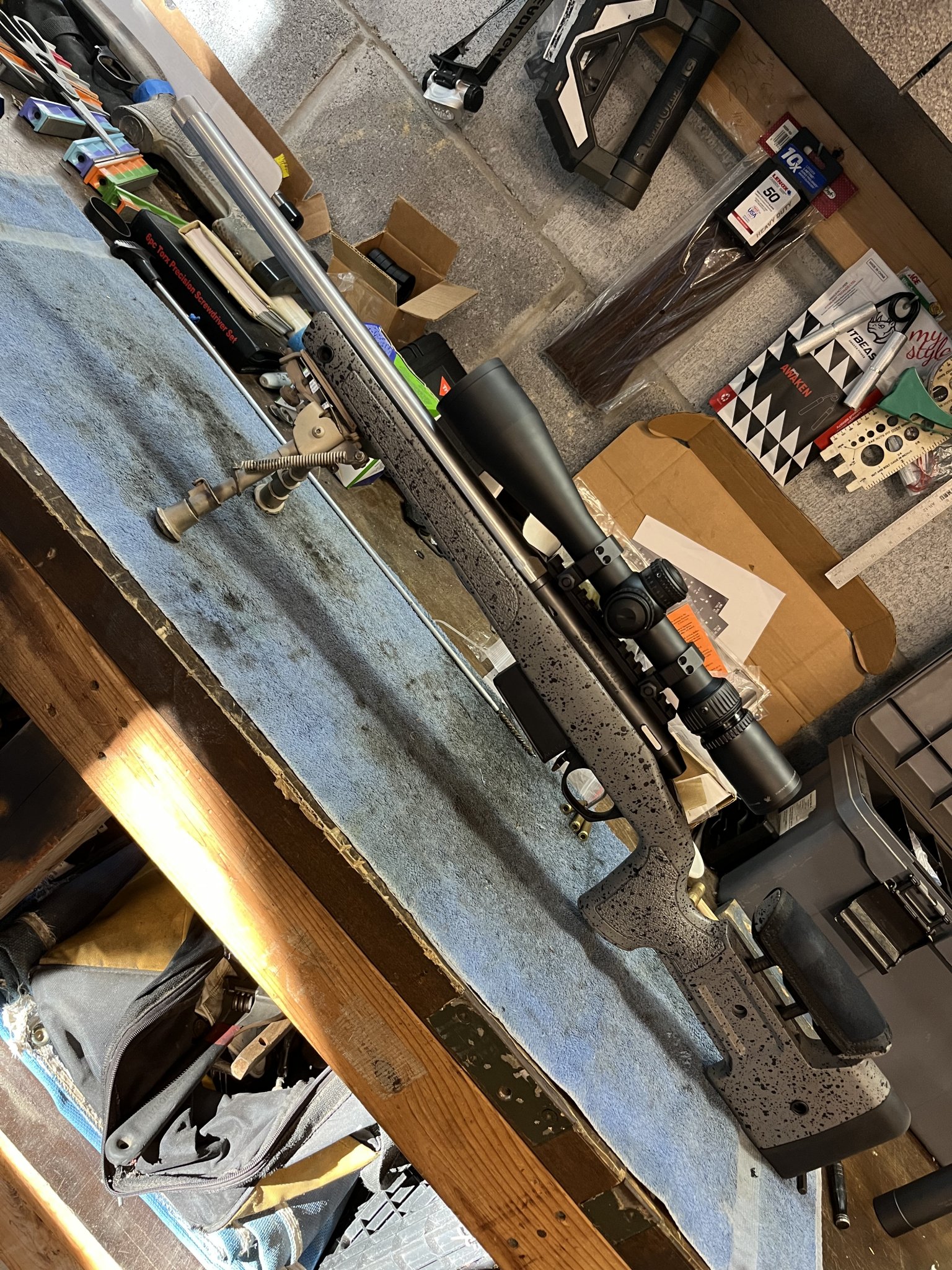

I opened one up for a M24 barrel….wasn’t bad but slow going with a few sockets and sandpaper. It was at the max for barrel channel though. Even dig into the aluminum chassis just a little.
Only pic I have of that barrel….
