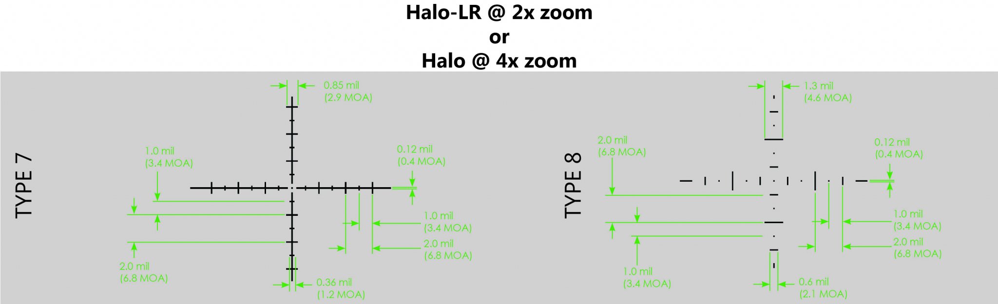

8. Added two new reticles. New reticles (Reticle Type 7 and Reticle Type 8) are designed based on requests from HALO and HALO-LR users who wanted to have a familiar 1 mil subtension spacing at higher magnification levels. Reticles 7 and 8 provide 1 mil subtensions at 2x digital zoom for HALO-LR or at 4x digital zoom for HALO.
Subtensions have to be scaled accordingly at different zooms.

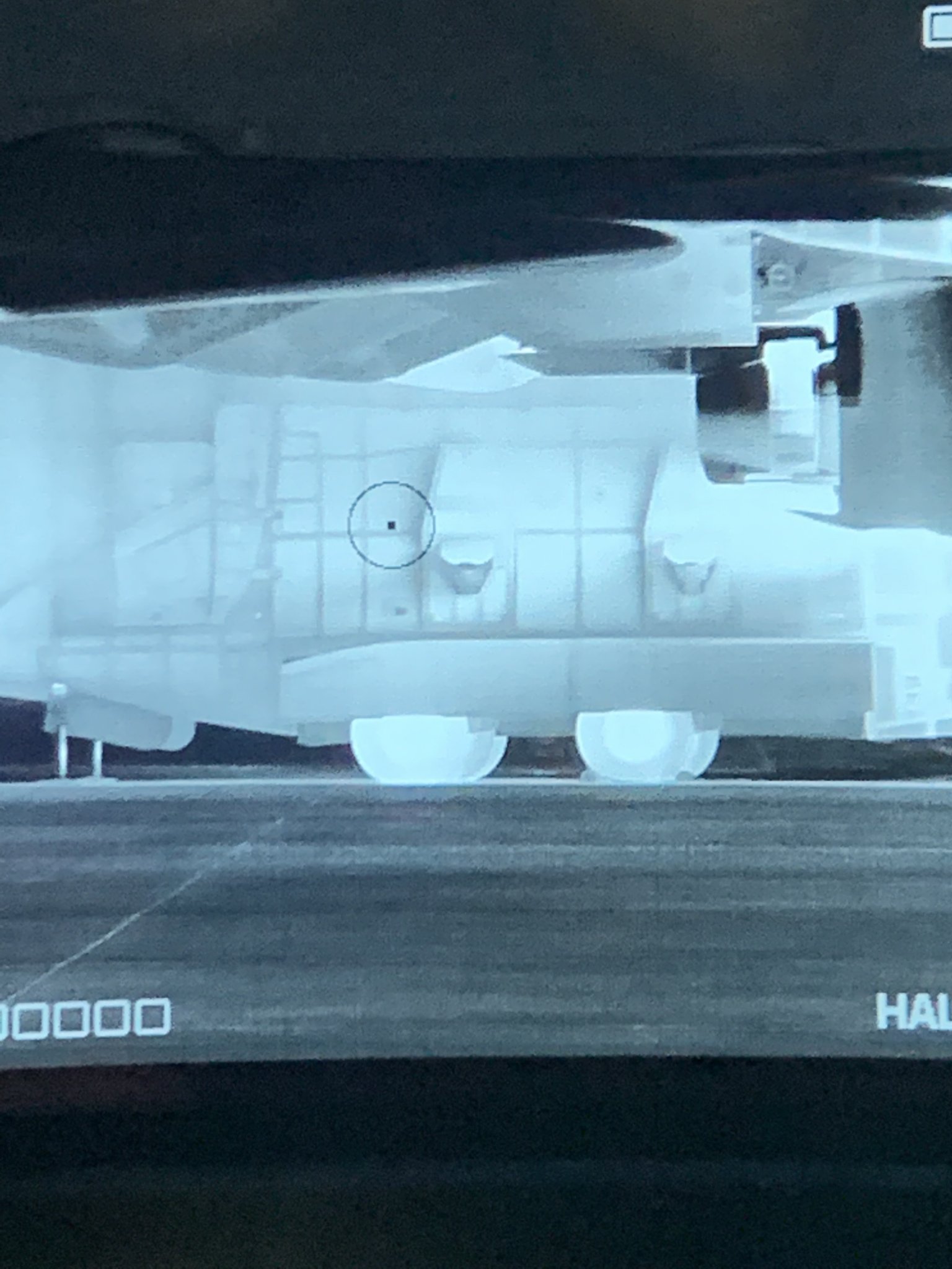

Can’t wait to get my thermal back on Thursday. Definitely dint take 3 weeks. I am at two weeks and 4 days by the time I get it into my hands.

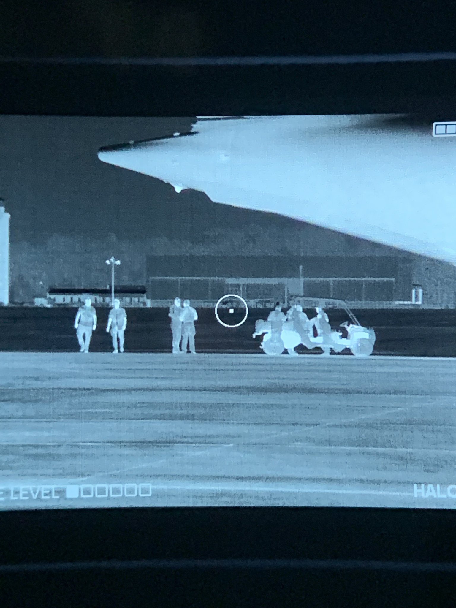

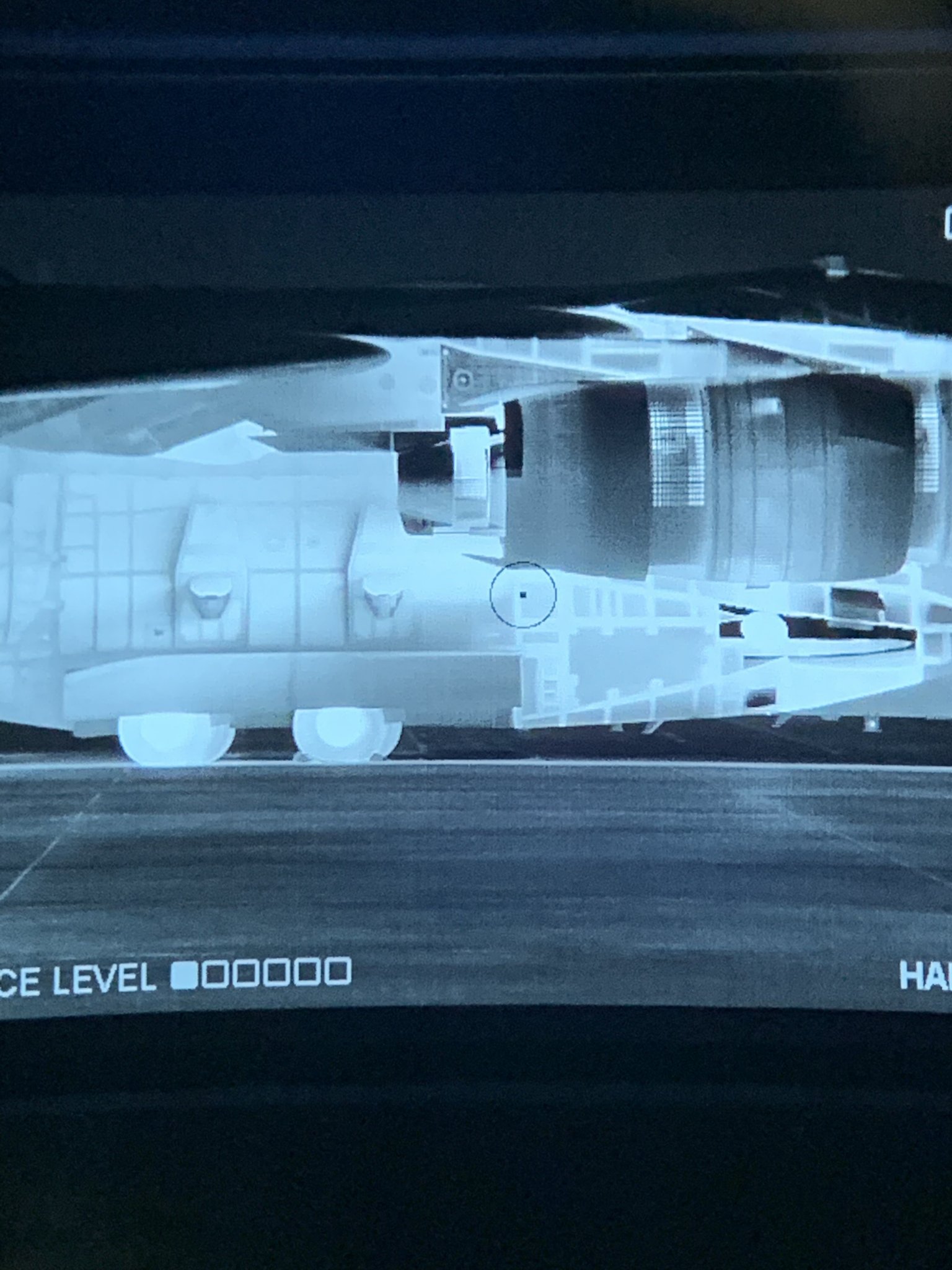

I received the unit today the updated is really good. definitely I love all the new features and the reticles are nice too. I just have to learn them and I will report back how useful they really are. The 8x is definitely a good update is Useful to some extent. I only spend tonight on it and the weather was not that nice to really see if there’s improvement on the image. Really I was in a big open airport and everything was really far away to get a feeling on the image quality. But the time I got to spend looking at close objects I can tell it was awesome. It could be that I was really excited to have the thermal back will see tomorrow when I get to look true my reap it and the Lr side by side.
Here are some pictures of a huge airplane in front of me the plane was 500-600 meters away but still is was really big and the weather was horrible.
Reactions: Max_R
Also this picture are 4x so the image is blurry it was a lot of bad combination. I will take better pictures tomorrow when I am not working and can concentrate on taking them.

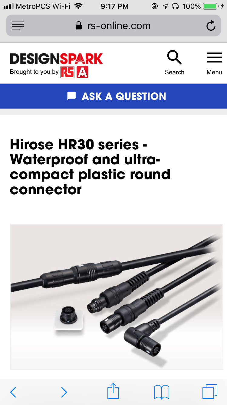

I don’t know if you’re still looking for a right angle connector. I found this for the Hirose 30. I’ll try and contact them. I attached a picture of the connector. Looks like it would work perfectly.
It appears, based on the literature, that these right angle plugs can be ordered to your exact 6 pin specifications. I would believe they could design the plug to have a short, possibly 6 inch cord with USB or similar input to connect to phone, dvr or external battery. I would think N Vision could place an order for 100-500 of these to be used for future purchases or for current owners to buy.
