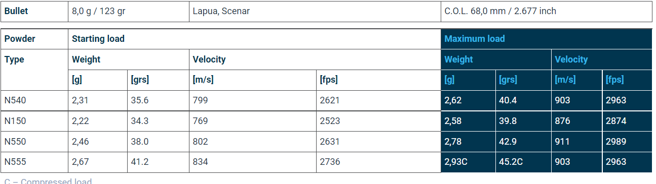

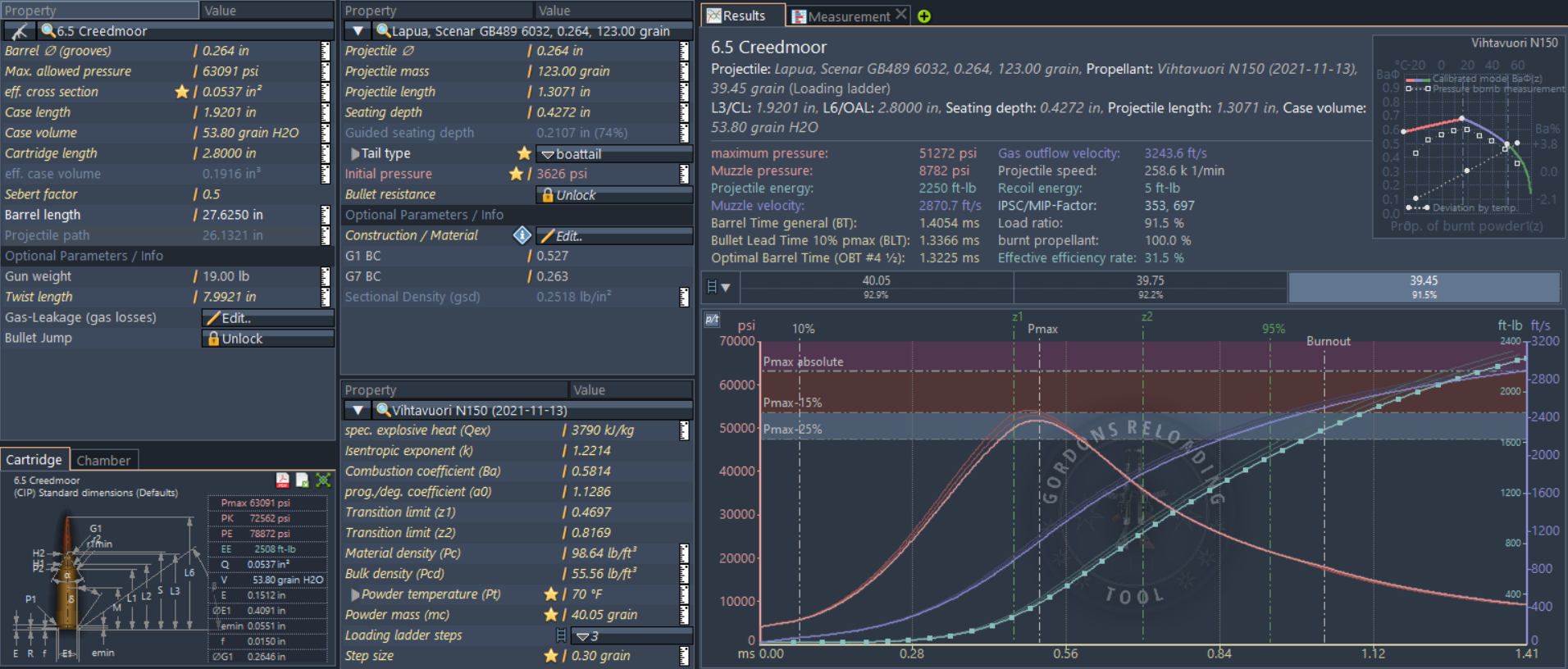

Viht has data. GRT looks like you could send it a little higher than VV max, but it's probably due to lack of case volume tuning and I ran it at 2.8 OAL.

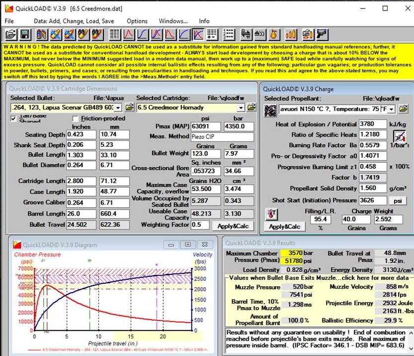

Knowing your case volume is a critical factor, otherwise, we've just guessing. And for further more accurate guesses, if you have any velocity info for this powder, even for some other cartridge, it's be helpful so that the burn rate can be adjusted. So, take the following with a grain of salt:

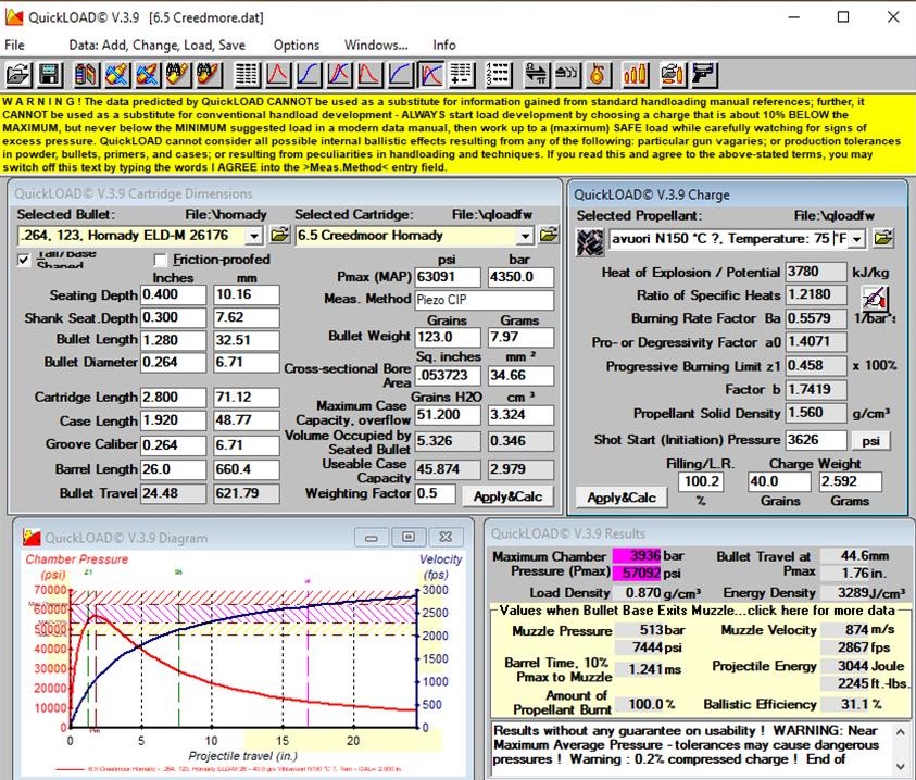

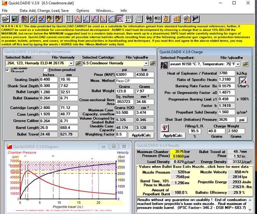

That 51.2 gr sounds about right for Lapua. I have info on Peterson brass and they tend to be around 50.6. I used QL's value and with what you've stated, you can see what that difference does to the results as you can compare:
