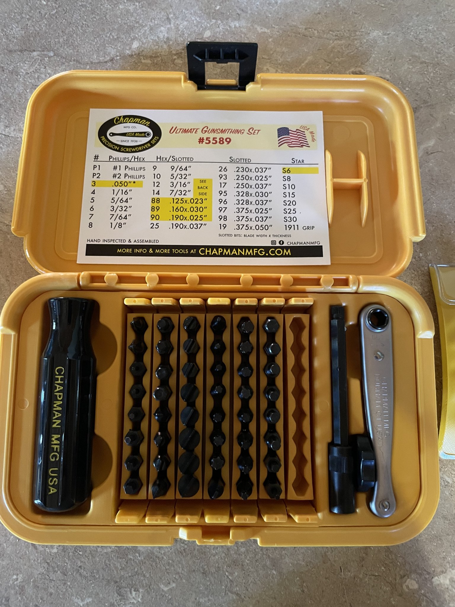

I have one of the deluxe Chapman sets. I chose those because the ends of the hex head bits aren't rounded and are instead straight. I don't like rounded edge/tips on hex head bits because they seem to waller out the screw heads if I'm accidentally not straight on.
My only complaint with the Chapman bits is that the T15 star bit twisted.
The tools accept regular bits, but they do not snap in place.
Overall, I'm happy with the set.

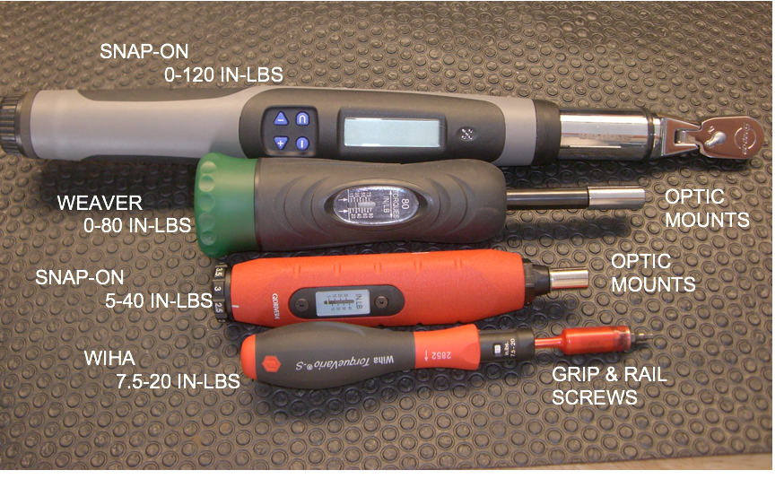

Snap-On bits are really good, but for smaller more detailed work here is my go to>:
Well, most of my scopes are from Austria, Germany, and Canada. My rifles are out of England, my scope mounts are from Sweden. Taking a stand on an American made torx driver is rather pointless in my case. Made in America use to be the badge of quality many decades ago, now not so much.
I hear what your saying. It’s difficult to find some things of high quality and made in the USA. If I can it’s my preference.
Reactions: pmclaine
I'll second this.
We use Wiha at work and they've always treated us well, from bits, to screwdrivers to small torque drivers.
I've bought some for at home and have had zero issues except for one time and that was trying to remove a pic rail from a Tikka.
I think Tikkas are built to test the quality of tools 😆

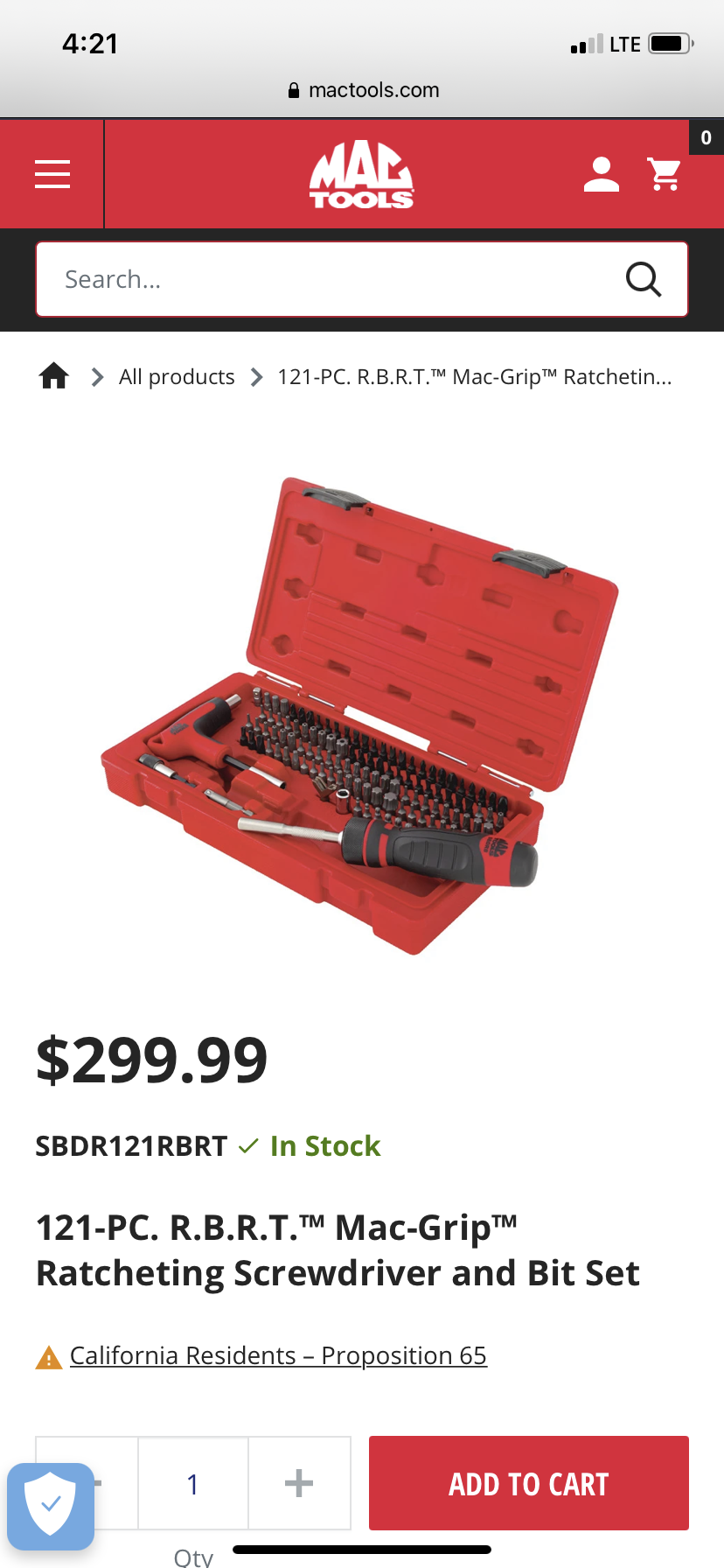

I have a mac tool bit driver set and a cornwell tools bit driver set. Both are magnetic . Mac part# SBDR123SA
cornwell part # CBS-D122S

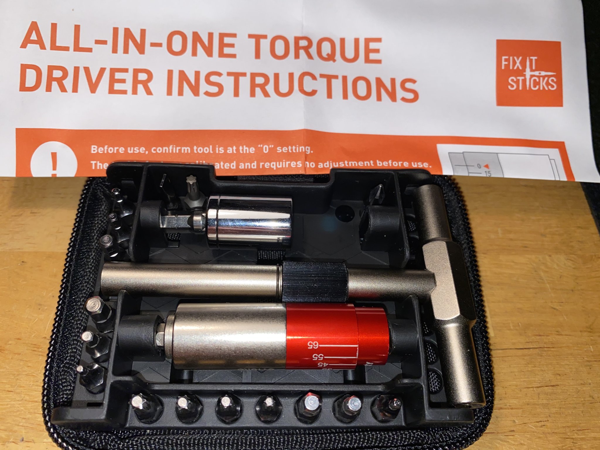

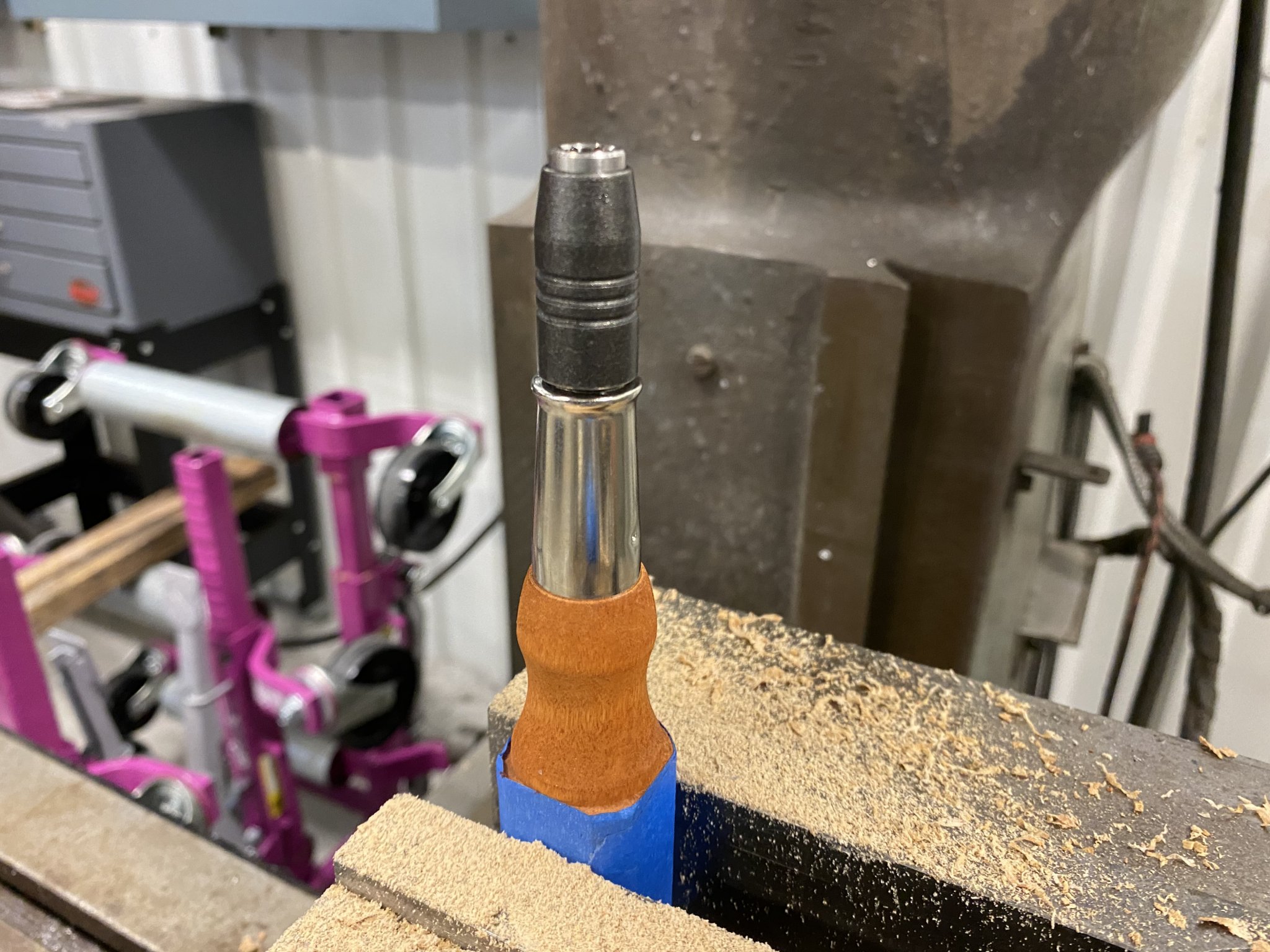

Fix It Stix, I checked them to my snap on torque wrench and they were spot on. They are slip sockets that accept any bit you put in them. Very quick and compact kit.
Reactions: habman13
I love my Fix it Stix tool set. Makes it incredibly easy to torque to specs out in the field. Compact, reliable, and can mix and match depending on what I'm taking out to the range that day.

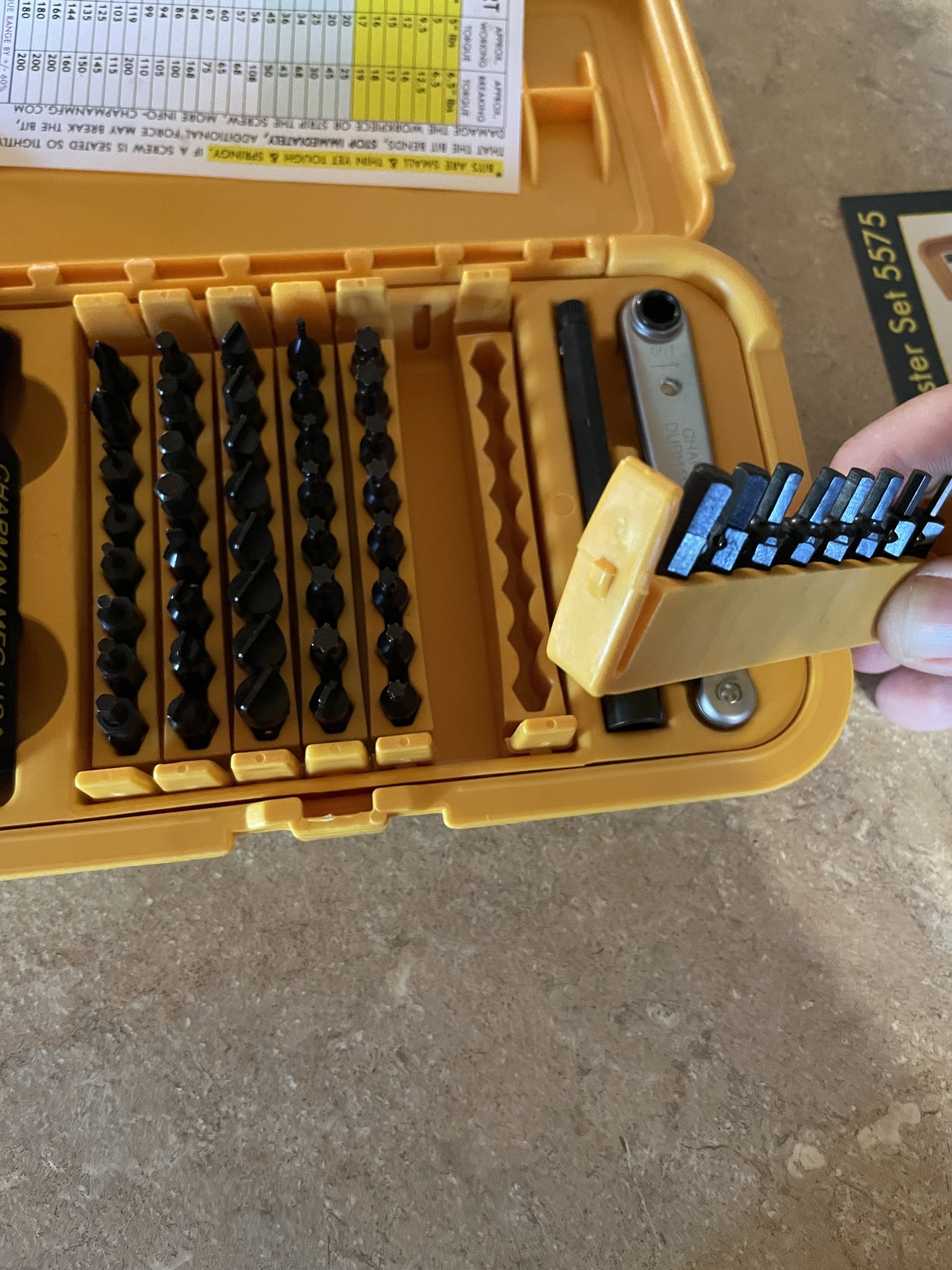

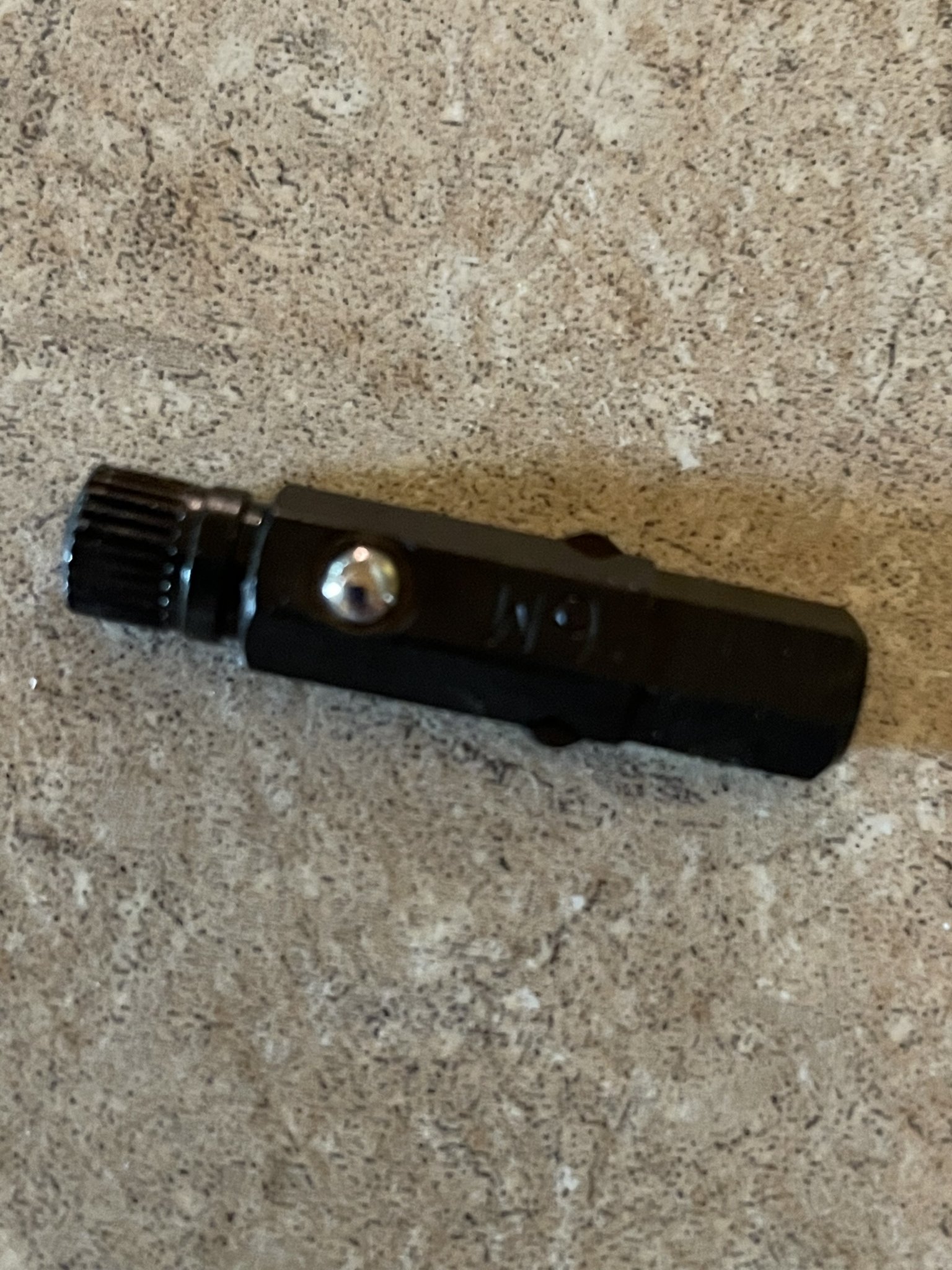

UPDATE —— THESE BITS DO NOT FIT ANY BIT ADAPTER I OWN… TRIED THE BORKA ADAPTER, BROWNELL‘S MAGNET ONE AND A COUPLE CHEAP ONES IN KOBALT KITS I KEEP IN THE TRUCK SO I WON’T BE HEARTBROKEN WHEN THEY ARE STOLLEN… SENT THE COMPANY AN E-MAIL ASKING IF THEY MAKE AN ADAPTER. EVERYTHING ELSE IS AWESOME AND I LOVE THE KIT BUT WILL LIKELY BE GOING WIHA IF I CAN’T MAKE THEM WORK WITH AN ADAPTER FOR TORQUE APPLICATIONS

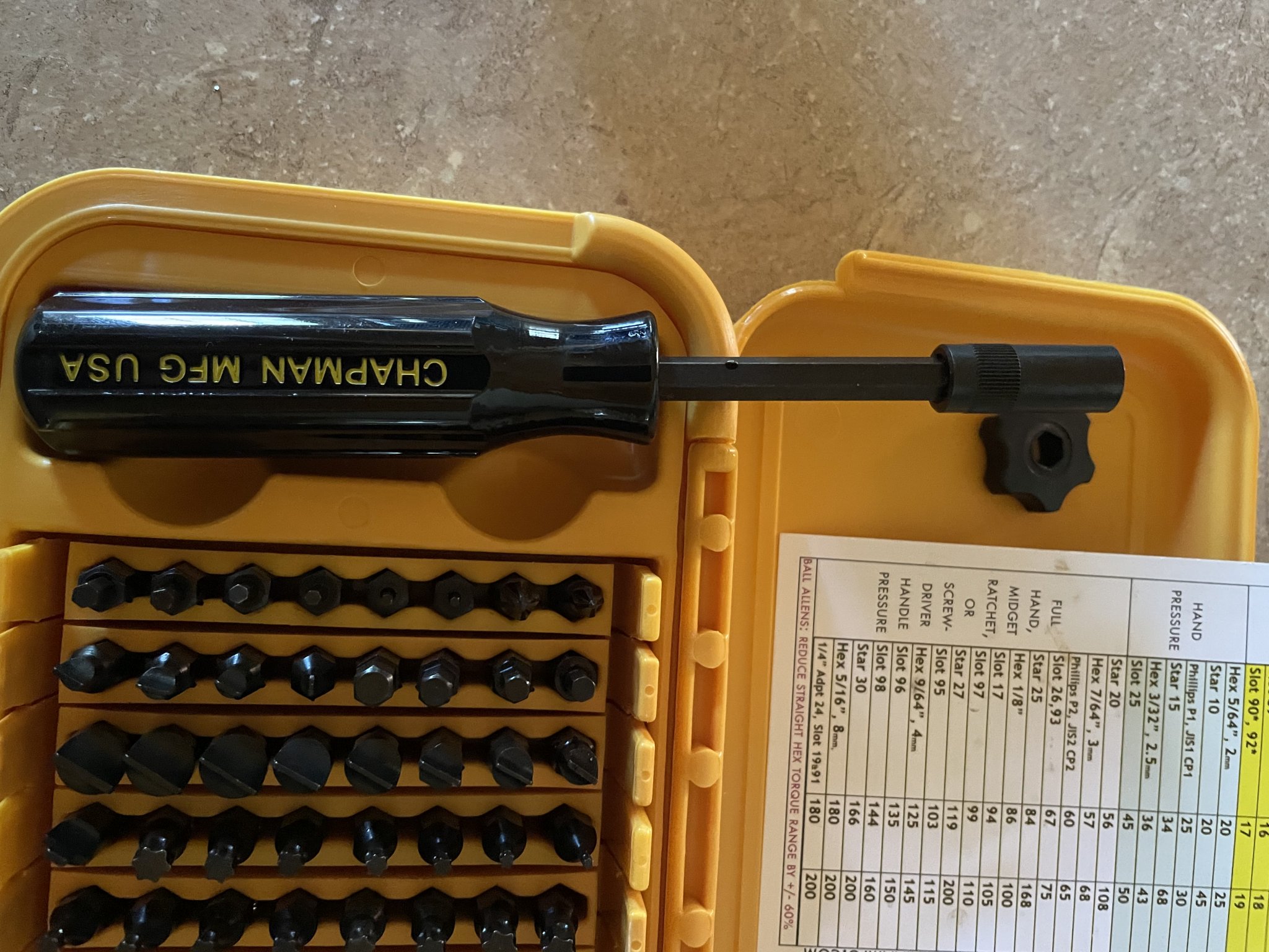

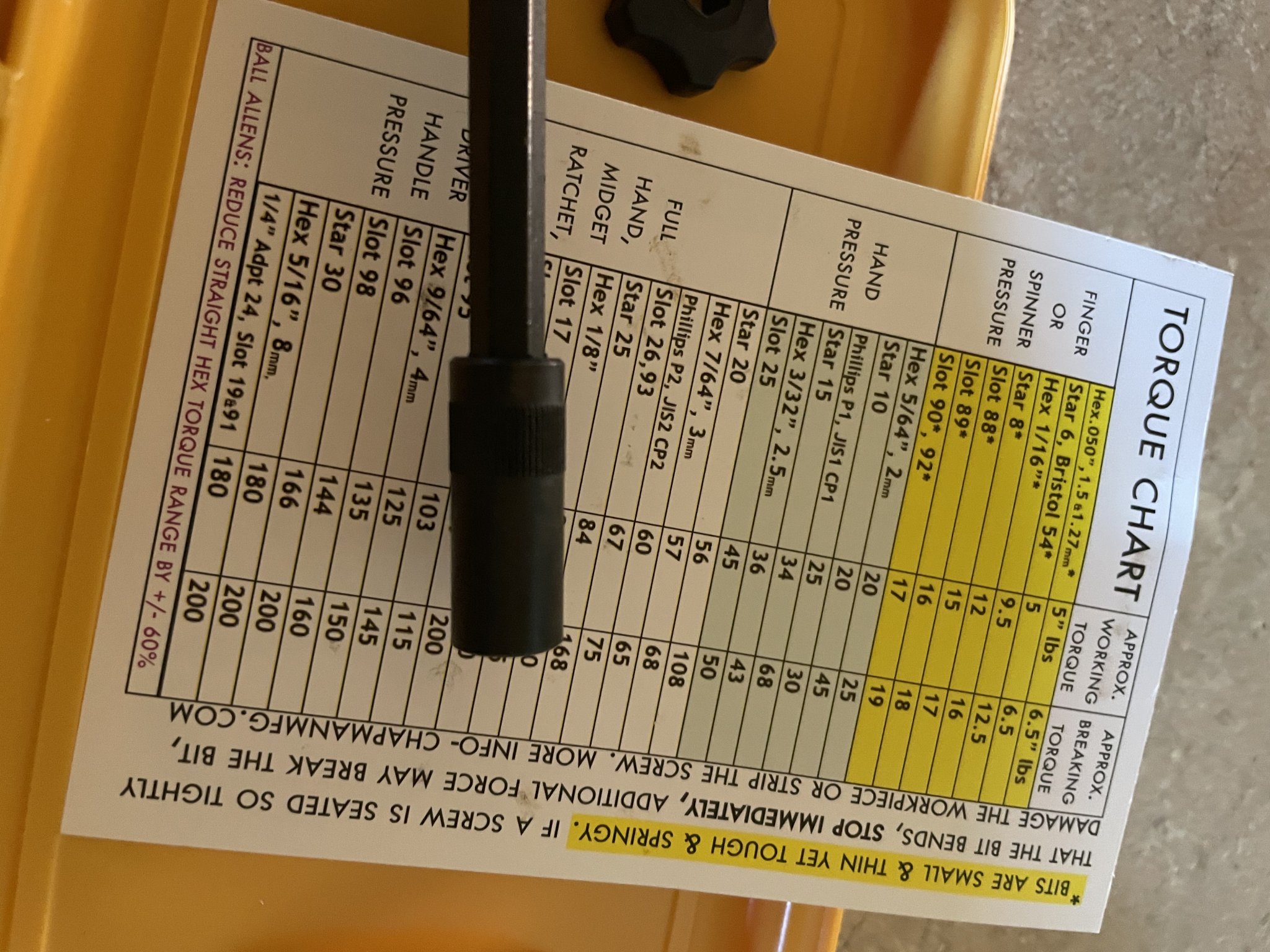

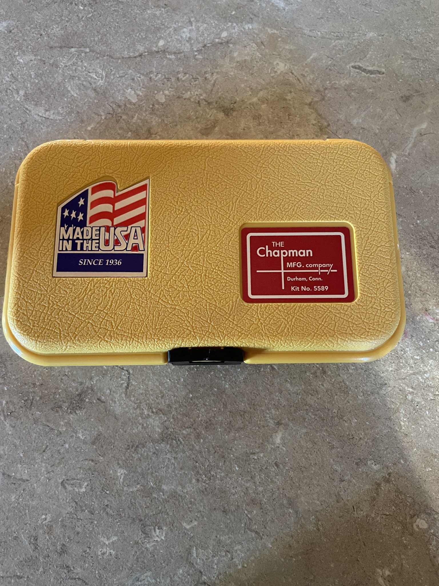

Got the bits in the mail today. I don’t have a long term report obviously because I just got them. Bits are clearly marked, comes with some useful references and I added to the original kit some spares (because two is one and one is none). Case is sturdy, better than the one that Brownell’s gives you with the magnatips. Bits stay in place when you turn it upside down and give it a shake. They will likely live on the bench where I have a borka kit but kind of nice they stay in place. Knurling on the screwdriver extension is a nice bonus. The “star” turning tool is plastic and don’t really think I see a need for with each bit having knurling as well. All in all I think there are worse things I could have spend some money on. Maybe after a year or so I’ll come back and update this.

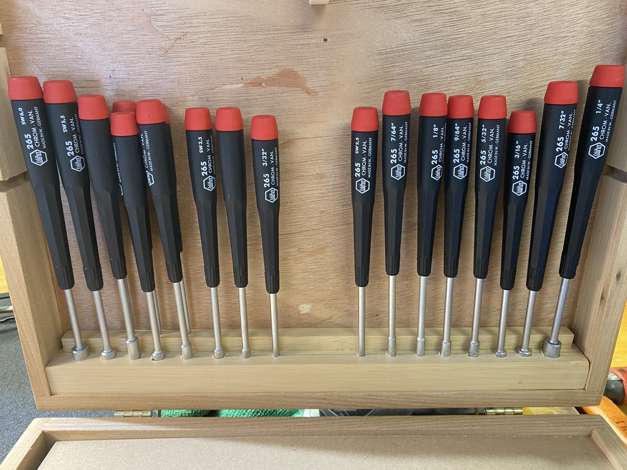

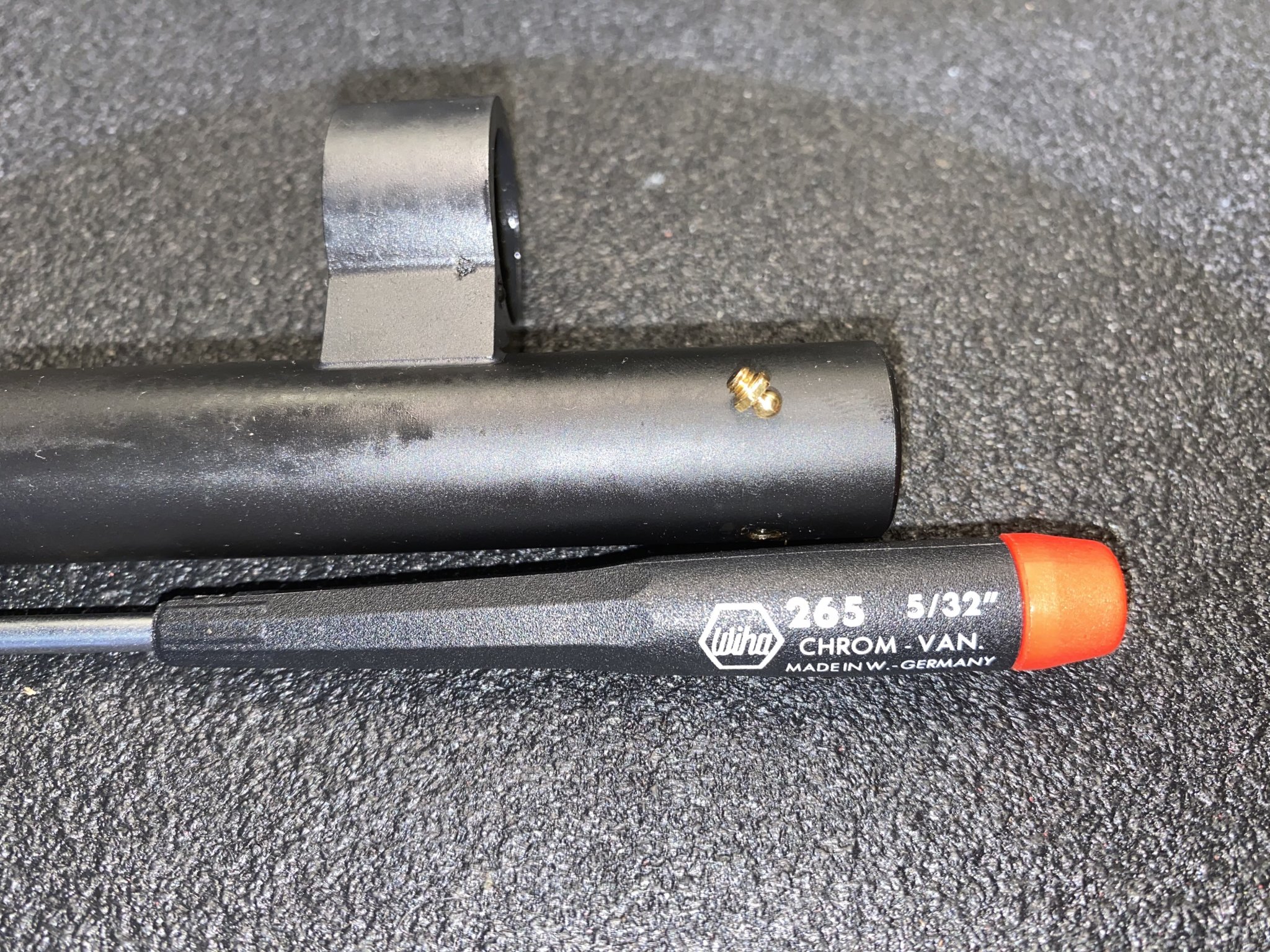

I love the WIHA stuff, have virtually everything in gunsmith size lane they make, like small nut screw drivers that are perfect for shotgun bead installation / removal. When the don't have just want I desire, I use blank wood Grace or Brownells polymer screwdriver handles to fabricate them. I use a variety of torque tools depending on the closest range for the project at hand. Unbelievably, I have not used my Fix-It sticks field kit but i did add some Wiha Torx-Plus bits that would be handy for my needs. Any time I see a hex fastener the first thing I do is replace it with a Torx fastener, misery eliminated.
