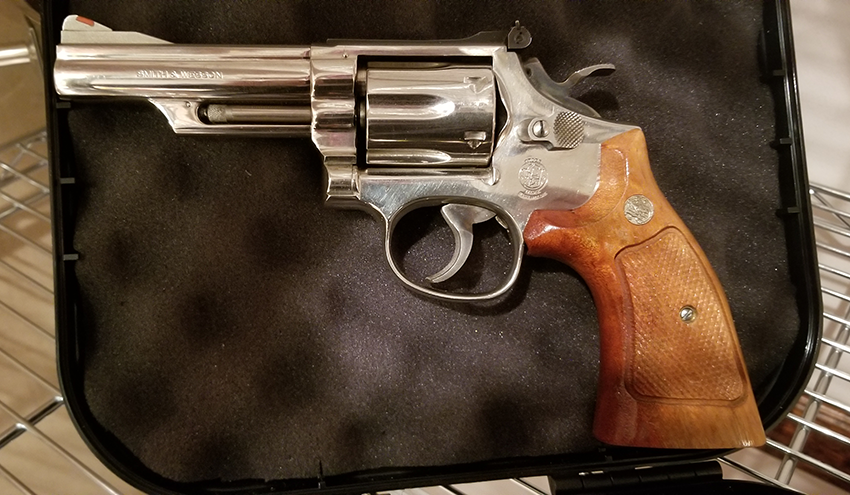

I found myself making a home for yet another orphan, whose former owner had to put it into the "pound" because he was going into an old age home.
It just looked at me pitifully, and I couldn't say no.
You're thinking, no doubt, that this was quite the departure for me, hater of all things Glock.
No worries. Glock doesn't make pinned and recessed Model 19s, especially not cherry ones in nickel.
I think that I shall call this cruel bitch of steel and wood ... Nancy.

I'm more partial to blued steel but any S&W from a period before "locks" is a thing of mechanical beauty to me.

Had one just like that. Loved that pistol. I gave it to someone and regret doing it. I've given a lot of guns away and that's the only one I regret.
You're reloading now, right? Downloading 357 brass to 38spl pressure will be good for the pistol and leave the cylinders clean vs shooting 38's through it. I wouldn't shoot too many, but 158 semi jacketed over full charge of h110 will bring out the beast!

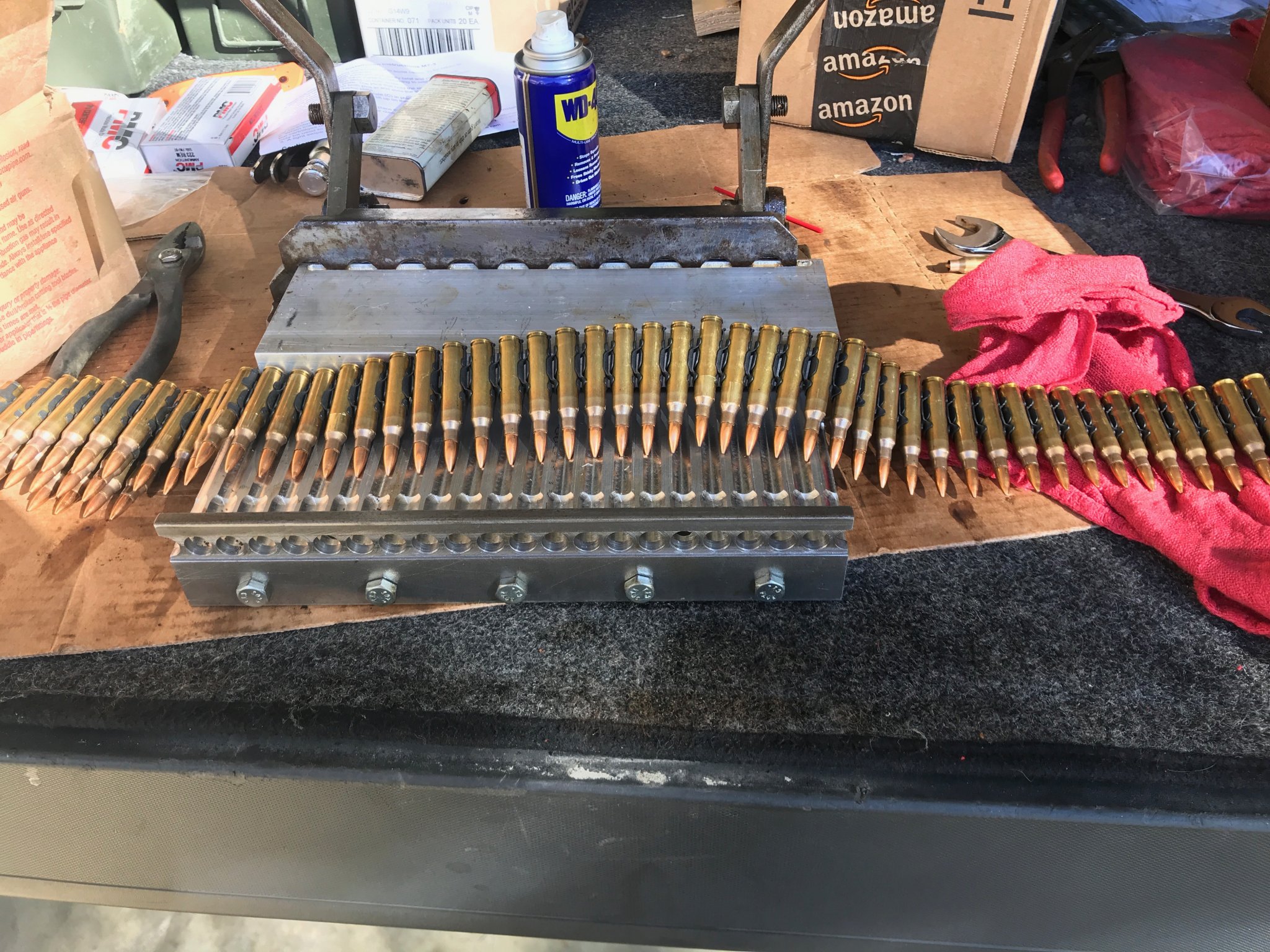

I put together a 5.56 conversion plate onto an M7 linker. Getting all that cosmoline off was a bitch! Finally got it put together. I still need to get the 7.62 put together but some of those cold war bolts are stuck and soaking in Kroil.
Now to link all that ammo @ArmyJerry coaxed me into buying and hopefully Saturday let her rip!

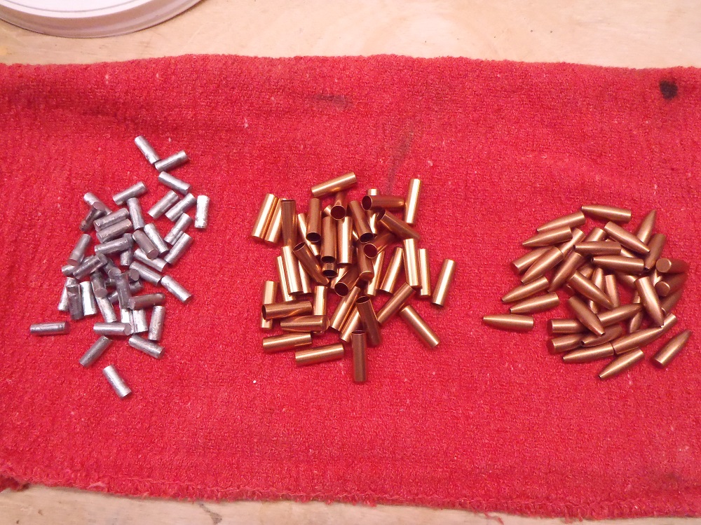

Searched the PX, found and purchased another WFT trimmer and 500 LC brass. Made a list of .224 AR and .30 SMK projectiles for near time purchase. Set up the 5.56 assembly line and knocked out about 150 rounds. Gave some thought the the .308 project, still looking for a load. Looked at all the SA 700's, considering a .223 varmint build, need a donor action. Taking the eldest grand daughter on a P.dog safari spring of 19, that will keep the mind (what's left of it) occupied.
If I get bored, there's several thousand of these things that can get made:PB080339.JPG
.224 50 and 55 varmint bullets.

Are you making your own jacketed pills?
Do you have a homemade staging process?

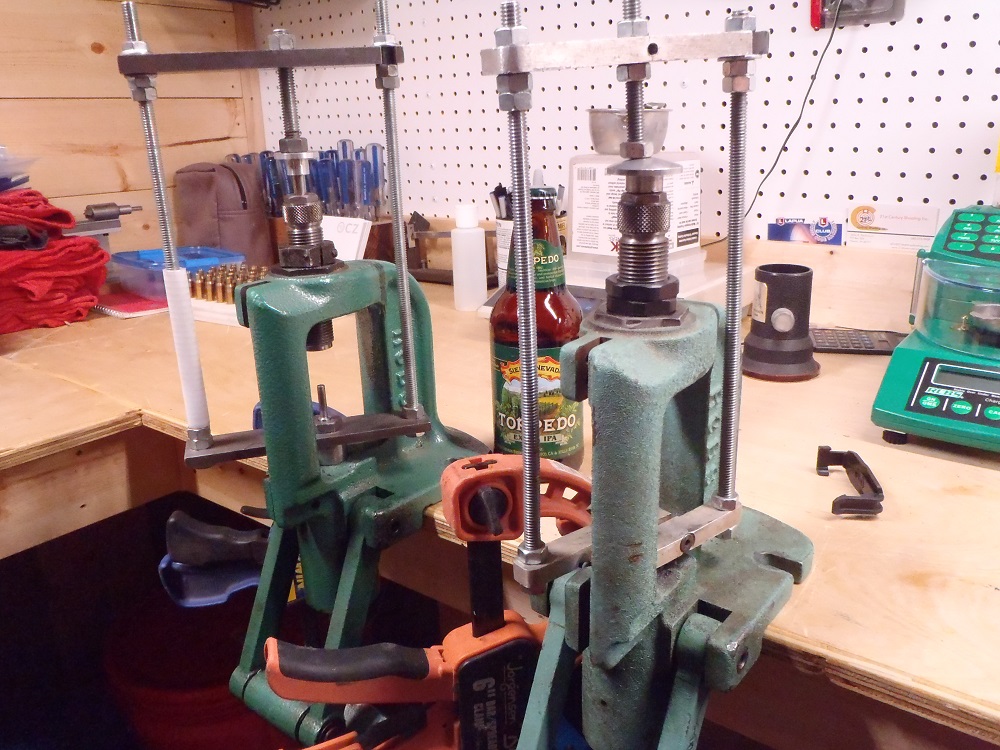

Yes, as a matter of fact, I do

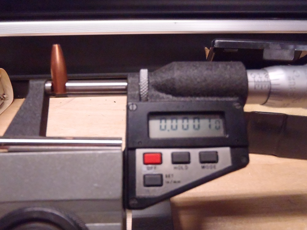

Left is the core seater, right the point up press. These are old Don Rorshach dies purchased used by me about 1998. He was one of the first guys to start cutting carbide for bullet dies. By today's standards their are rough in the inside finish, but make really good bullets. Pointer makes a 7S tangent ogive point which is very easy to tune. The ejection pin is .062, I've modified it so the bullet is ejected by pushing on the core, not the tip. This yields a nice .065 open point. I've driven the Sierra jacketed 55's at 3800, pure splat on critters.
Pressure band of .0001" over diameter. I use Sierra .705 for 55's, J4 .705 for 50's. Sierra's usually have runout of .0001-.0003", J4's a little less. My guns can't tell the difference. My last lot of J4's had less than .0001" runout.
Swaging is fun, but not really cost effective. I could replace a lot of barrels with what is tied up in the gear. Doesn't mean I'm going to sell them.
If you have any questions, shoot a a PM, we'll talk.
That's funny, I used my NON converted linker to finish off a 200rd. can of API! Handloading for the M2 is certainly cheaper, but it's a LOT of work. And you can blow through a day's work in a minute. But the giggles are worth it. Too bad they don't make an oversize 1050 for loading.
I saw an automated linker for sale, I couldn't afford it but it made me wonder who did buy it. That guy has to be going through serious fucking ammo to need that.
Boiling water dissolves cosmoline pretty well. Or rather, turns it into oil that floats. It's the only way. That or a pressure washer. Yours is all shiny and shit, mine looks like a cast iron skillet.
