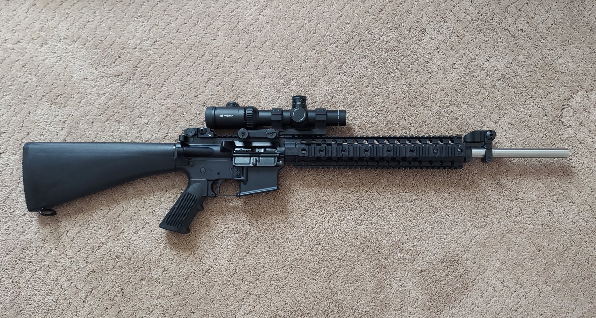

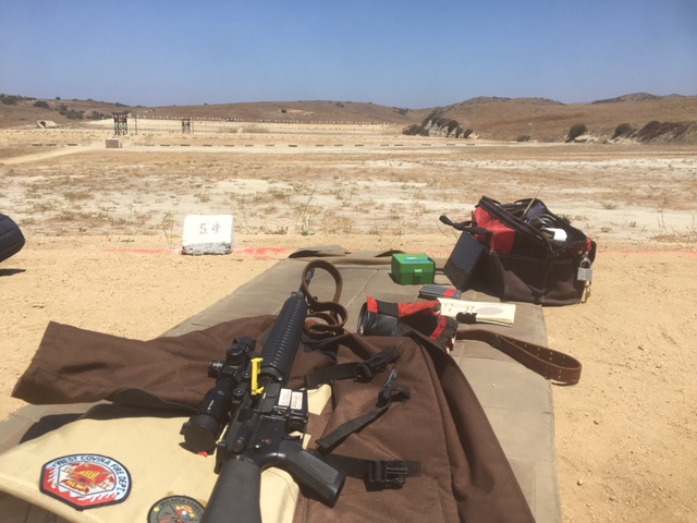

OP, the pic below will give you an idea of what's allowed under the more recent CMP rules . . .
Optics are allowed these days, up to 4.5x scopes, weight of the rifles is down these days. I still have my original upper with irons, 1/4 elevation and 1/2 windage and it shoots fine. I do not shoot much high power these days, maybe once or twice a year and Garand matches for fun. Leupold and Nightforce make the top end of the scopes but other makers are stepping up with good repeatable adjustments that will not wear out with extensive use.

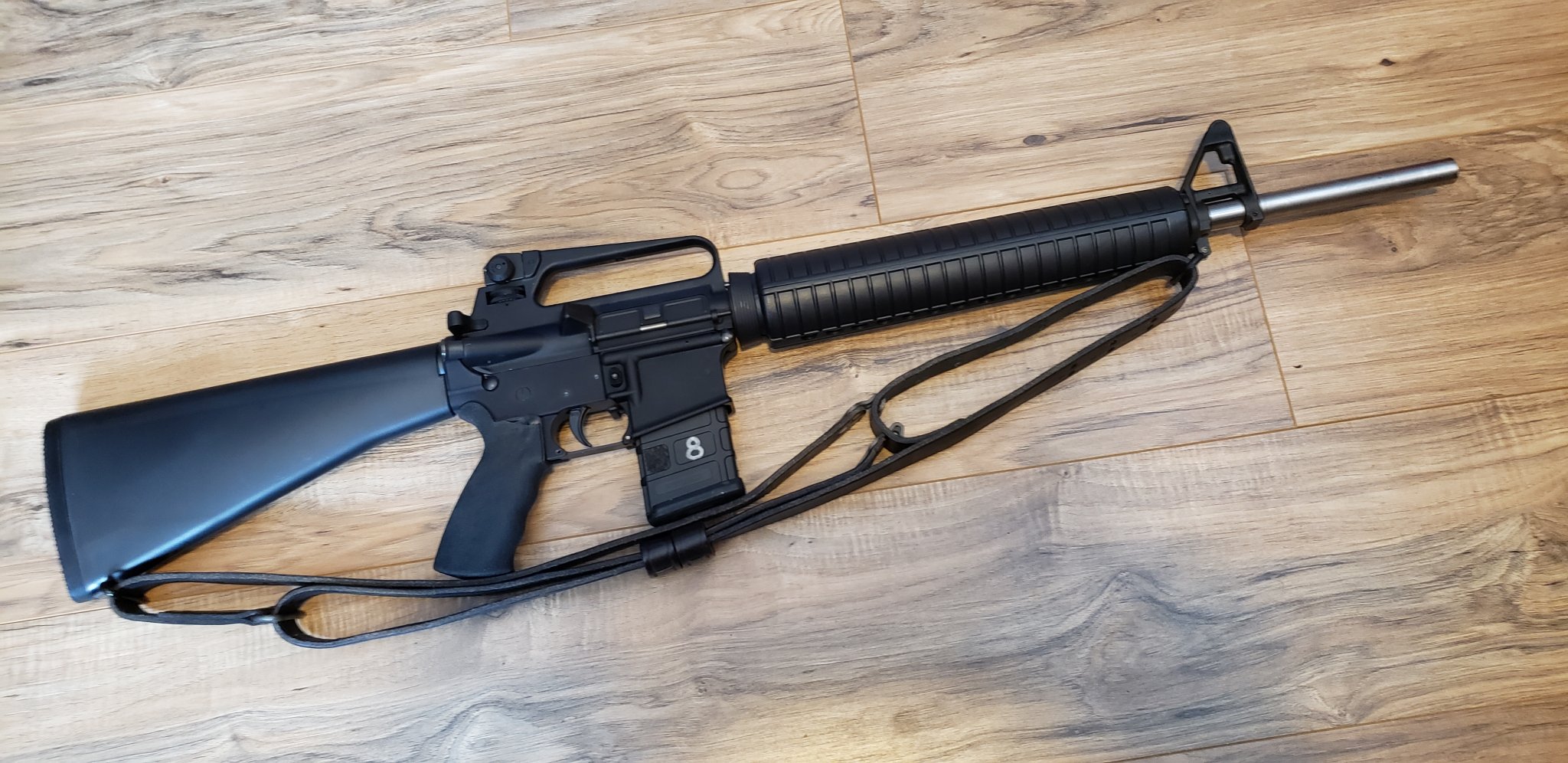

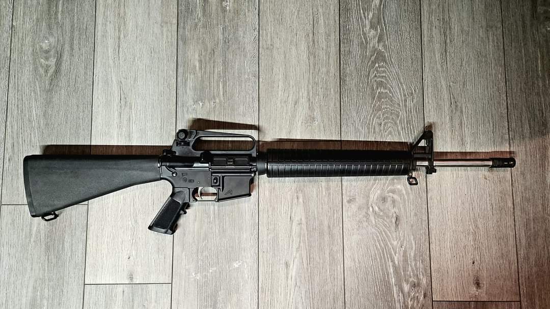

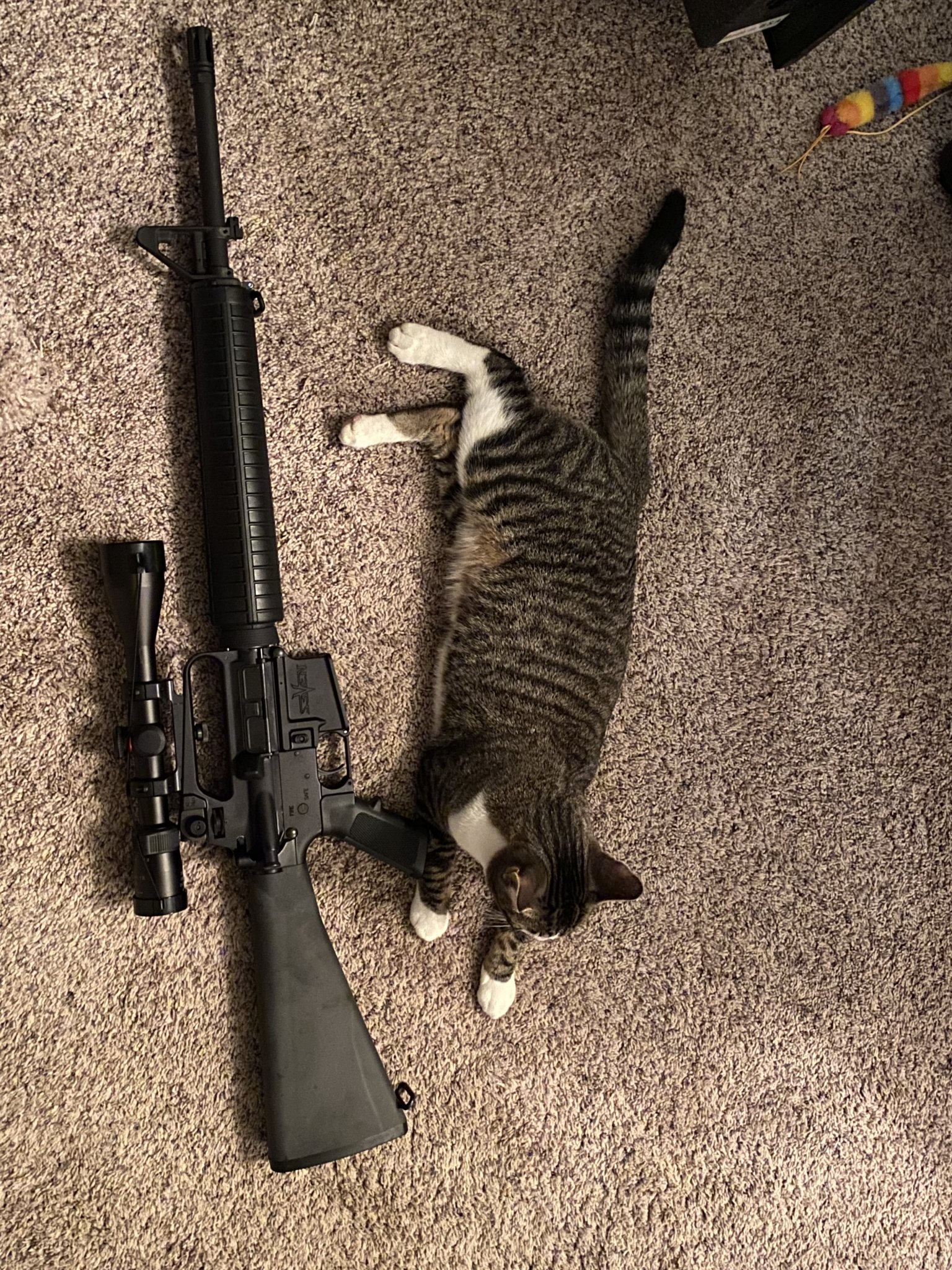

Definitely Compass Lake for the front sight you can send your upper to them for installation that doesn’t deform the rifling see the attached article. I also bought the Compass Lake National match rear sight much more precise and finer adjustments too. Their float tube setup is awesome my favorite if your not installing a Rock River nothing wrong with their products at all. The challenge of the old school open sights is fun while I still have the vision for it and I love seeing people freakout when I hit clay pigeons at 200yrds with open sights. Checkout creedmore sports for high power stuff and Derrick Martin’s The Complete Guide to AR-15 Accuracy it’s old but still applies. I was lucky enough to have Derrick do a custom rifle build before he retired it’s outstanding. The scope on my rifle was just for load development I recommend the DNZ mount for that purpose the others I’ve seen are junk. Have Fun! https://www.creedmoorsports.com/
Reactions: 806guns

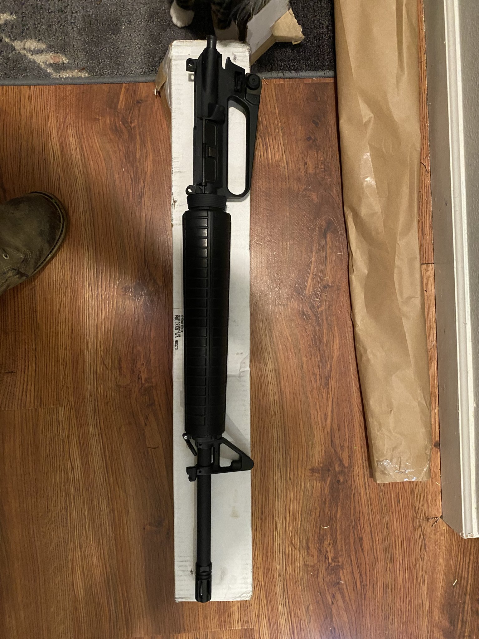

I agree. My favorite varmint barrel was a WOA amd when i found a complete upper i jumped on it. I will post an update when it arrives

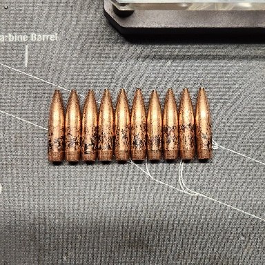

I bought some pulled 77gr smk from American Reloading. Whats the best way to ge the tar sealant off? Dry or wet tumbler?
Jeez, trigger discipline in high power is as bad as in the shotgun sports…
When I had thousands of m118lr bullets with tar all over them regular tumbling didn't work for shit and I wound up using paint thinner. They shot great. I also loaded up plenty with the tar still on them and they shot fine too. One thing to look for is little burrs in the bullet jacket from how they are pulled. Every now and then I'd find one.
That's the only way. Scopes don't belong on these rifles View attachment 7980251
