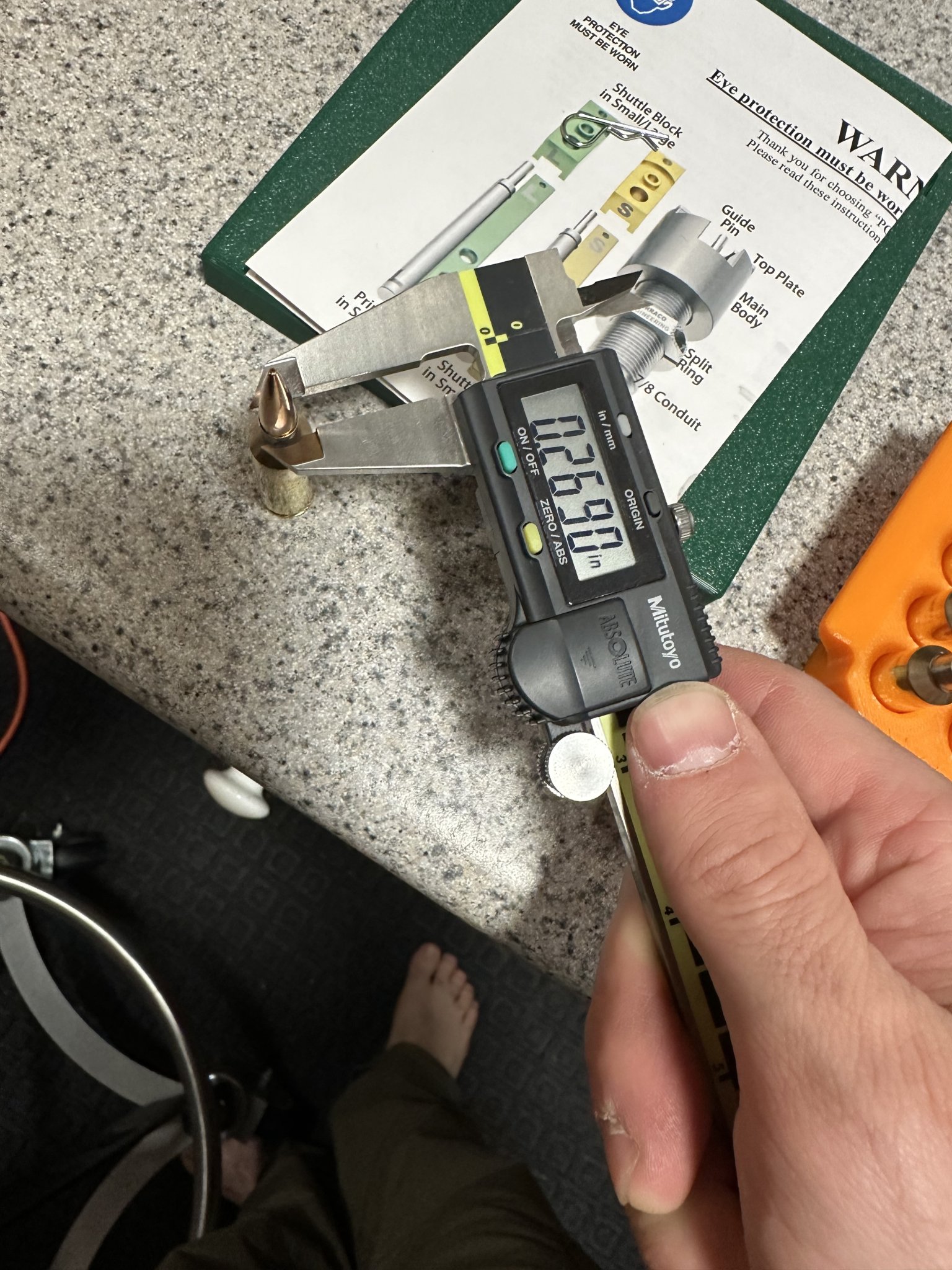

Probably a long shot, but hoping someone has a neck dimension of a loaded round using the following:
6 Creedmoor
Alpha Brass
105 Beger Hybrid
I am needing to order a bushing and being the idiot that I am, I have shot all by loaded rounds before thinking about it...Thanks in advance for your help!
-Ric
This is 5 times loaded now.
