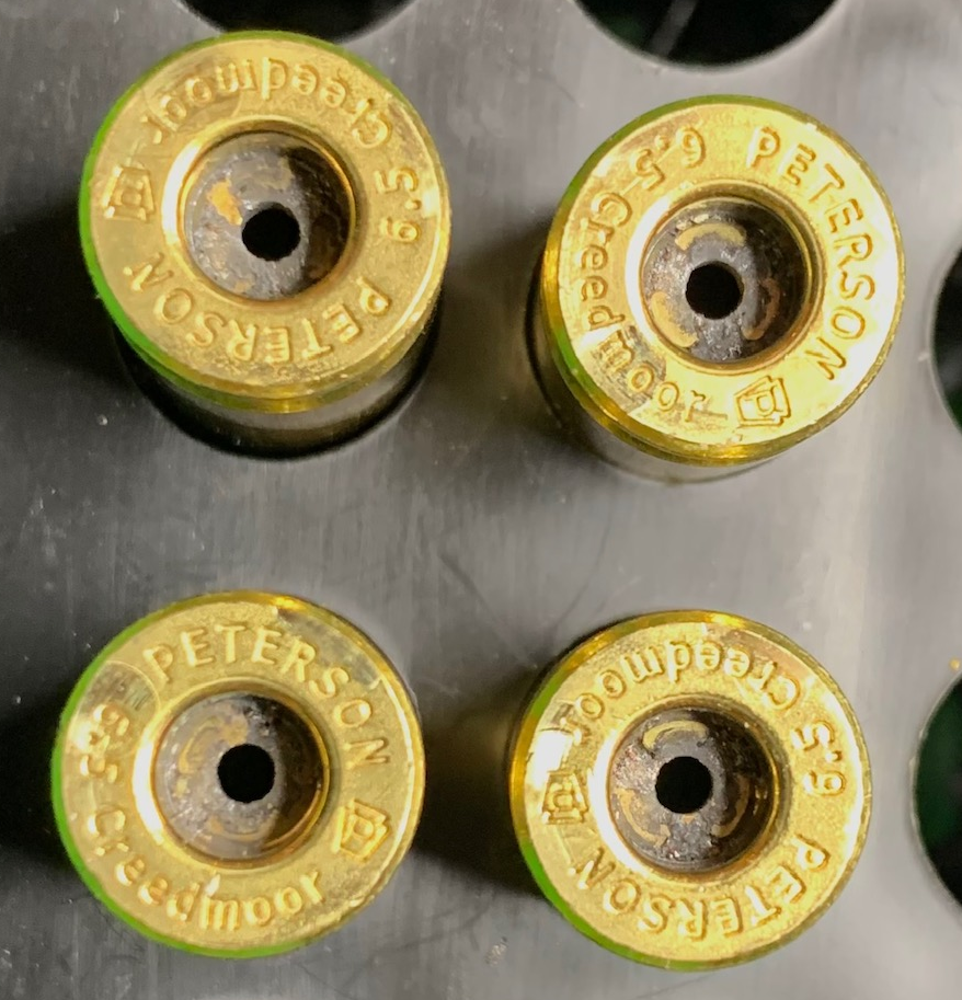

    Can you post a picture of the pressure signs?
    Heavy bolt, ejector swipe, ejector print ... that's what I'm seeing.
