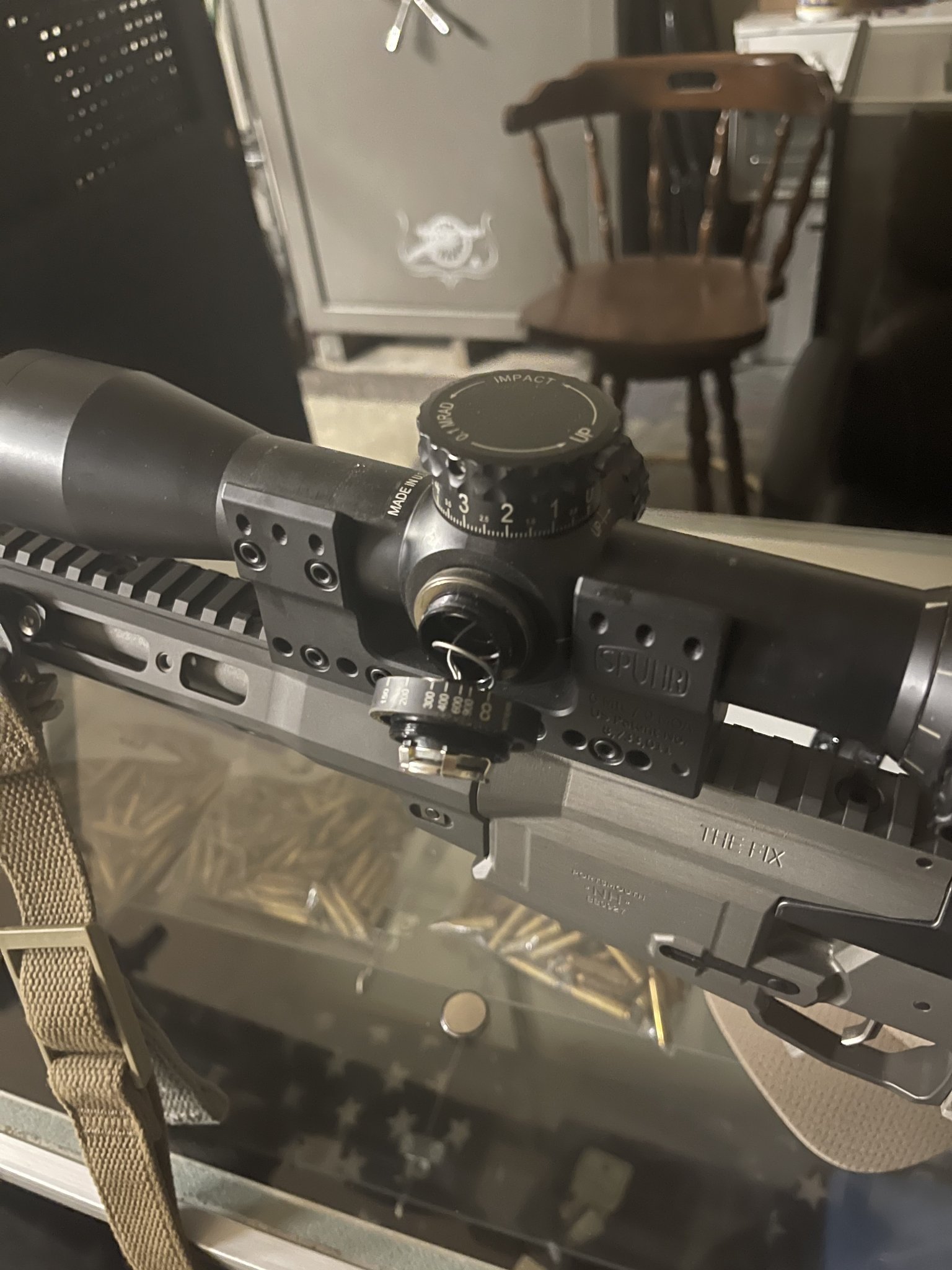

I have one on my AR10 and love it…
also recently grabbed a NF NX8 demo from Eurooptic recently for one of my 5.56 uppers, and it looks very promising with nice glass, etc., but haven’t had a chance to shoot it yet.
After paint:
Subtle … LOL
You have to tell me more about that paint! That’s bloody sexy.
And just to be clear, that’s the 1.1-8, not the 1-8? My only hesitation there is the how the reticle looks at 1x; I’ve read you almost can’t see it. Can you confirm or deny please?

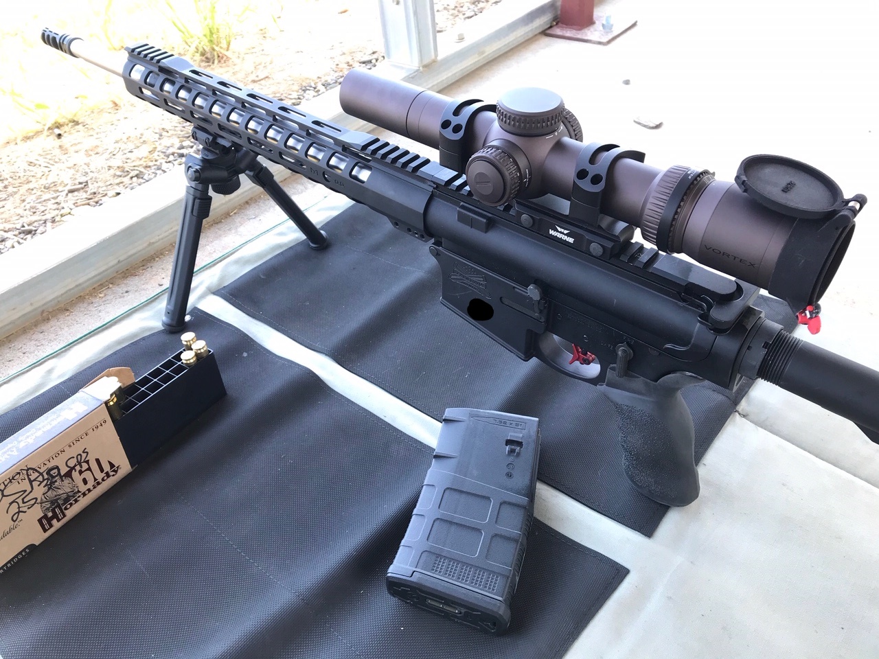

With any of them you should be fine at 500 yards with a little work so honestly get what you want. I would hate for you to get something you don't want and not be happy but the 8-10x LPVO market is very good now. Take a look at the video posted above by 5RWill as those are the 4 I would be looking at in that price range anyways. It gives a good idea of the scopes for close and long shooting as well as the reticles. It should help some to decide.
To give a size reference here is a 1-10 with the sunshade on on my 20" .308. Take sunshade off and the end is right where that heavier line is on the end. Mine is the MOA reticle as I like the BDC in it as I was used to using the JM-1 in the 1-6x.
Sweet! Thanks a bunch. I feel like I’m finally narrowing this down.

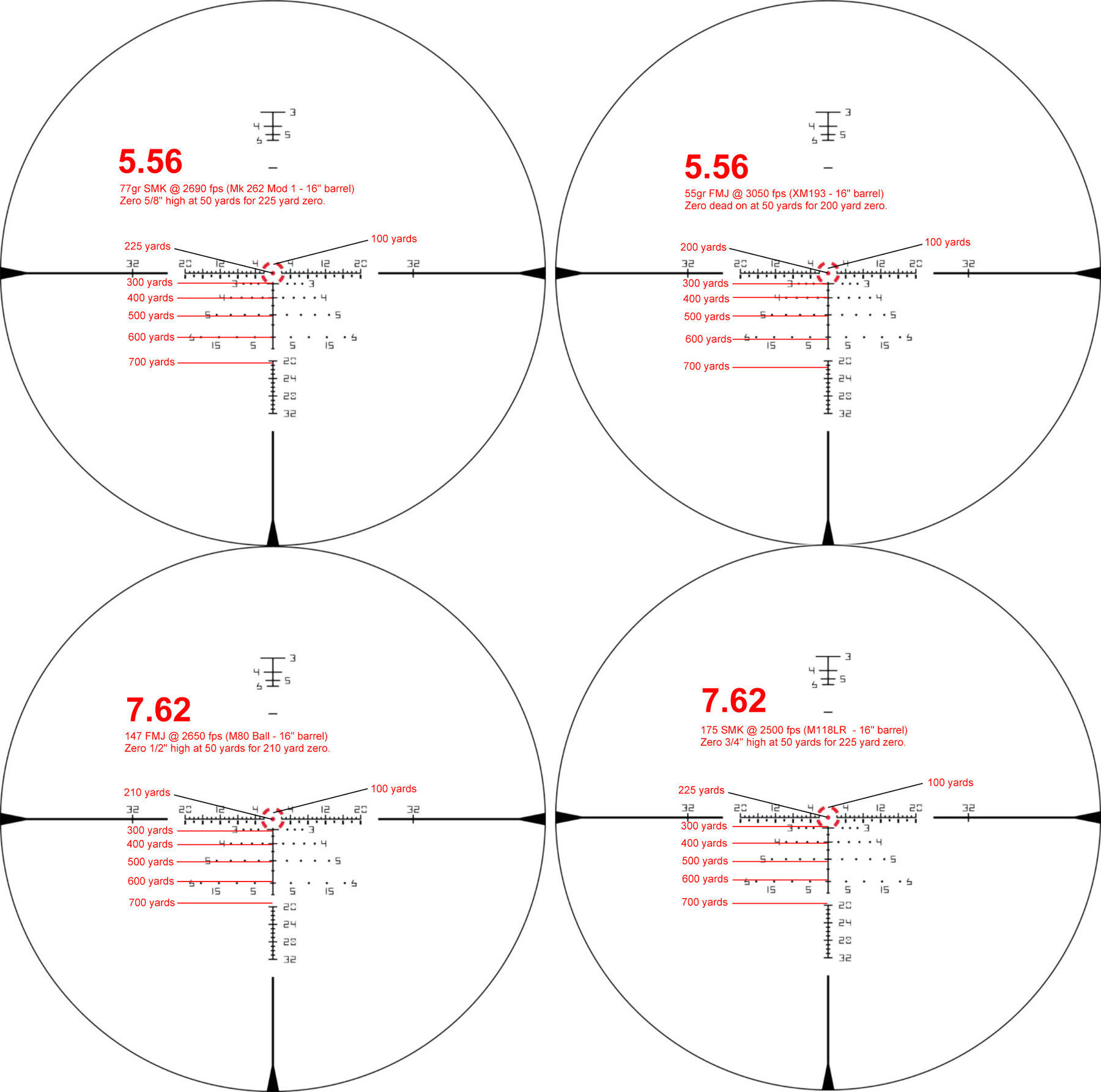

It sounds like you want the easy button on intermediate range. That's probably the razor 1-10. Like the guy above said I don't love it but it gets the job done. If you're like me and want to shoot to 5-600 consistently without really putting the work in the bdc version works well within certain parameters and 16" 308 happens to be one of those.
I think it was Stephen that posted this in another thread.
Very simple and put one of the new affordable commercial clip ons in front of it and now you have intermediate nighttime covered as well. Putting together a functional day/night setup is getting a lot simpler and cheaper. One thing I would recommend with g3 is that if you shoot with your stock in and ntch get an extended cantilever. The Scalarworks doesn't get it far enough forward for me and I'm going to swap it out for an adm 3" offset.
Thanks. I appreciate the explanation of the reticle, it really does seem right for me. And thanks for the info re: Scalarworks, it was on the short list for a mount!

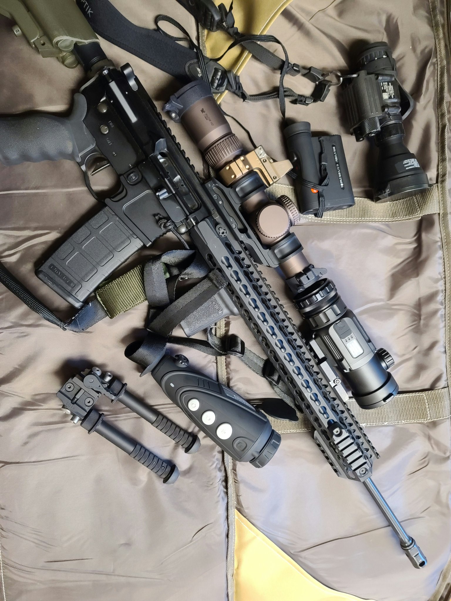

BTW; what brand is that Red Dot?
Leopold delta point pro NV. It's a place holder until it's clear weather or not aimpoint got their shit together on the p2. If not I'll do a t2. It rains/sleets/fogs too much here for an open emitter and I wouldn't do one on a long gun again.
It's for passive nighttime shooting. Imo the eyebox on the g3 is nice if you get the eye relief right and the illumination is nuclear bright so with some reps you really don't need a dot unless you're shooting at night or clearing rooms or something.

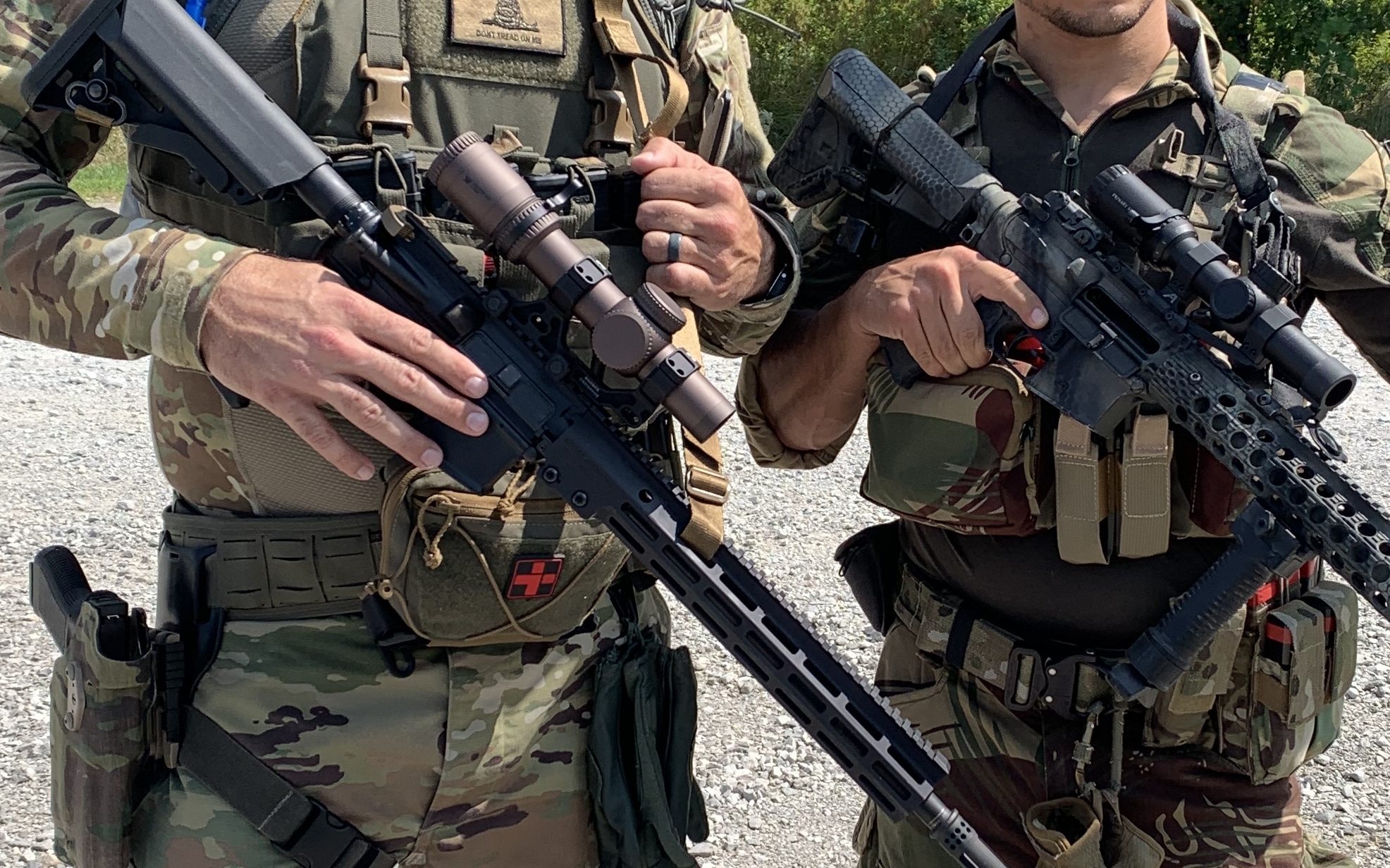

Another idea of size, here is mine in a 1.93 Badger Condition One. Rifle is my version of a URG-I, 14.5” with a War Comp.
Other rifle is a Strike Eagle 1-6. His has that newer BDC they are putting in ACOGs. He did almost equally well points wise that day with mixed store bought ammo. (He smoked me in the run)
As Rob said, lots of good choices. In the end, it’s the Indian not the arrow.
FWIW, I ran the numbers in my go to load before competing. 77gr SMK over 24.4gr RL15. Runs right at 2550 in this 14.5”. With this scope zeroed at 100 yards, each hold over is 100y off. I.E. The 3 line is 200y, the 4 line is 300y, etc. the 20 MOA hash is 600y. Not ideal for stress shooting but it works. We proved on IPSC steel that IMI 55gr FMJ is close enough to 500 yards to the load above that it’s interchangeable on the half sized steel to 300+ and full size at 500y. We only have Full sized and poppers at 500. At 7-15 yards it also indistinguishable.
Reactions: LRRPF52
Nice. I like the Rhodie camo btw!

Yes, it’s the 1.1 And if you can tell the difference between that and a true 1:1, you have better eyes than me! I really like the view in CC (CQB) mode…though a bit of fish eye type distortion, but again, that could just be my eyes.
