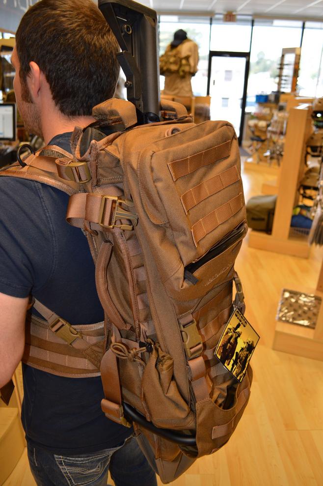

    What about an ATS RAID pack? It has everything on your list except it isn't a top loader, it's a panel pack. I've actually got an as new Coyote Brown Gen I RAID with internal frame sheet that I am looking to sell.
    I actually had looked at the Raid 2 and know it can have that framesheet they make put into it; thing is, how is the padding in the shoulder straps and how does the bag hold up to 40-50lbs being carried in it?
    If its the one I just looked at its 2800CU and has a rifle scabbard; that would be WAY too large for my uses.
    It is but you might want to give it another look, it cinches down pretty small, so you always have the option to put more in it if needed.If you're not using the scabbard, it tucks away out of sight completely.
    The padding in the straps is a little thicker on my Gen I RAID than the newer RAID II pack. It's been a while since I've used it, so I'll pull it and a scale out tonight to see how it feels with some weight. I'll let you know how it goes.
    I put two 500 count cases of 5.56 ammo in the RAID pack to mock up a heavier load (scale read 32lbs with the loaded pack on it). I cinched the boxes down with the internal load straps which made it very stable. The 32lbs. felt fine on my shoulders and the area of my lower back where the pack rested. The straps are sufficiently padded as to not dig into the shoulders, and the frame sheet that I added to the pack helped stabilize the heavy load. For a pack in this size/style class, I think the RAID is about as comfortable as it gets before stepping up to something with a belt system and fancier back padding system (i.e. a larger Kifaru). The Kifaru Zippy looks to be about the same in design as the RAID, at least as far as how the load is carried. Stepping up to the Kifaru X-Ray might get you a more comfortable ride with a waist belt.
