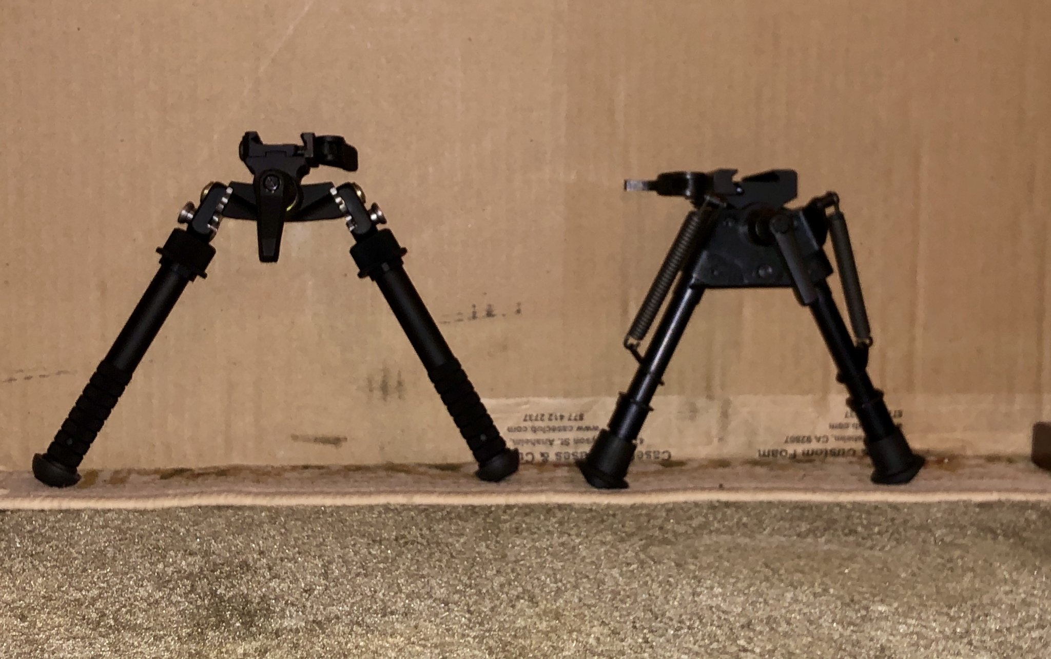

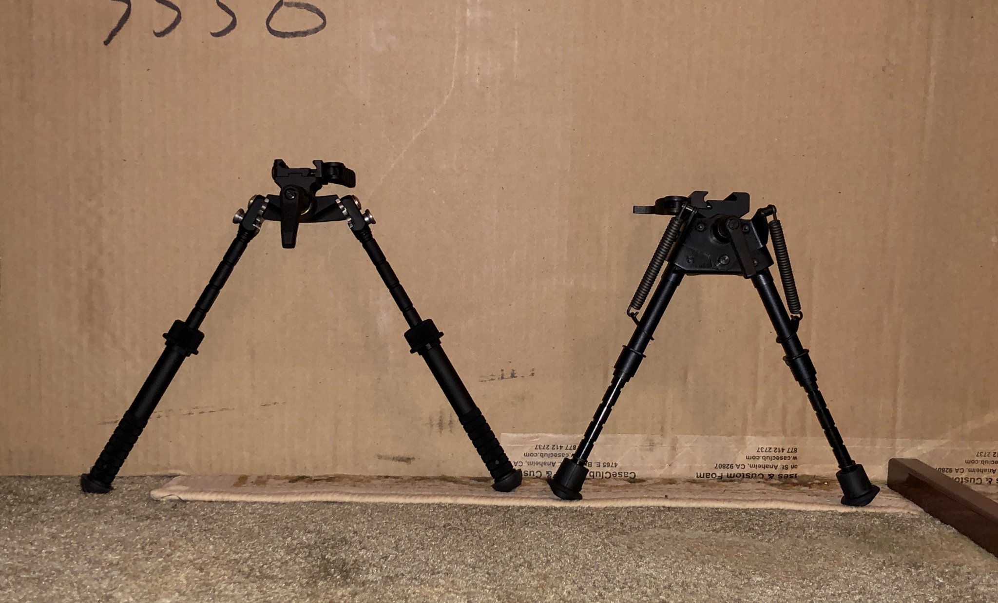

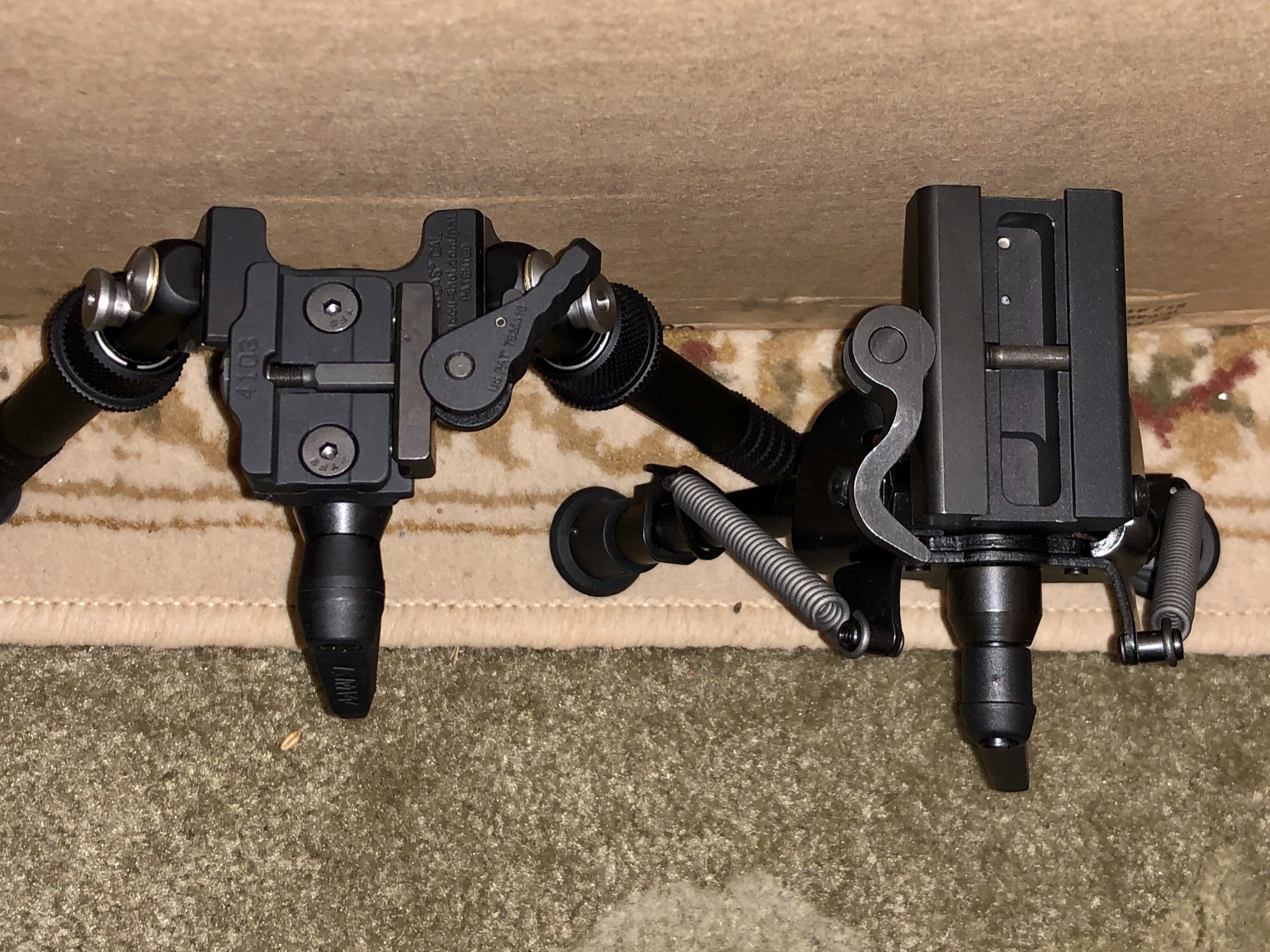

Just for quick eyeballn’ this is an LMT Harris style vs AtlasCal. Scal possibly best stability just wider when folded if cased instead of bag.

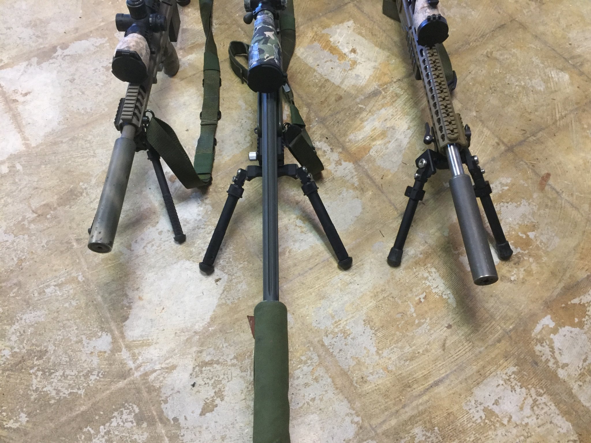

Super cal is huge and works. The Cal is smaller but still works.

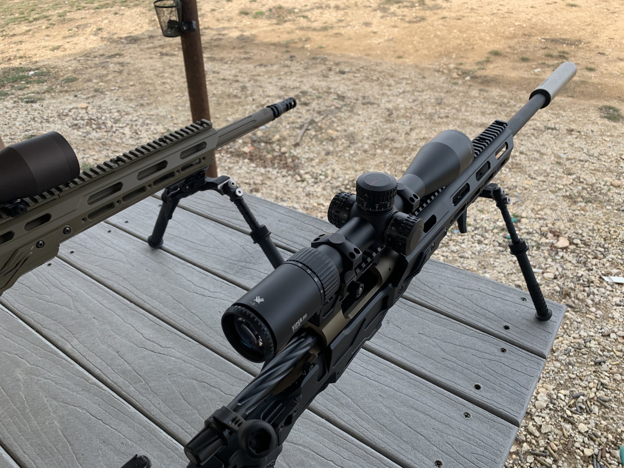

Why it gotta be black?......
Anyways....I run a CAL on a 25lb 300 PRC and it does just fine.
That’s got to be a pussy cat to shoot!
With an APA Lil' B on the front end....it's shockingly lacking in recoil. Also, not that much flex in the Atlas CAL when loading either...it hardly moves.

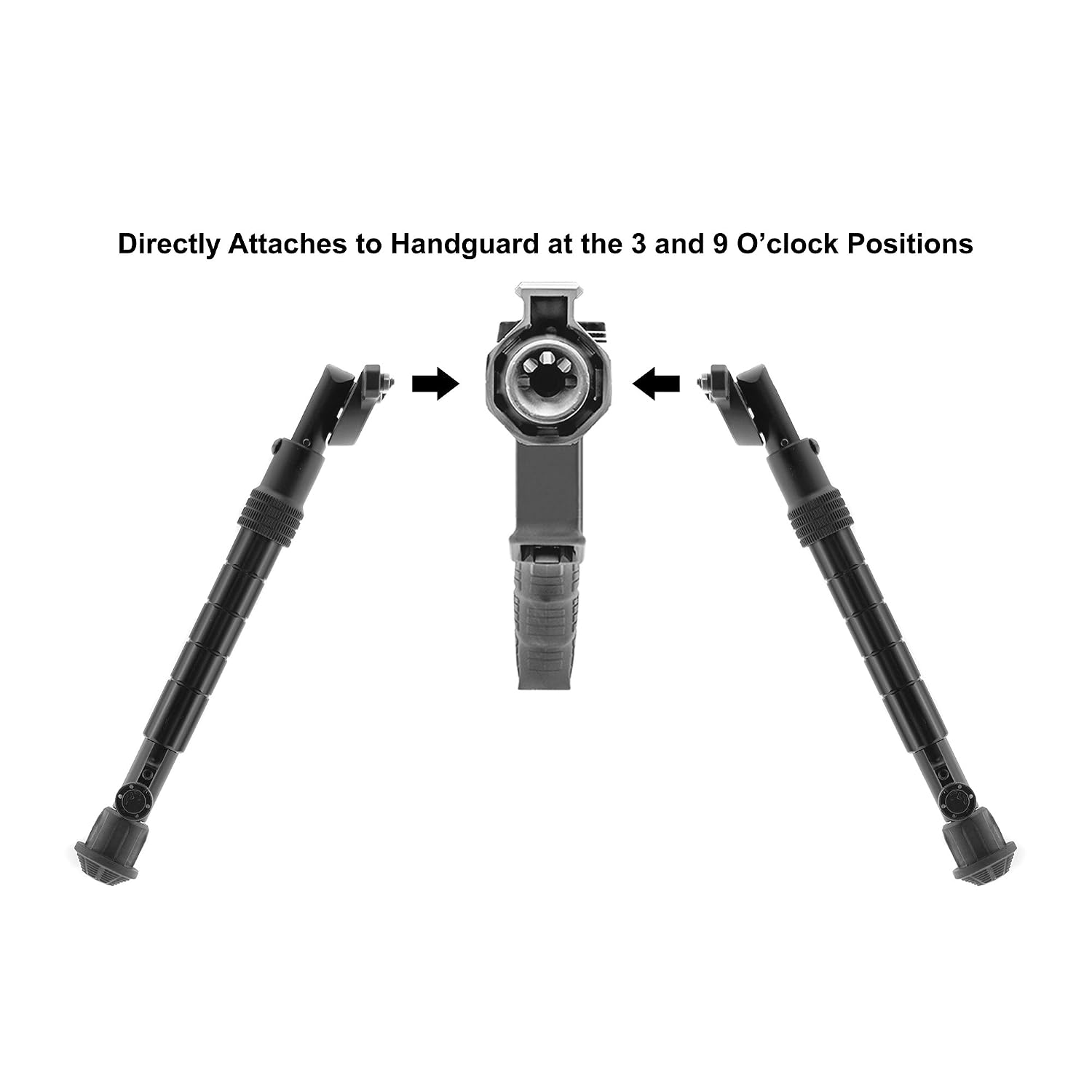

I've chosen one from Column B. It isn't exactly what you asked for, but I think it's functionally acceptable.
UTG Recon Flex 8"-11.8" M-Lok Bipod.
or
UTG Recon Flex 5.7"-8" M-Lok Bipod.
It has no cant. It's both strong and rigid. You adjust the leg length to adjust cant.
It doesn't detach but mounts directly to M-Lok slots on the sides of the handguard. This means it's not going to get lost, yet it's still out of the way for shooting off a flat surface.
Rather than fumbling to reattach it, you simply redeploy the legs. It folds parallel to, and flush against, the handguard to stow, pointing either forward or rearward. It also allows 45 degree deployment, front or rear.
The short one weighs around 12oz, and the tall one around a pound.
There is no flex or slop, and it's very quick to operate.
The price, like all my recommendations, isn't going to break the bank. I chose this to try after reviewing LL's requirements for a tactical bipod, largely because of its wider, lower stance; with a mind to an economical approach to the requirements. It's not what LL calls for, but it covers enough of his bases to interest me.
Mine's rather new. I'm testing it on a PA-10 308, which is also rather new. So far, no signs of weakness or loosening up.
