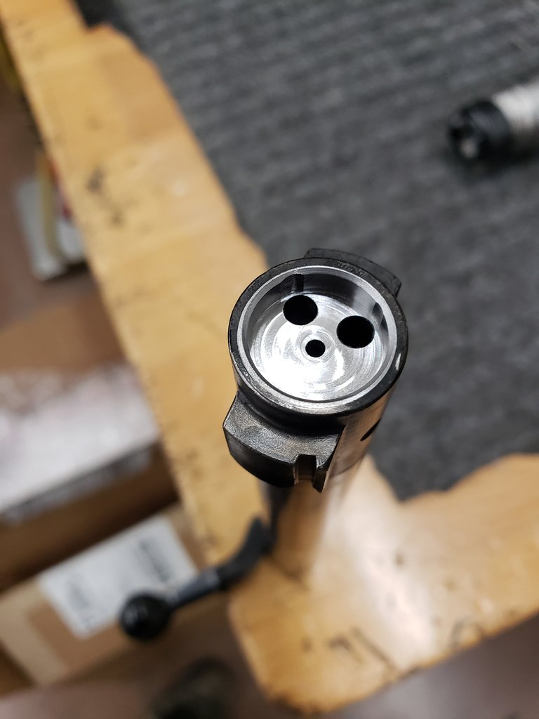

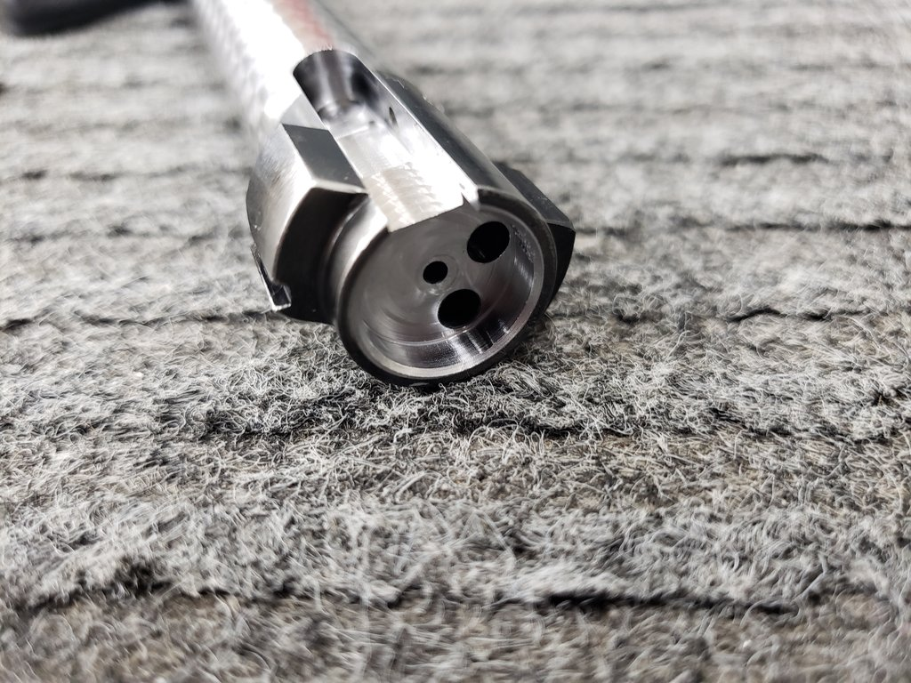

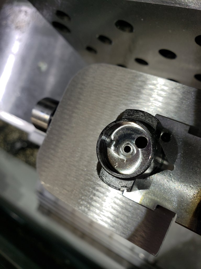

Ejection angle issue with M700's
"What we've done is add an additional ejector. We mirror it to the top side of the bolt face. Doing so restores the ejection angle so that cases will again clear the turrets. One small issue that must be dealt with now is the increased shell pressure from the additional ejector spring. Trimming a few coils from the spring solves this. The net result is a reliably extracting gun that will "punt" the case low enough to clear the optics. Trimming the spring length also reduces the "blast radius" of spent cases. -Helpful for "gamer gun" events where limited time is allocated for brass recovery."
Thread milled bolt nose about to be drilled for dual ejectors and have the bushing installed:
.480" bolt face with dual ejectors heading to the fixture for the extractor install.
.545" bolt face fitted with M16xtr and dual ejectors
