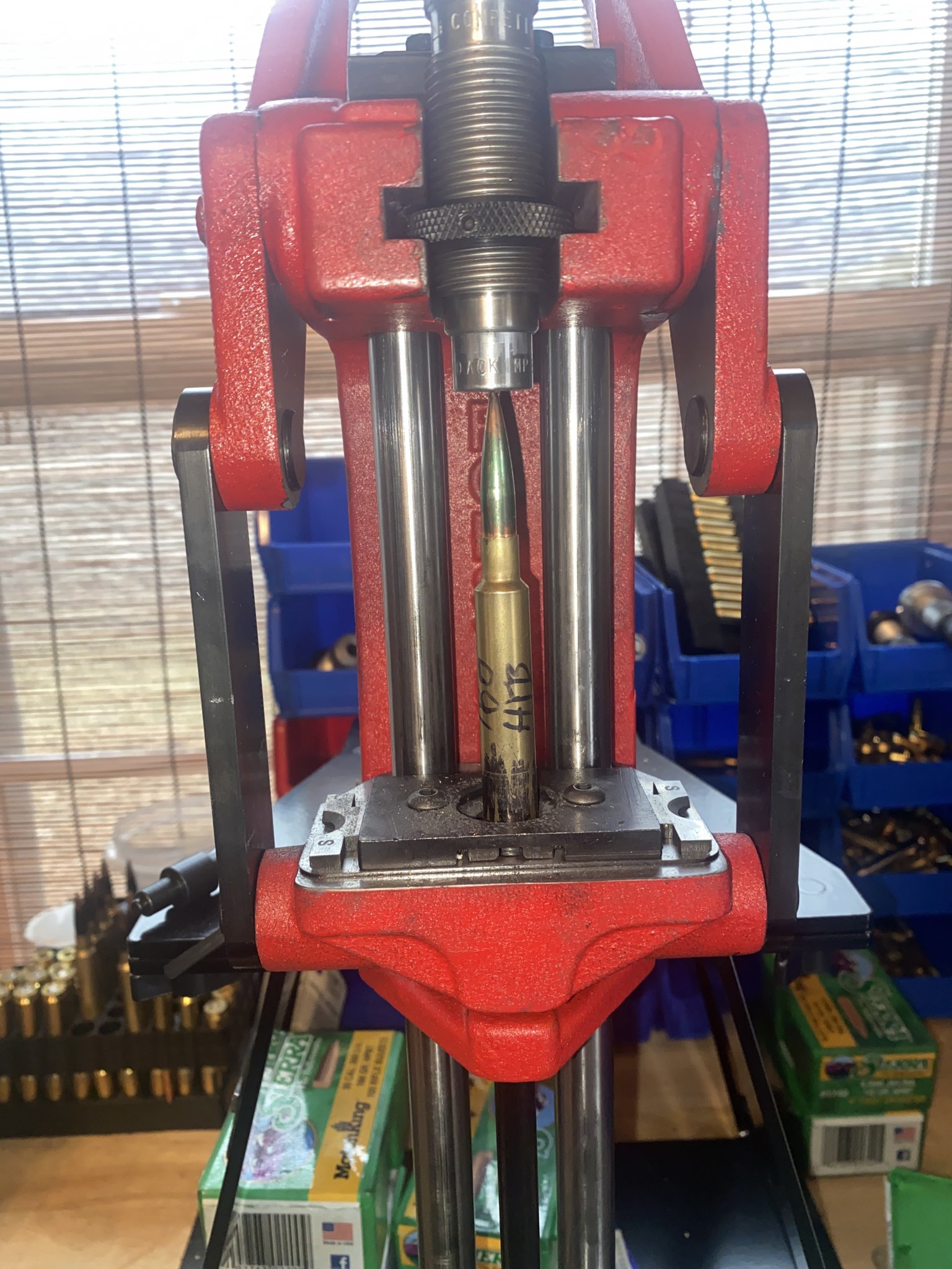

Here’s a 280AI with a 180 Hybrid and a Redding Micrometer seating due. OAL is about 3.64”. You do have to set the nose up into the seater stem before you can get it in the mouth. Never thought it was that big of a deal.
