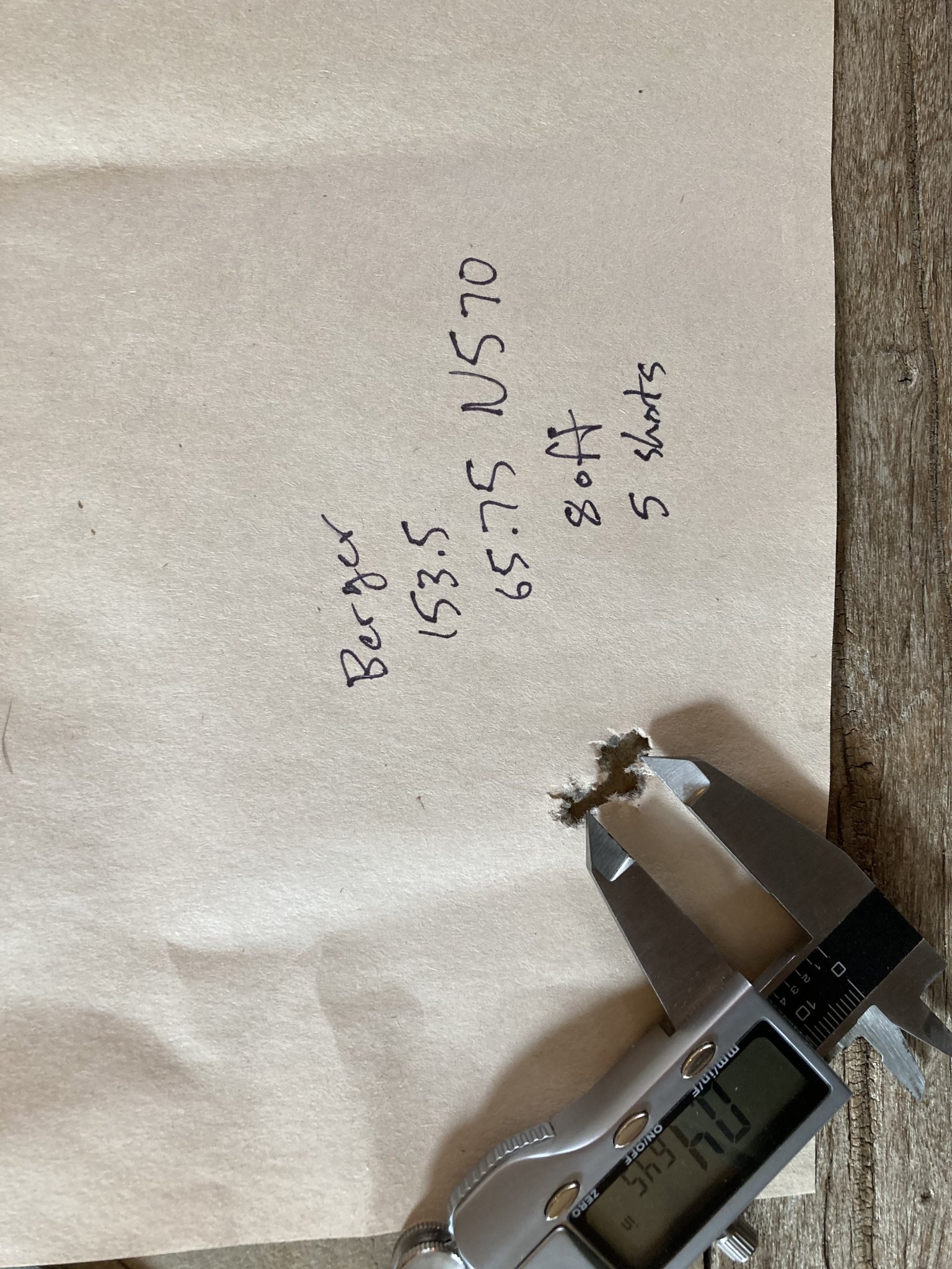

    6.5 Max on a Tikka. <3.1 COAL, 153.5's @3170. Badlands 135 solids shoot great as well - seating depth test below.

    6.5 Max is up there, I get 3170 with 65.75 grains N570 - same 153.5 Berger.
