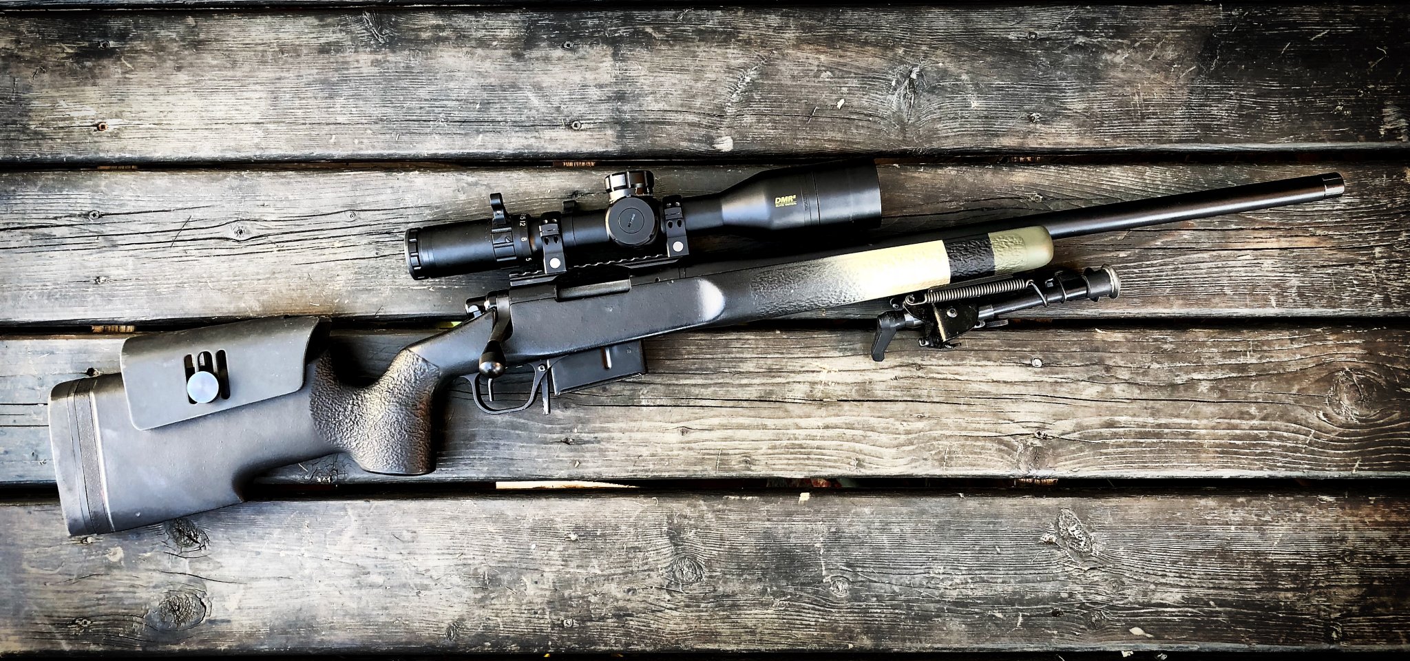

I’ve shot a few PRS style events with my 260 Rem and have had great results with the bullet components I’ve been using in my three 6.5mm rifles.
Near my place of residence, every month, a military base holds a precision rifle competition that only allows 5.56/223, 7.62/308 or 300 Winmag. So, I went ahead and bought a 308 to participate in these competitions. Max distance is 600 m (654 yards).
My question: which powders yield the fastest velocities using 175 gr bullets?
Related/required additional info: I’m using the following components and gear, rifle setup.
Nosler RDF 175 gr bullets
Hornady 308 brass
CCI BR2 primers
*Have a pound of IMR4895
Rifle is a Rem 700, 308 Win
22” barrel, 5R rifling, 1:10, heavy bbl.
McMillan A5, bedded.
ATRS rail and Nifgtfore ultralight rings.
If you need additional info, please ask and I will answer ASAP.
PS: Lease note that the only calibers allowed are those stated in my post so commenting that I should go with a 6mm or 6.5mm will be counter productive. Thanks for understanding. Looking for 308 related advice only
