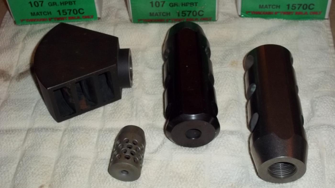

Take a look at the APA Fat Bastard brake. Not sure if they can make it 1" but for a timed brake it is one of the best. I have a Badger FTE on my .338 but I wanted something I could take on and off without having it timed. As far as the DBM it depends on the stock you choose to some degree. Badger makes a good system. That is what I have. Focus more on the stock than the DBM for now. If you end up with a chassis system over a stock you probably won't need a separate DBM. Ty to find as many different stocks/chassis as you can to try out. As MdrnBR said it is personal preference. I am a big fan of the Manner's stocks. I have 3 T4-A stocks but I am curious about the Whiskey 3 Chassis. For the bipod you have 2 choices rail mount like the Atlas or stud mounts like the Harris. Both are solid bipods. Again it is personal presence to some degree.
I would look at Wyatt Outdoors for the DBM, as they make the largest mags for 338 lapua. You can stuff a 3.790 COL round in them. Since you will be shooting long range you will be shooting the longer 300gr bullets and will want as long a mag as possible. I too am a big fan of Manner stocks.

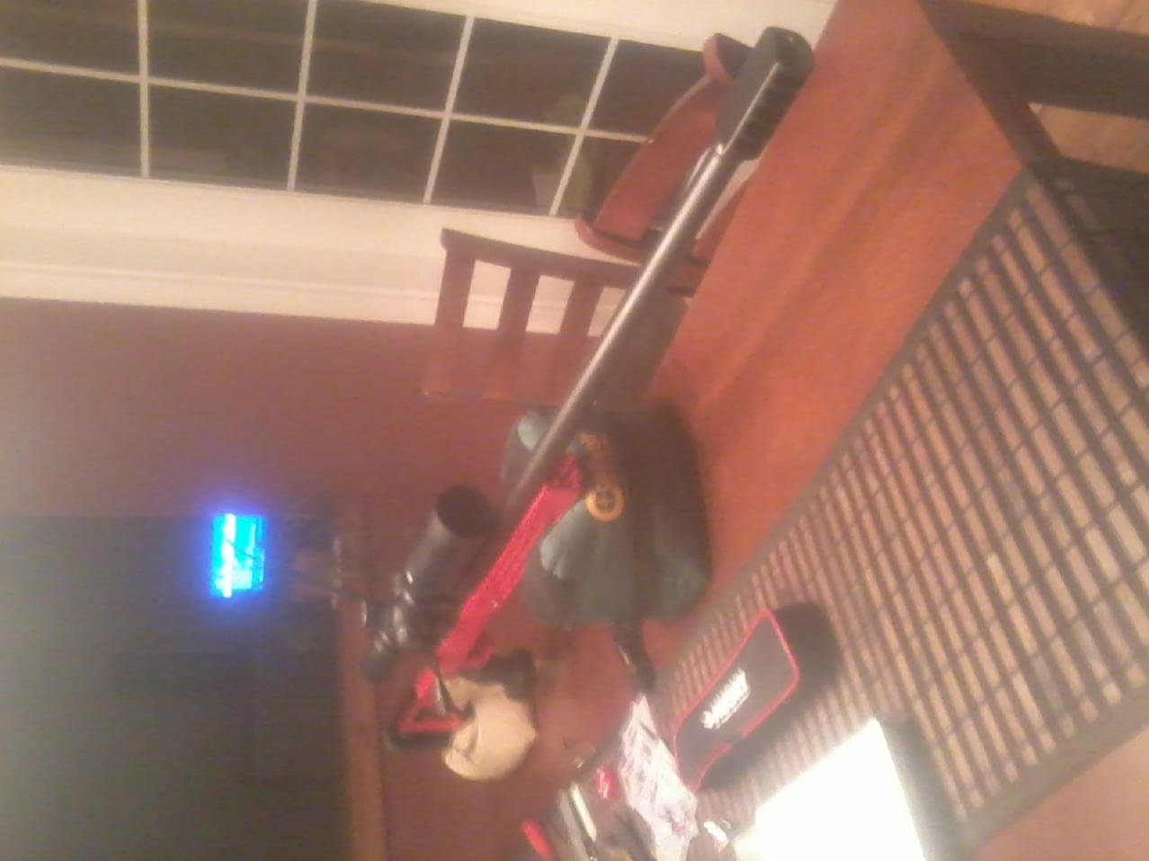

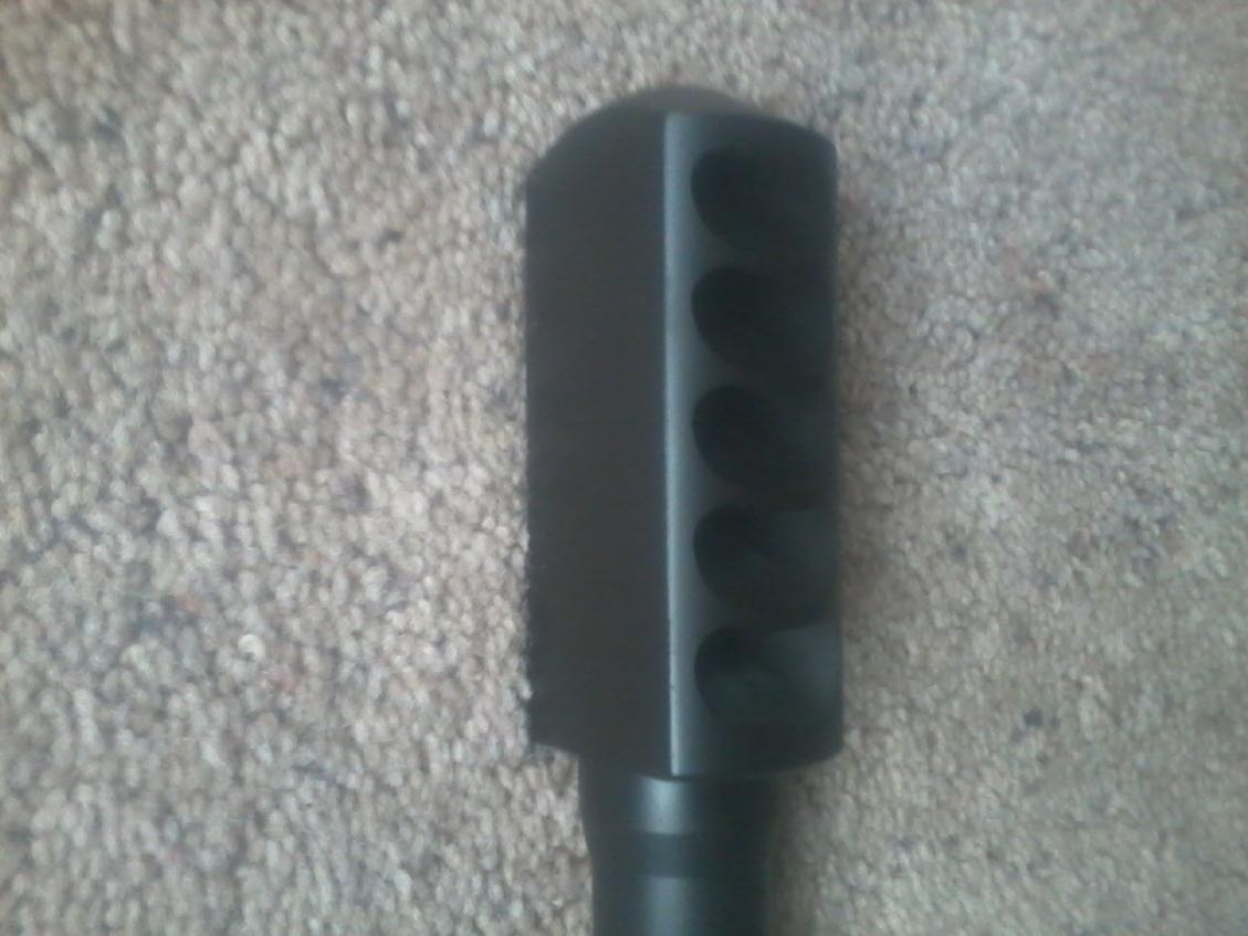

apa fat bastard is one of the more common brakes it seems anymore for the big magnums, i am using a aps painkiller on my heavy 338 edge and love it.
338edge4.jpg338 edge brake.jpg my barrel is a 31amu finishes at close to 1.0 at the brake
maybe you should run a chassis if your interested in a magazine setup. something like accuracy international. good luck and keep us posted

I would use a Robertson stock Wyatt bottom metal and a K-P clamshell brake.

1. Holland's, Muscle, or maybe APA for what you are wanting.
