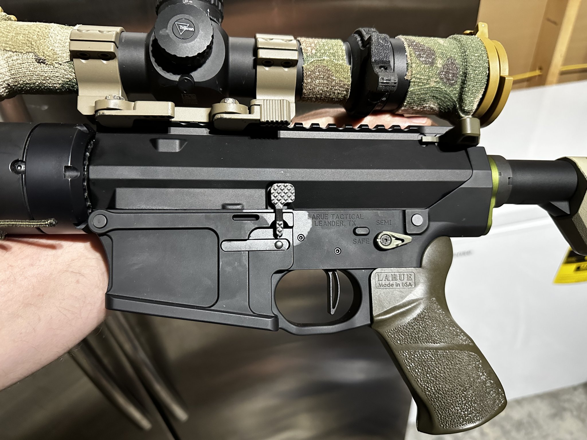

I’ve got a 16“ PredatOBR in 308 Win and I’m looking to buy/build a 6.5 Creedmore upper for it.
Obviously, the easiest thing to do is simply buy a LaRue upper in the caliber I’d like, but I do love building my own.
Any suggestions for uppers/handguards/BCG’s that are compatible?
I was thinking of getting a Bartlein/Kreiger/Proof barrel if I was building it myself, and I’ve built tons of AR rifles, so I know what to do.
Thanks

I was going to just get the 22” Larue upper for $1599, now that they are $1999 I’m reconsidering. At this point, I’m looking for suggestions on upper receiver components that will mate up well with my LaRue
lower using a nice Bartlein/Proof/Kreiger barrel.

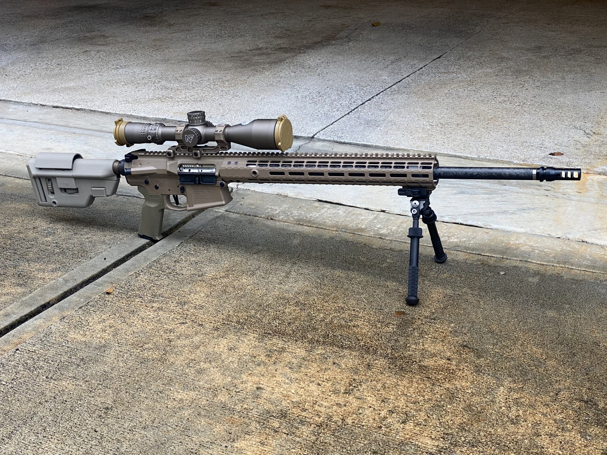

Another upper will turn into a second rifle.
Dont limit yourself
I wound up building an entire new rifle using an Aero lower and Aero M5 enhanced upper with a Proof CF barrel.
Reactions: J-Fonz and msgriff
Breaking in the barrel and fire forming some Peterson brass with 120 SMK blems the other weekend. It loves factory Hornady 147 and Berger 130 OTM loadings.
I’ve got an assortment of nice bullets and Staball 6.5 and H4350 to tinker around with to find some things it really likes.
