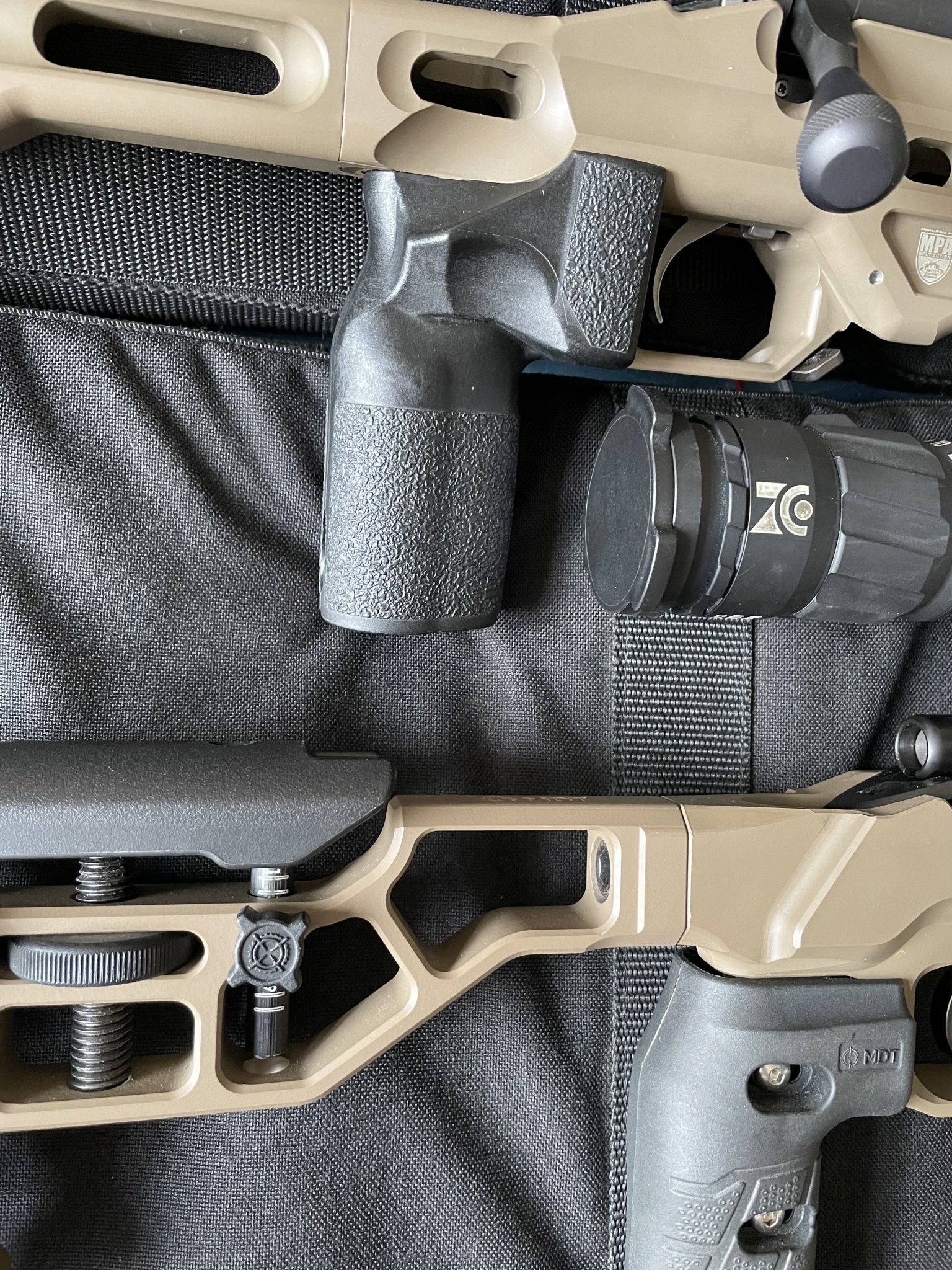

I think it's important that you understand that a properly-done thumb shelf involves both the vertical grip and the chassis itself. In the photo - especially with the MPA BA Comp chassis at top - see how they fit together?
The bottom rig is an MDT ACC. Their standard vertical grip has fore/aft adjustability, which might be advantageous for your large hands.
They feel slightly different. My preference? The MPA feels very slightly better to me (medium-size hands) but in all other respects I prefer MDT.
Either grip should mount to your RPR - just be aware that the RPR chassis doesn't have a matching integral shelf, although maybe the safety could fill that role. I've only shot an RPR once, and that was years ago with the stock grip and I had no concept at all of vertical grips back then.
Either grip will probably look a little odd on a firearm intended for an AR grip, and may feel odd too. I put an MDT vertical grip on an MDT LSS-XL chassis I had; that chassis was designed for an AR grip and the vertical grip pushed my hand (and thus trigger finger) about 1/4-1/2" lower than optimal. Was it better than a slanted grip? Yes. But nowhere near as good as on chassis designed for the purpose.
Hope this gives a little bit of perspective. Once you get used to a vertical grip for "precision shooting" (as opposed to run&gun), you will probably strongly prefer it.
Thank you. Very helpful indeed.
I was able to track down a few pics of an MPA EVG on RPR's and there is a little bit of hangover at the top tail end, without modification, but doesn't look too bad.
I also found a pic where it looks like someone feathered it with a dremel and seems to blend well.
This puts it higher on my list for sure.
Also, after looking at a bunch of pics, it does look to have a substantial thumb ledge, which would work well for me.
I may look into changing out the stock ambi safety that comes on the RPR if I go with the EVG.
I have a few on hand that should work well. One with a shortened right side lever that has a little nub that sticks out. That may work.
