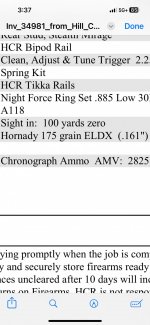

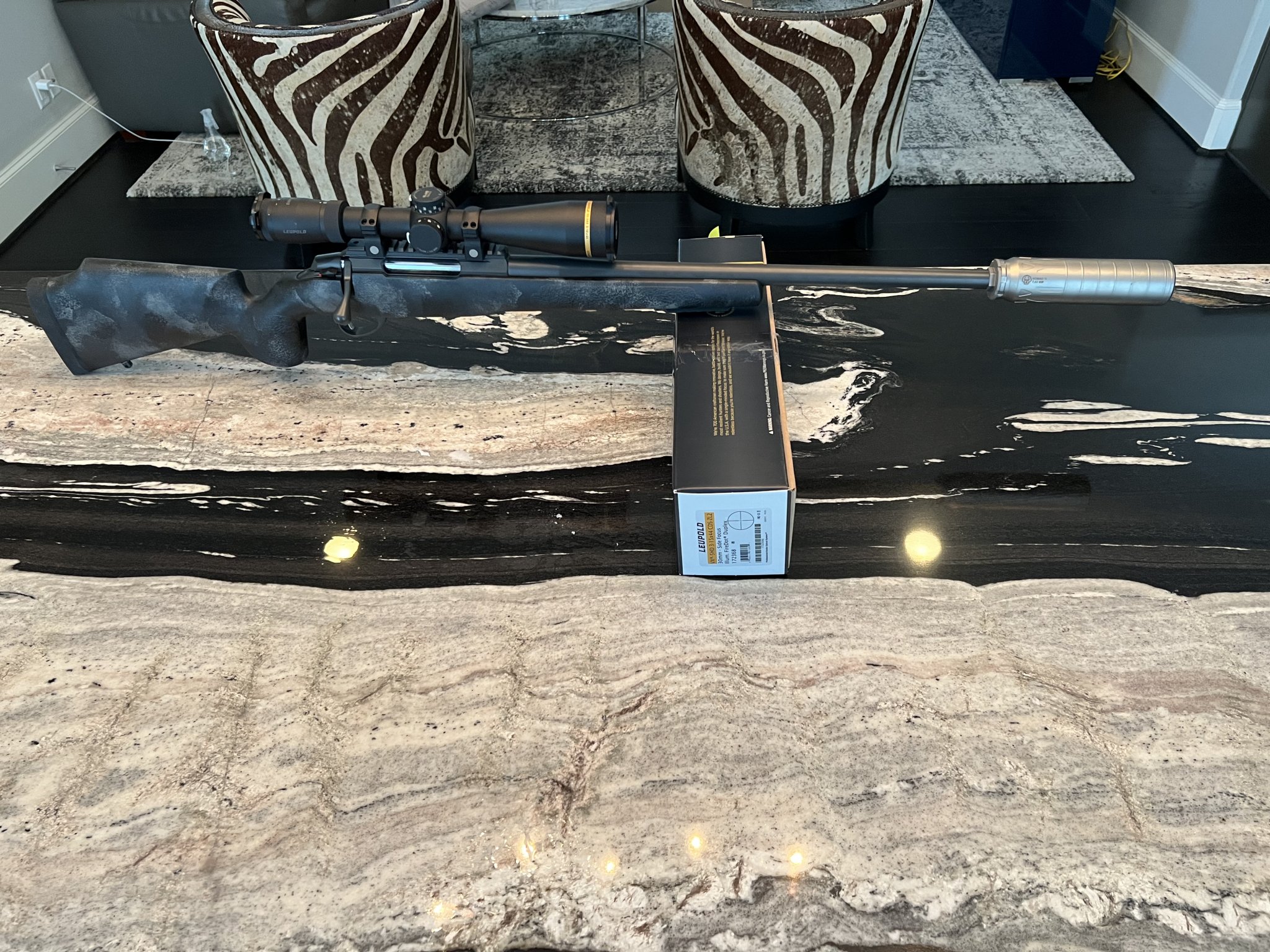

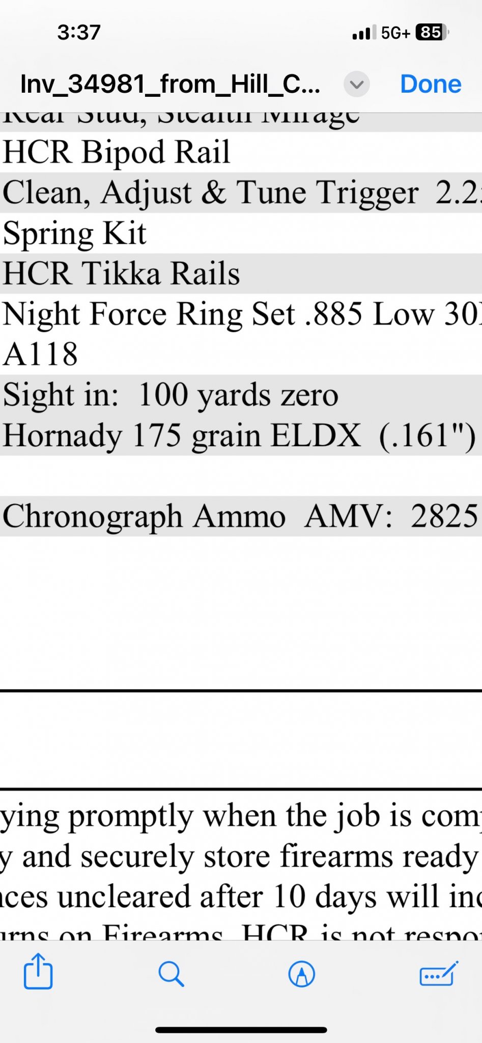

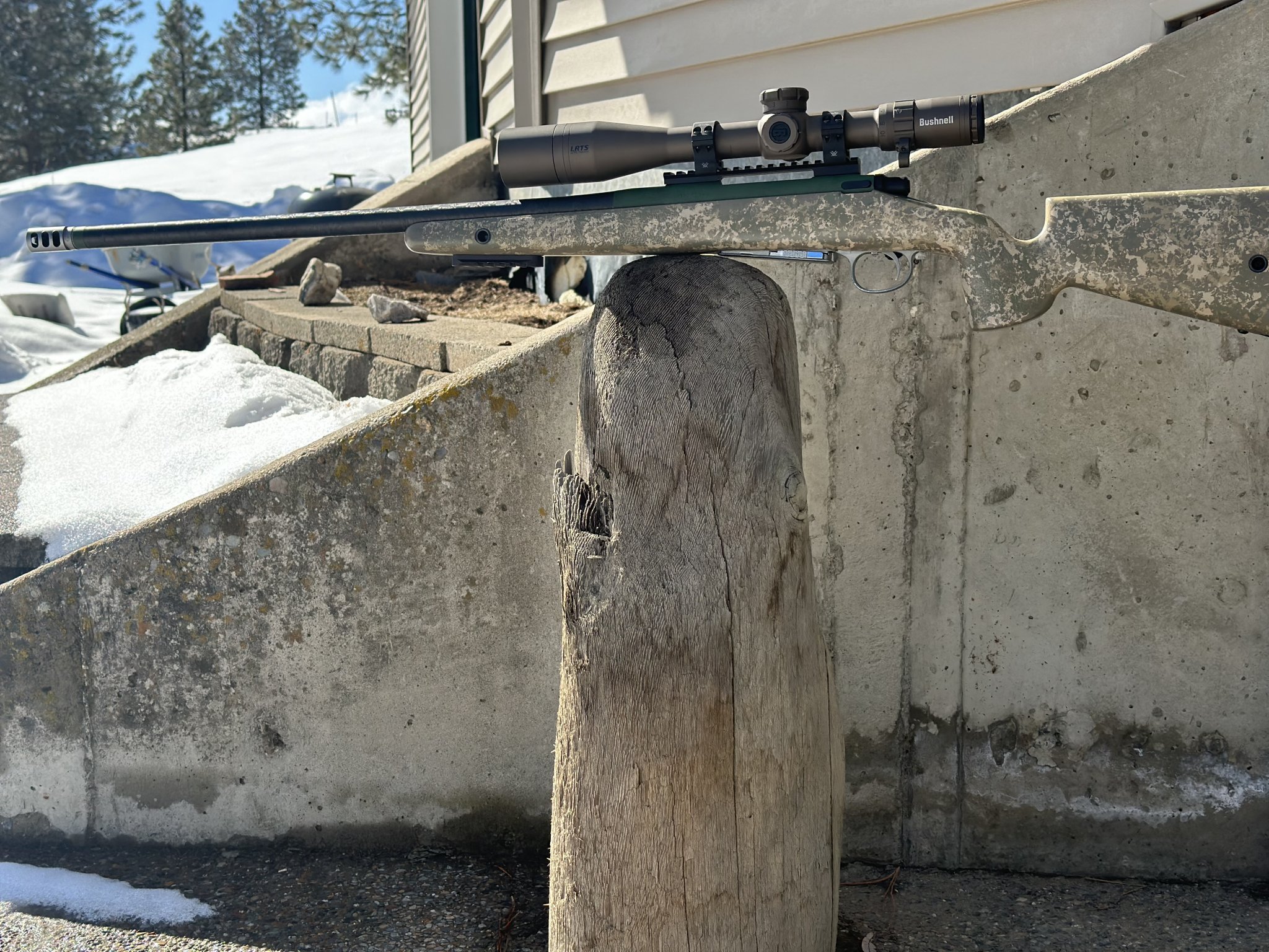

I just got one from a builder in new Braunfels, Texas. Couple of friends of mine have been getting guns from them for years. Hill country rifle,’s. I spoke with them on the phone and talked about a build, and could not be more pleased. First time out at 200 yards off a 10 year old bench Rear bag and bipod shot a .855 of an inch, actually 203 yards no time behind the gun until then. That group was the number 4,5 and 6th shot behind that rifle for me. A 20 inch barrel. i’ve always been a fairly light caliber guy 65 Creedmoor, 17 hornets, 6 mm Creedmoor, etc. I’m I’m going on an elk hunt this year and being told 700 yd shots are available. Yes I could’ve brought a 270,but wanted something with just a little bit more ass on it. This weekend loads will be worked up and we’ll see where I end up. hoping for 2900 or 29 and some change, but factory ammunition accuracy is astounding. They also promise you 10 boxes of ammo as well as getting the same lot that your group was shot from. All guns have a half MOA or better before shipped. Also, I believe the box says VX5, that’s actually a VX6 on the rifle.

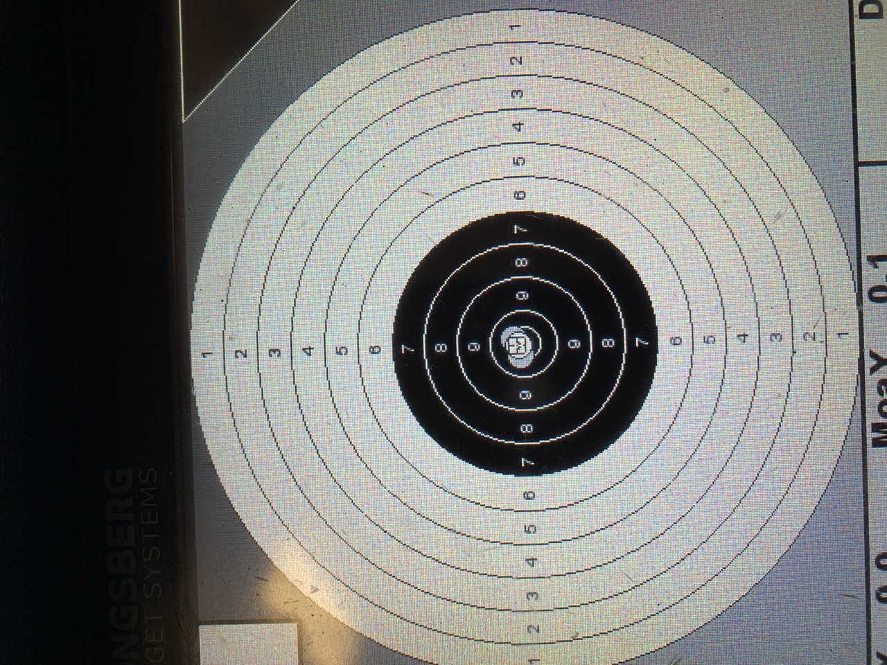

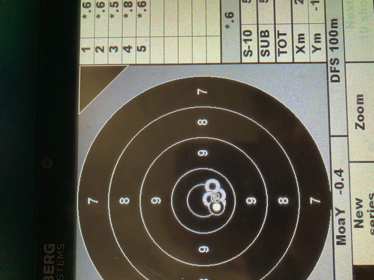

I purchased a Proof Research MTR Elevation In 7mm PRC. $3800. I topped it with Leupold Mk 5 HD. Here are my 5 shot groups with factory Hornady Precision Hunter at 100 meters.
