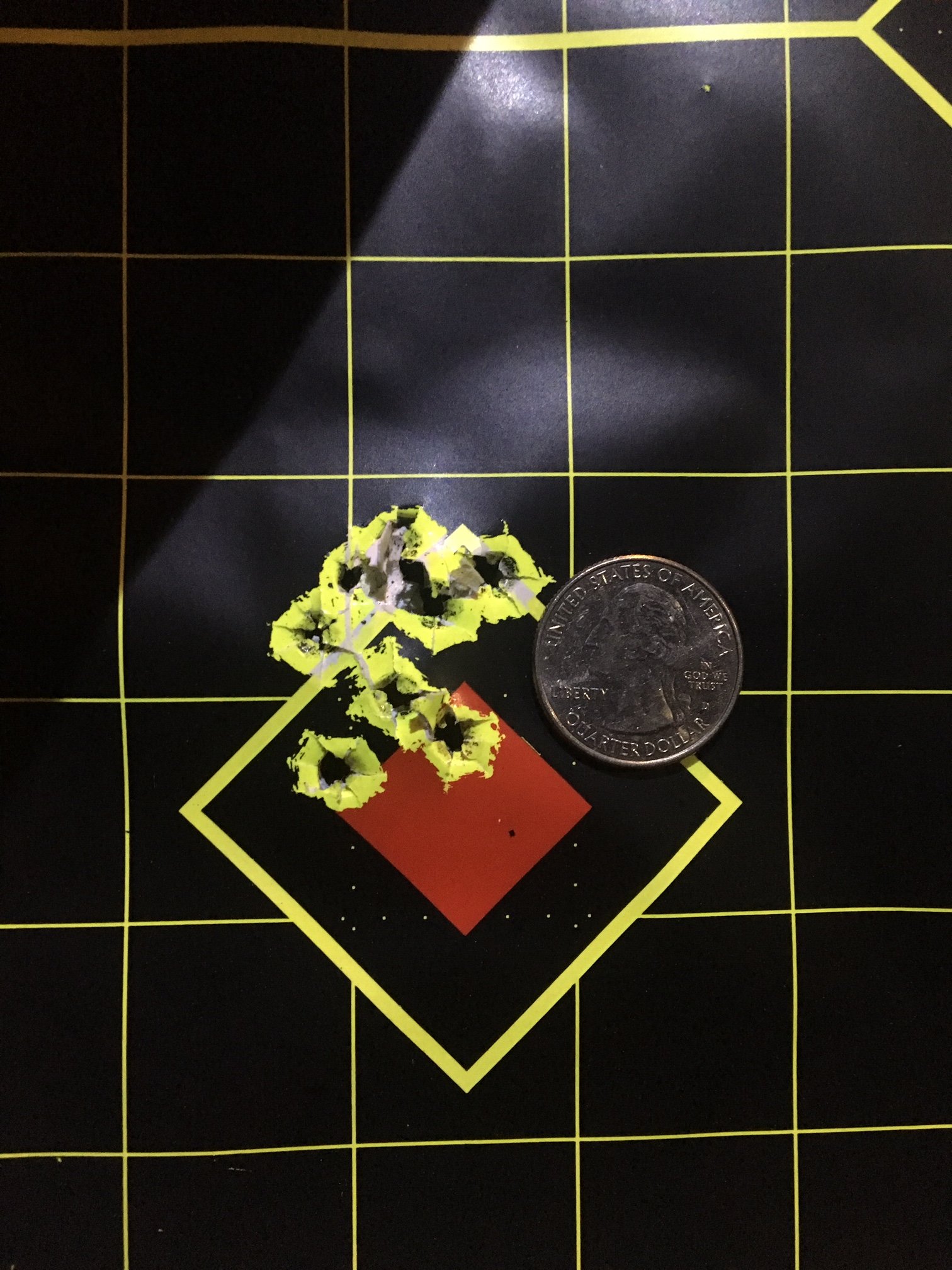

I really like the Ballistic Advantage premium barrels. I have two and they both shot sub-moa five shot groups at 100 yards. I can easily shoot a 10 shot group that measures under 1.5" in under 60 seconds with either. Best of all, they are on sale now under $200. https://ballisticadvantage.com/18-inch-556-hanson-mid-cmv-performance-barrel.html
