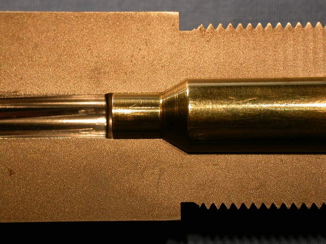

I personally keep my brass .003" shorter then the chamber neck, and trim every firing when the brass has come to length. But to go this close is potentially dangerous if you do not know what your doing.
You will need to monitor case growth a bit and be aware that unfired, once fired and annealed cases tends to stretch a bit more then work hardened brass.
Doing this little extra step in your reloading is not very time consuming,it ensures consistency and has a few benefits that makes it worth it.
Most importantly you greatly eliminate the forming of a carbon ring, and reduce throat wear.
To put it simply when the round is fired, the closer the sholuder of the case is to the chamber neck, the faster the brass will seal the chamber and eliminate backflow into unsealed chamber clearances.
The slower the powder burns the longer it takes the brass to seal the chamber in general at a proportional rate.
While the length of the case neck largely impacts the amount of backflow and how fast the chamber is sealed at a disproportional rate.
If you look at the picture it is quite obvious that if the brass would be longer, the backflow would have much less room in your chamber, and a steeper angle to overcome before it moves back into any unsealed clearances.
Now this can also have a small benefit to your es/sd simply because having all your brass trimmed to the same exact length will make neck tension more uniform, and in theory the pressure curve should be more consistent.
And by having a longer neck you get a bit more distance to use for compensating for throat erosion.
