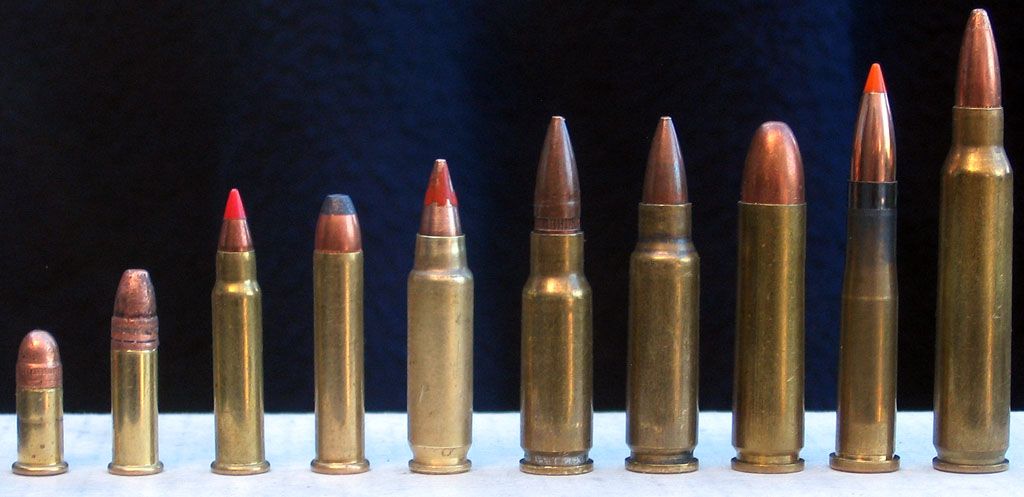

Another round I really like is the 22 spitfire. This is the 30 carbine necked down to 22. It has many of the advantages of the hornet, plus lots of magazine options. If you really want to be unique you can run the spitfire reamer in short. This has the effect of reducing the case capacity to slightly more than the K-hornet but lets you fit long pointy bullets in the 30 carbine magazines. I think this is a nice PD setup, a small bolt action rifle with a 30-round carbine magazine. It's not loud, expensive, hot, doesn't beat you up, etc... I've attached a picture of some small rounds up to the 223, and you can see what I'm talking about with the 22 spitfire, the short version, and a 30 carbine for reference.
