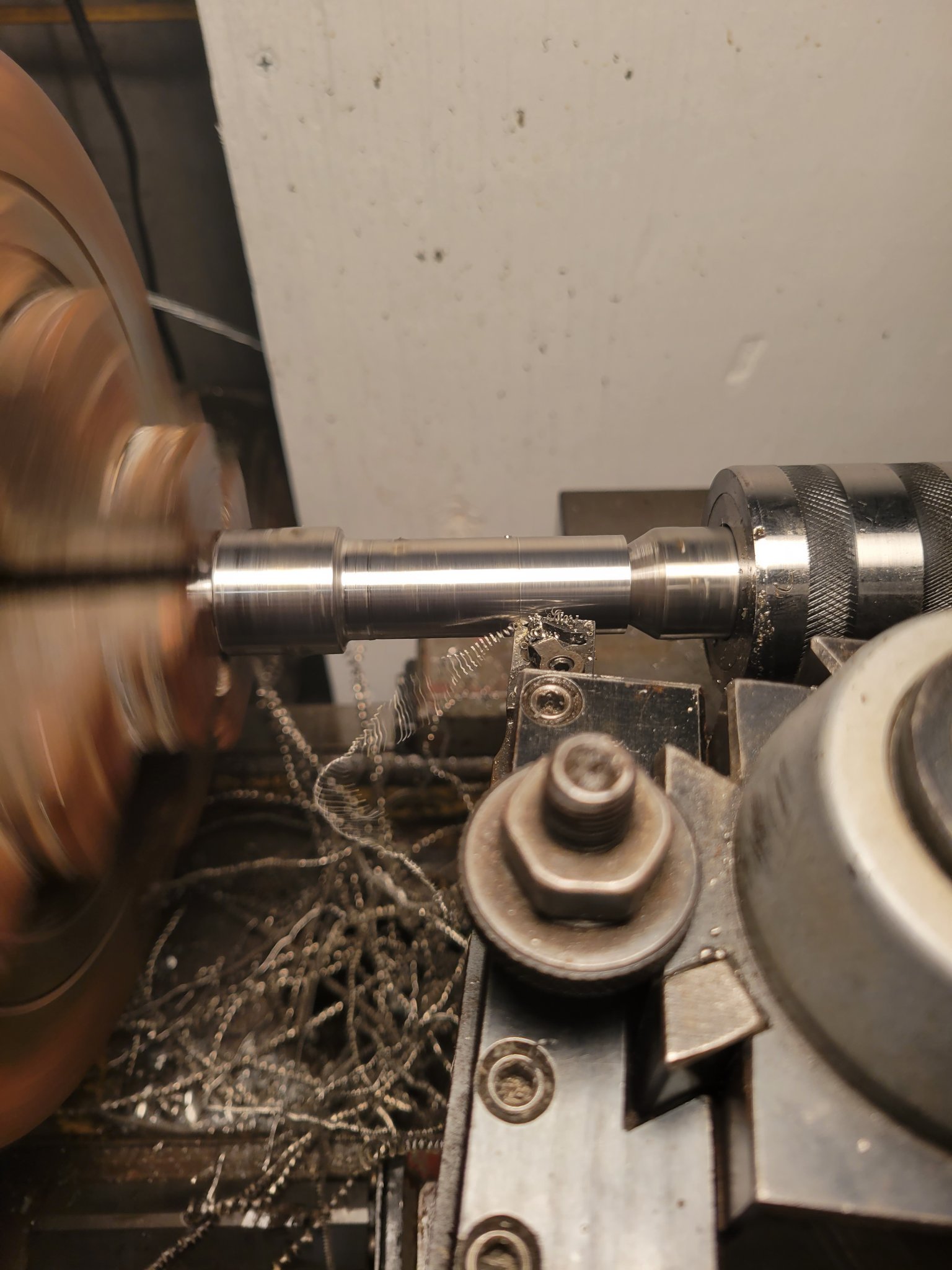

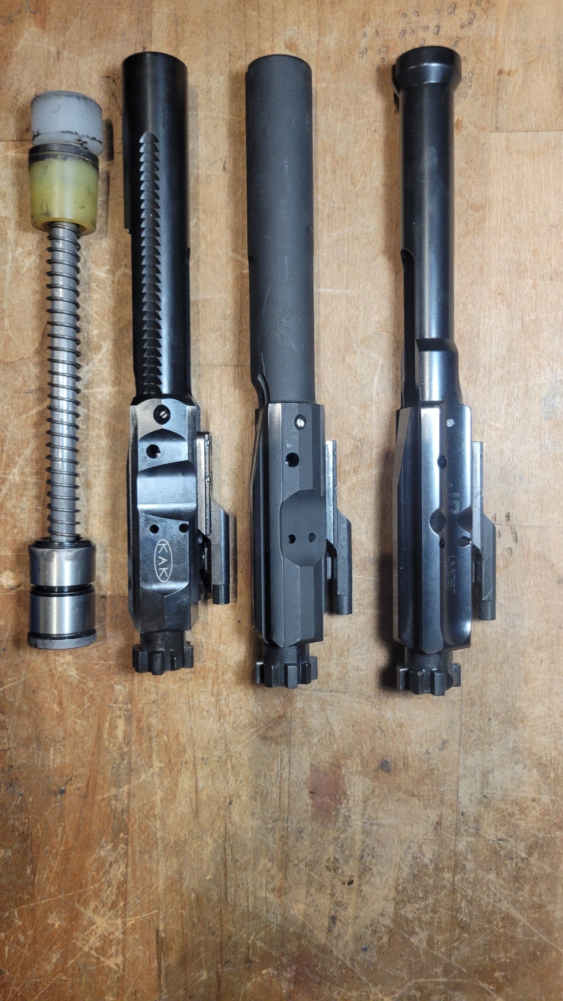

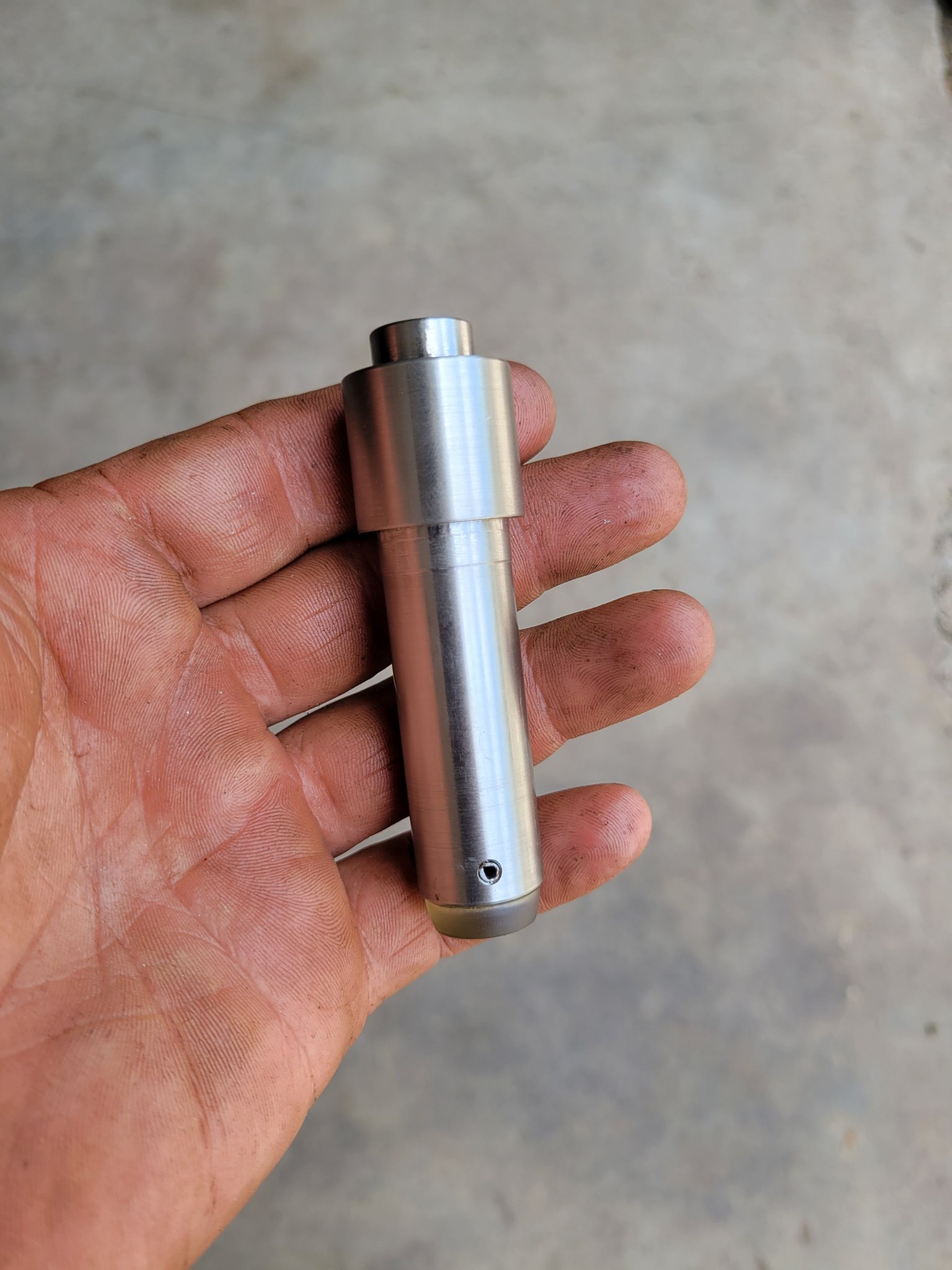

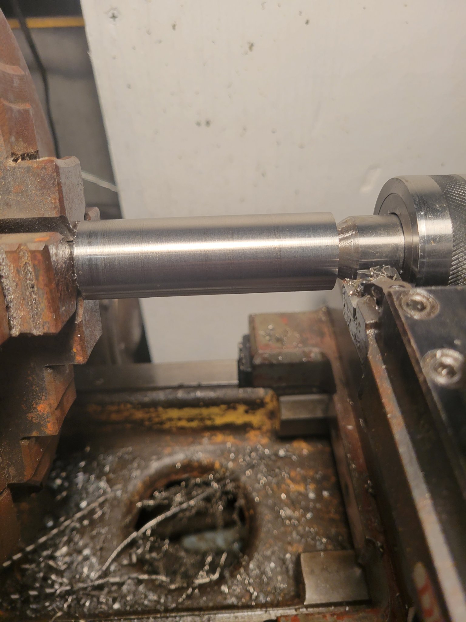

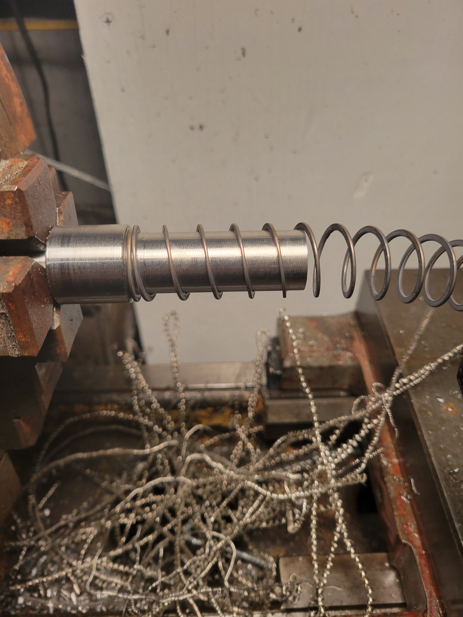

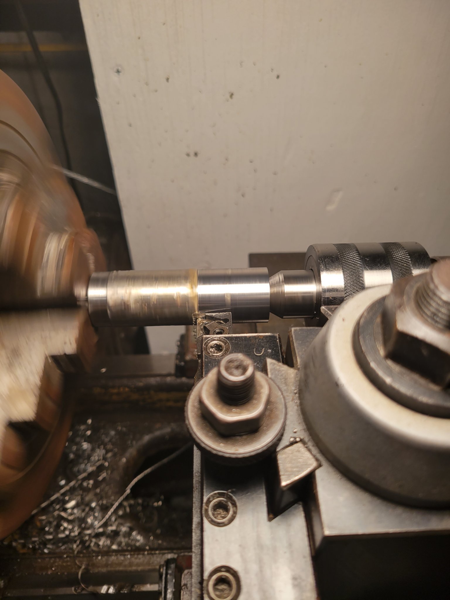

I've been going round and round with a PWS large frame in 308.
Went to an A5 tube from LMT, a Tubbs flatware spring and made my own custom buffer that came in around 11.5oz. Runs good now.
Had problem similar to the OP. I'd get 1-3 shots and then click. Rack it and bang, 1-3 more. Best I could tell it was bouncing put of battery enough to still let the hammer drop but cause a light primer strike.
Heavy buffer and a spring with the A5 tube fixed it.
11.5oz? Dear lord.. did you grind a block of tungsten down???
Humor aside - how does that thing feel?
Recoil wise ? It actually feels really good. I think the Tubbs spring had the biggest effect on overall feel.
Initially I had tried the car-XH from heavybuffers.com with their heavy spring. Kicked like a mule and it was a sharp recoil impulse. Was no fun to shoot. Spring change smoothed it out. Spring, A5 tube and a mondo buffer made a pretty nice combo.
Definitely a full mass setup lol.
I cannibalized my car-xh and my factory buffer for the weights and tge rubber plug.
View attachment 7938374View attachment 7938375View attachment 7938376View attachment 7938377View attachment 7938378
Is that last picture showing an extension that nests inside the bcg?
I have always wondered about the tubbs flatwire.
I used the 10oz rifle buffer from slash and the included spring. I changed, went to a5 tube and the kynshot. Forget which model number. It changed the feel. I had thought about trying the flatwire, but went with the sprinco red. Suppose one day I will spend the $20 on a flatwire.
That buffer is definitely huge. I bet the forward reset really pushes the muzzle down.

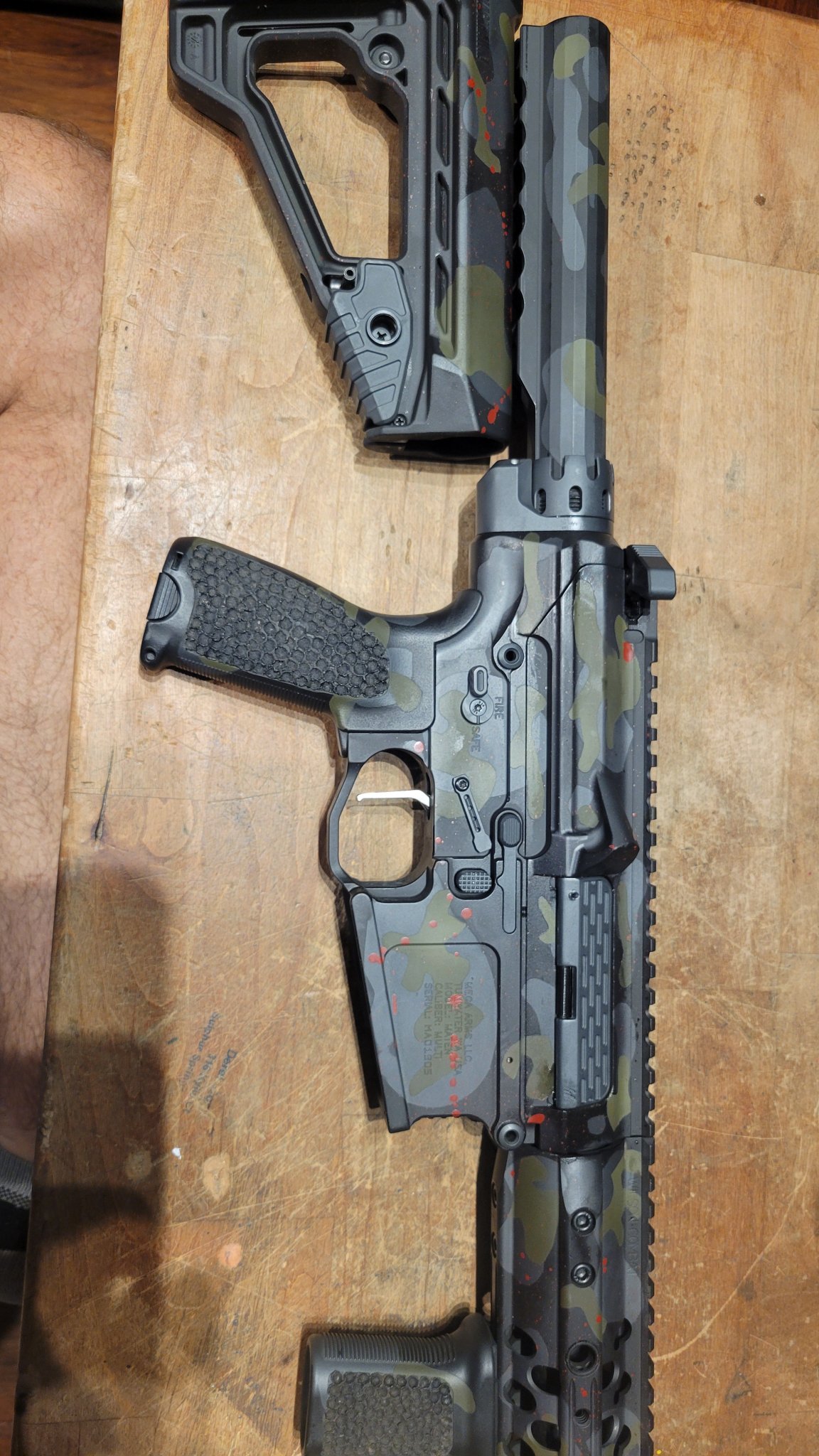

Share some photos of the issues. Check all the spots mentioned. Clean and lubricate the firearm. Perform the feeding test as described. Report back.

I have 1000rds 140 ELDM (stand one armory) and 800rds of Hornady 95gr varmint express.
So need to find combination of components to work with existing ammo.
Have V7 titanium buffer tube.
Also have a
JP LMOS with Titanium Fire Pin

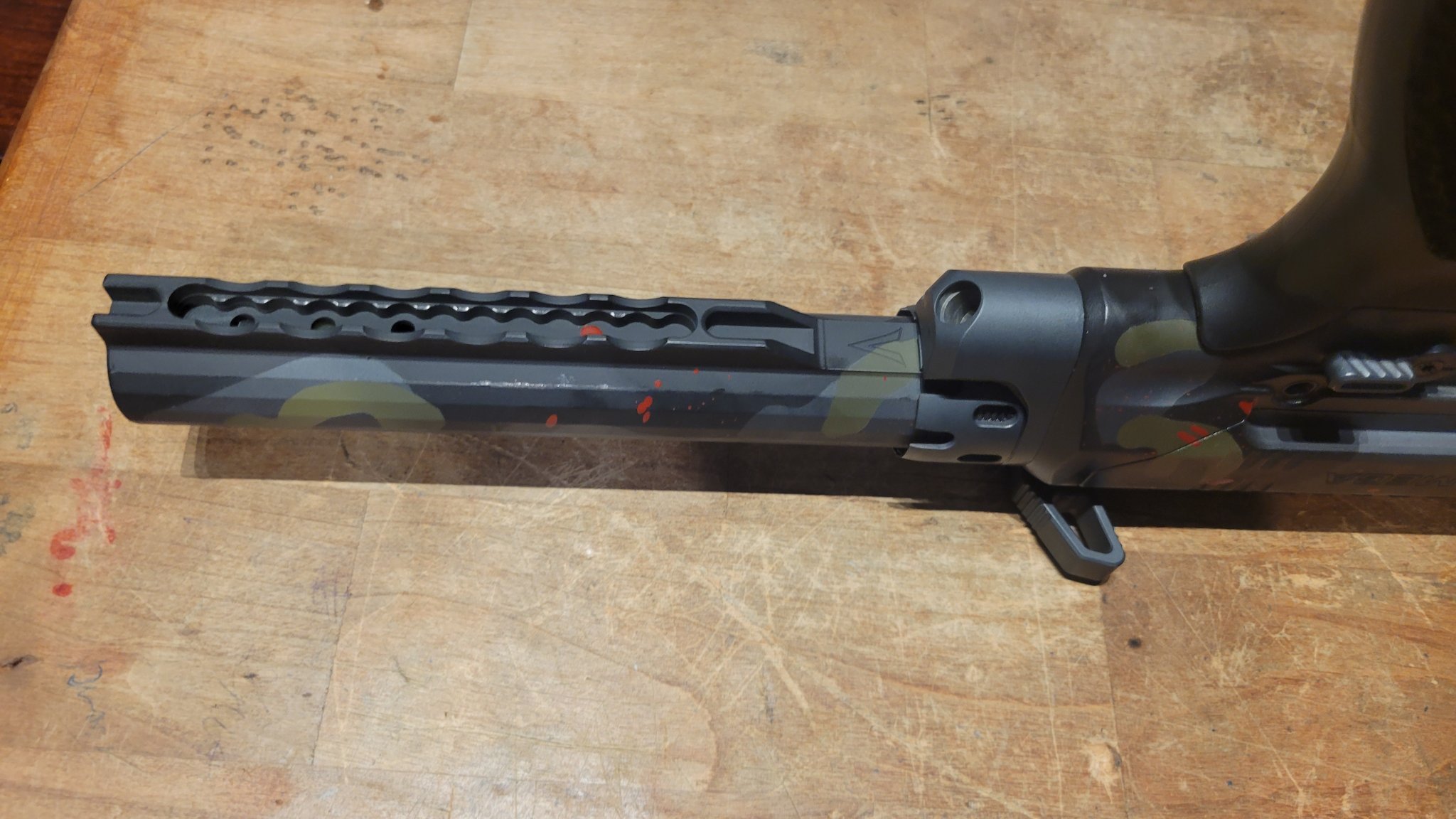

GAP 10 BCG (from Hide Member)20220821_130722.jpg20220821_130802.jpg20220821_132908.jpg20220821_131907.jpg20220821_132319.jpg
KAK High Pressure Double Extractor BCG
Th

From what can see on the kak website that BCG should be full Mass and good to go.
I shoot 100% suppressed.
Removed can after being fed up with issues.
Yeah, need to initially get it running without the suppressor. That would increase the bolt speed even more. Once it runs ok without it, then you can put the suppressor back on and probably turn the gas down to compensate for the extra gas due to the suppressor.

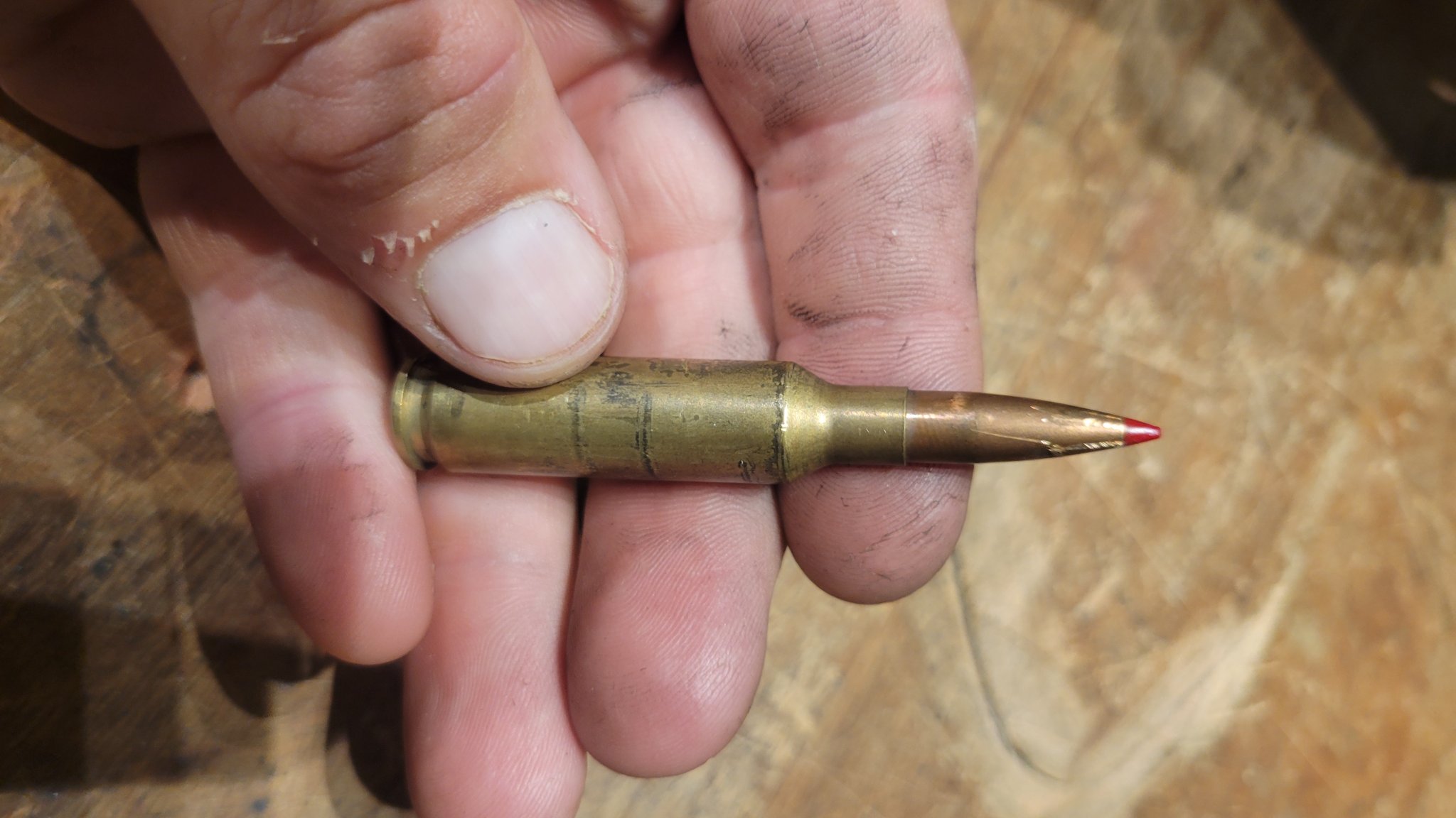

Also, in your pics that's one long pointy bullet there. Actually appears to not be seated deep enough but I'm NOT familiar with 6.5 at all. Looks like it could cause some problems getting slambanged around in an AR though.
You have 2 perfectly fine BCGs from what I can see, just need to get a decent buffer and spring.
