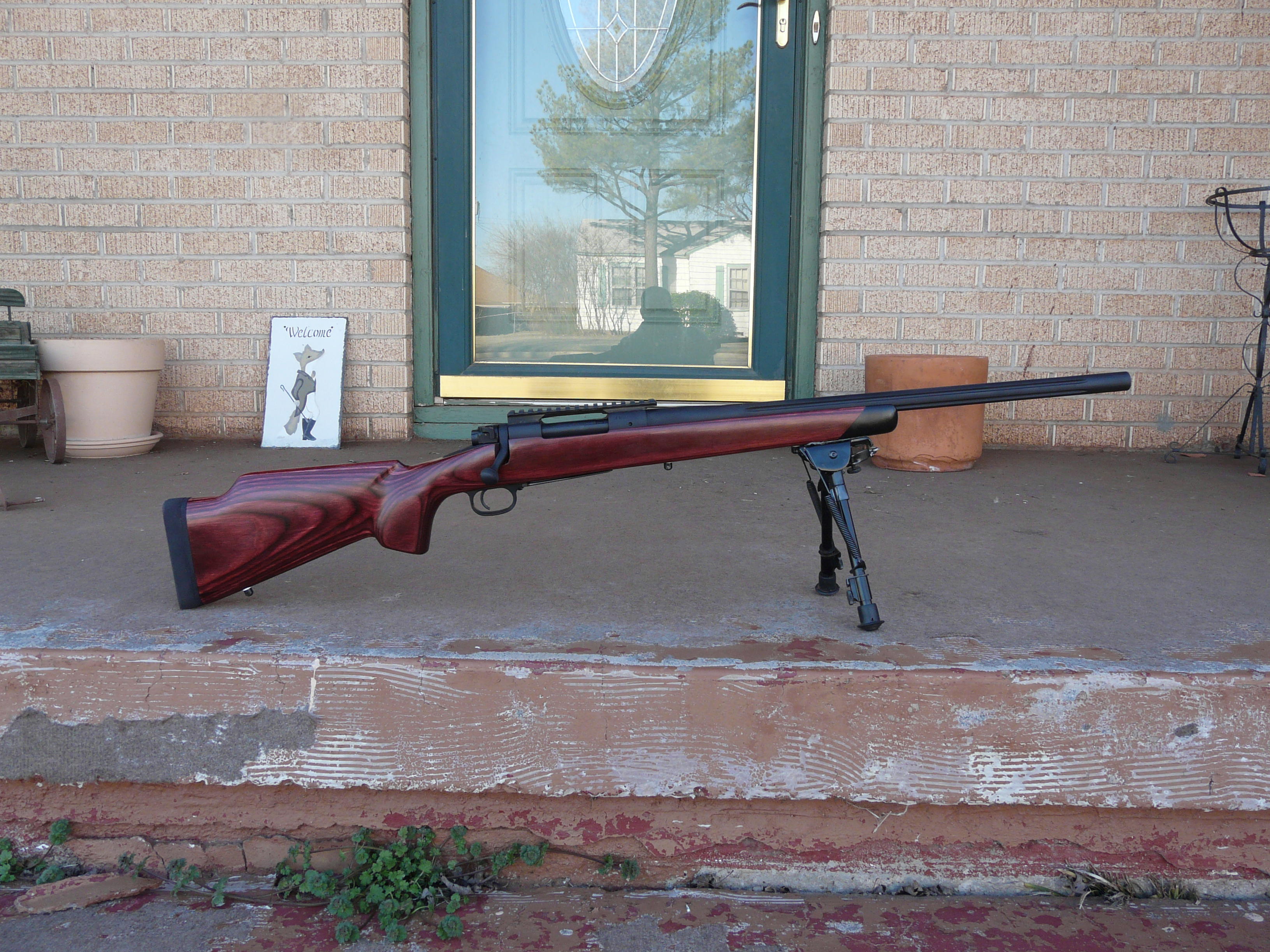

I use a 22" fluted medium Palma on my hunting rifle and I find it just right for weight and balance. The whole rifle with 4.5-14 scope and Harris bipod runs 9.5 lbs with a laminated stock.

Thanks for your input, that sounds pretty sweet. Any chance you could add a picture of this rifle?
My rifle would be a bit lighter if it weren't for the Farrell steel one piece base, 6-24 optic and tactical shaped stock (wood).

Here is a photo of it right after I finished building it. No optics mounted had been mounted yet.

Do you see any down side to a medium palma with fluting? I guess I am really just asking if there is a downside to fluting in any barrel configurations?
When done properly, fluting has no negative effect on accuracy. When not done properly, it can. I had this one done by GAP so I was confident that it would be properly done and it absolutely was.
That is just seeing the fluting from just the right angle. It doesnt really taper down and then back up.
