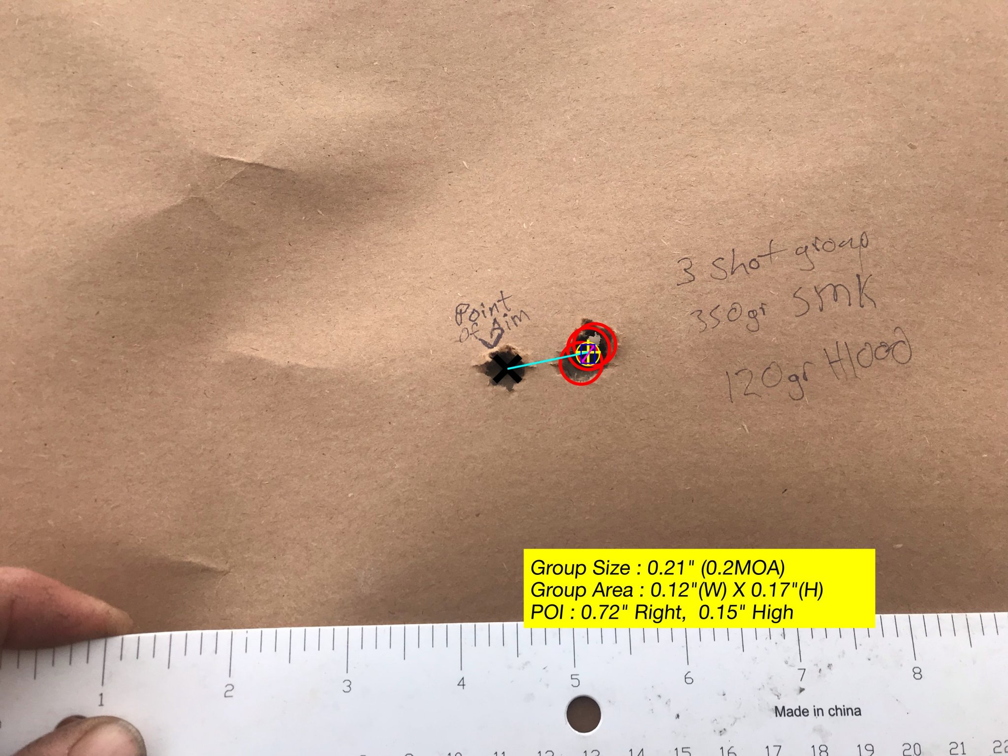

I’m seeing great accuracy in mine. 350gr smk at 3078 FPS. 32” barrel
Bullet hole off to the left is poa

Great group! I’m waiting to hear back from SSS if their schneider barrels will fit a savage action... not sure it’ll work. Seems like if it would they would have known already. What’s your action, stock/chassis and trigger? Also, what brake/suppressor are you running?

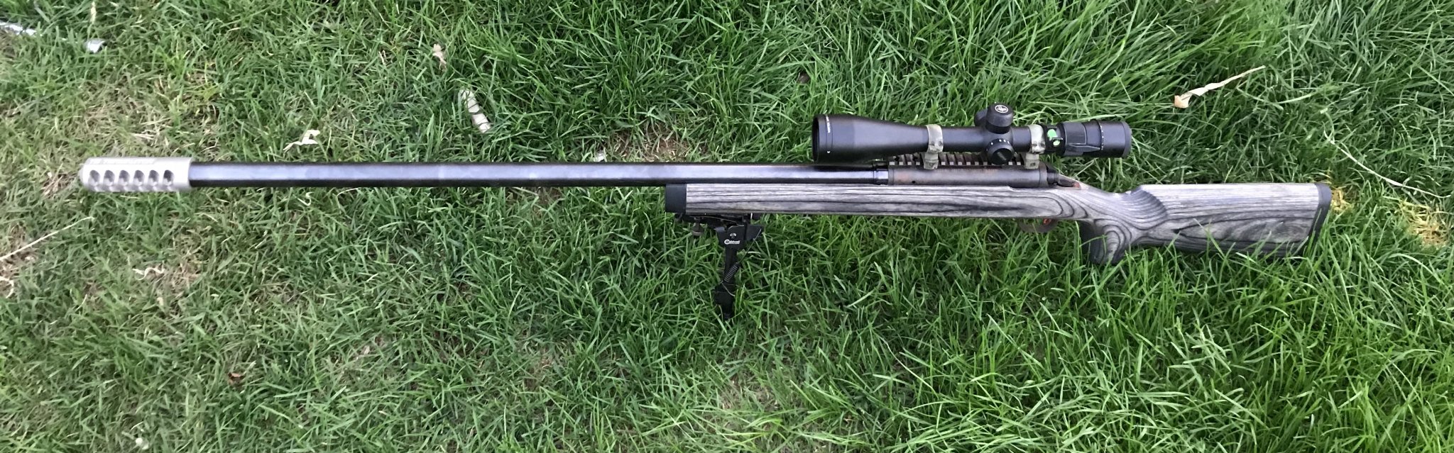

Man that’s super impressive! Do you have a picture of it on your rifle by chance?
That’s awesome! So i think you said that is the factory barrel is that right? I’m waiting to hear back from David Tubb if their Schneider barrels are threaded for savage (shouldered or prefit). It sounds like I’m 12 weeks out on getting a blank and then whatever turn around time I can get a smith on my end which would probably mean a couple months more. I’m just going to shoot my 110 elite precision in 338 LM until I get the setup back. Pretty encouraging... that’s a great group for a factory setup from none other than savage.... which I love! I have a half dozen savages that will shoot sub .25 MOA factory and it drives my buddies nuts... me too when I spend a bunch on a custom rifle that won’t shoot as good as a $2-300 savage lol.

No sir it’s a McGowen prefit that I chambered my self
Nice. I have a fabrication client of mine in Salt Lake that just purchased a 100k+ large and is planning on starting to spin barrels on the side. I might look into that. Which reamer did you end up using? The .100 or .250 free bore? Did you do the P5 rifling or something else?
.250 fb from ptg
Normal 6 groove McGowen rifling. This was just a test build to decide if I wanted a custom 375 cheytac or 37XC.
Next build will be Stiller tac 338 with 34” k&p barrel 1:7
