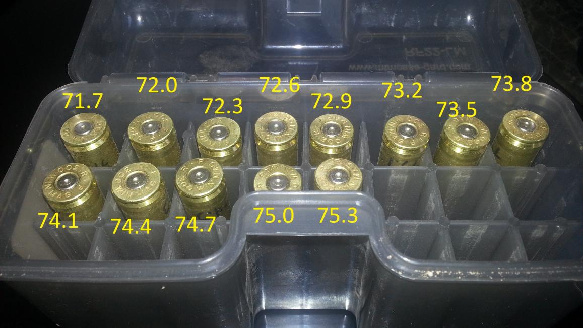

So im getting into load development for my rifle.
Caliber is 300 Win Mag
Rifle is a Remington 700 Sendero II bought new by Me, placed in an AICS chassis, with APA fat bastard and timney trigger, vortex viper PST 6-24 scope
Load is brand new Remington brass, CCI large rifle magnum primer, Hodgson H1000 powder and Hornady Amax 208gr bullet. bullets are seated .010 off the lands.
ive loaded rounds for it over the last year and everything ive loaded for it has shown a cratered primer. haven't seen flattened primers or hard bolt lift.
So today I decided to bring it back to basics. I started with the minimum recommended load from Hodgson of 71.9gr. and increased in 0.3 gr increments to 75.3 and went out to shoot. I shot all the rounds over the course of about 15 mins. shot at 100 yards at paper target. The rounds started about a full MOA left and Half MOA low. at the end they were A half MOA left and elevation was dead on. holding dead center from a previous zero.
the accuracy seems to be there. had 3 shot groups of about 3/4 MOA. but when i inspect the rounds. even the lowest powder charge shows some minor cratering. No flattened charges and no difficulty raising bolt.
IS THIS NORMAL!?!?!?! Im still a novice loader but how am i supposed to find the charge limit of my rifle if im showing signs of pressure the lowest recommended powder charge?
I want to get an OCW test going but i have no idea where to start with my charge. Any suggestions.
Sorry for the long post, just really confused at the moment.
Thanks. Heres a pic of the casings.

You are most likely seeing the typical Remington 700 primer flow not actual cratering due to over pressure. As you noted, no heavy bolt lift, or flattened primers or ejector swipes. Google Remington 700 primer cratering for more details.

wow, im the kind of person to research the crap out of things and I cant believe ive never heard of this. very interesting. Im inclined to believe you guys about the R700 cratering thing. makes the most sense. I guess with that being said, I am back to square 1 again on load development.
Where should i begin with my load development OCW test? Hodgson states maximum load to be 78gr H1000. So 10% off that would be 70.2gr. then add 2% per group of charges and work my way from there?

My experience with H 1000 and 208 Amax in my sendero is a sweet spot at 76.8 grains. Do a search on the 208 Amax and H1000 you'll find a lot of guys finding their node somewhere in the 74 to 76.? Range.
Good luck let us know how it goes.
Ps don't worry about finding MAX load so much as finding that rifles accuracy node. Run a ladder test at distance using 74 to 77 grains and a crony. You'll find your node that is most important thing. Speed should wind up in the 2800 to 2950 range depending on your gun
Also my primers look like that outta my Sendero , FWIW

I have read and heard and seen "cratering" such as pictured by the OP quite often from owners/others familiar with Rem 700's, and many folks more experienced than I say it is from an "oversize" firing pin hole.

It has been reported that the flow around the firing pin is a design element to reduce leakage through the firing pin hole in the bolt face when a primer leaks. However if you don't like the looks, you can have the pin hole bushed to fit the firing pin tip more closely.
Try the 215M federal primers, that may be a solution, rather than rebushing the firing pin. Not at all unusual to see M700 primers like this. If you don't have ejector swipes, pierced or blown primers, you are not at max load yet.

The cratered primer is a typical Remington thing, now days. I see no other sign of pressure. If your primer flows outward and fills the crack around the primer or you get brass flow around the extractor, then I would back off. Lightman
Has anyone seen bolt faces with the firing pin hole chamfered, showing similar to cratering when pressure or type of primer is used.
CCI primers silver in color having a harder material than maybe Remington primers.
