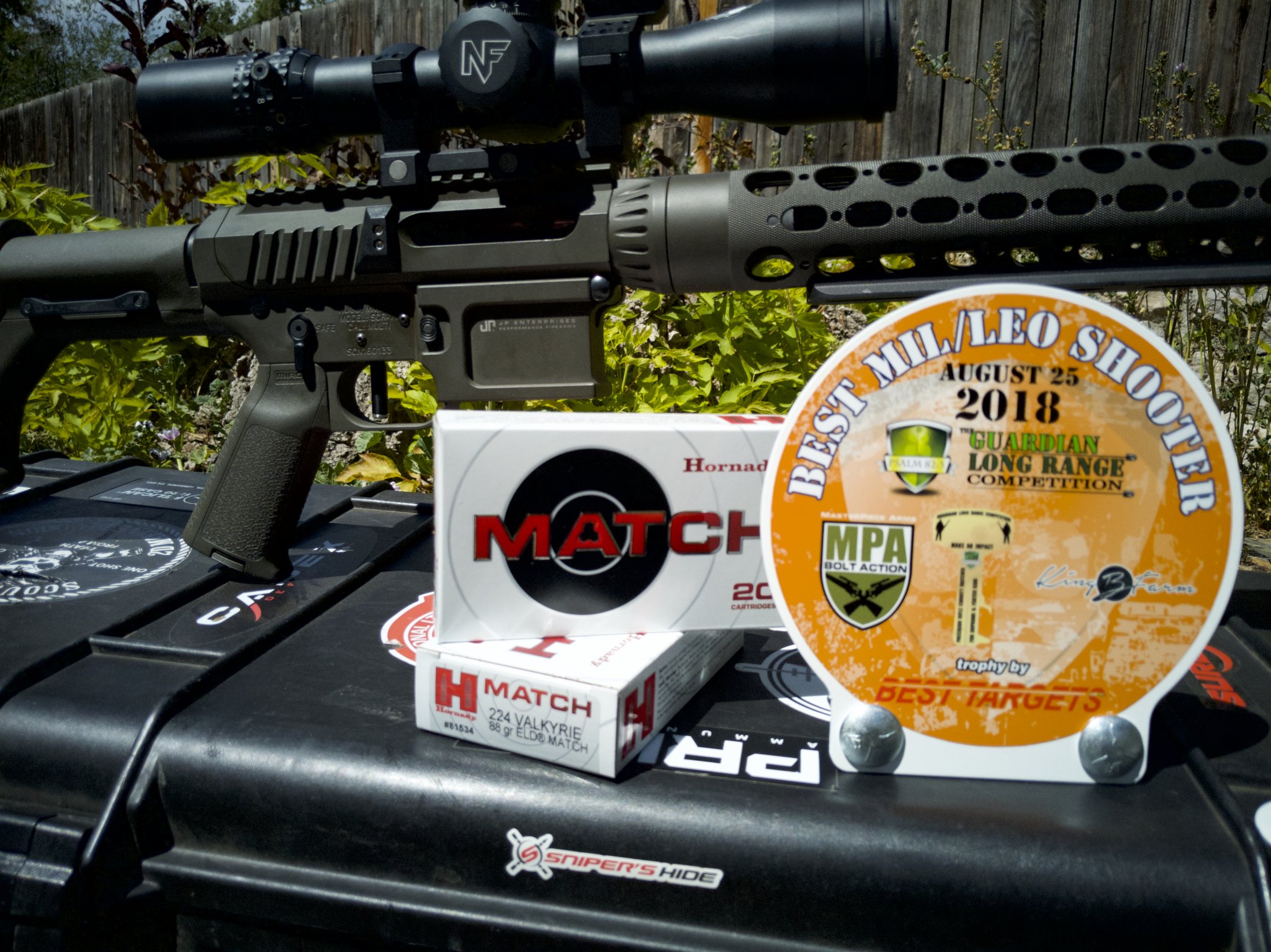

    I ran my JP Rifle with a 22" Barrel and the factory 88gr going 2730fps
    The results, top 15 at the Guardian Long Range Match
    The 75gr Stuff was 2930fps and accuracy was superb. The only issue I saw with it, the round falls apart in the wind after 600 yards. The 88gr is much more consistent and doesn't have the same wind issues until 800 yards. (750 is really the cutoff)

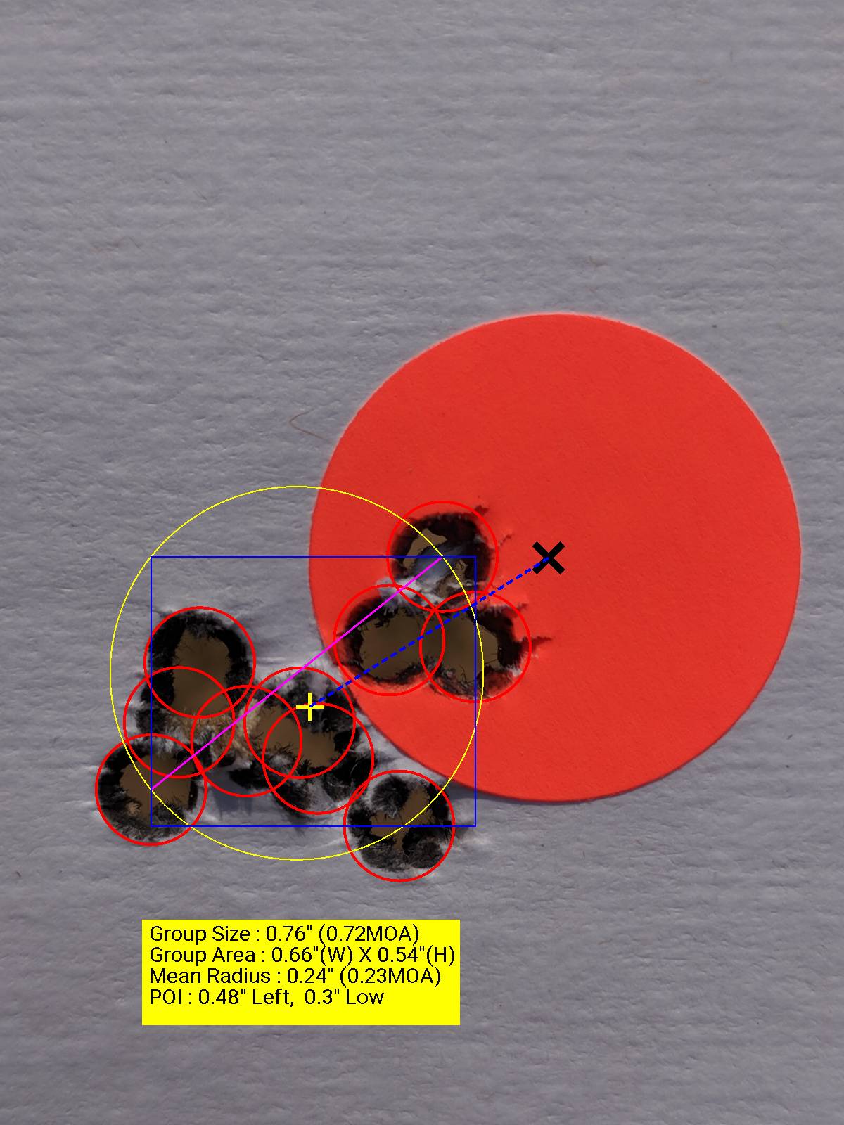

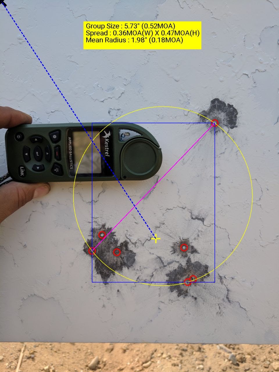

    Really don't like contradicting posts (especially not @Lowlight ! ) however, I have 1000+ rounds through a 7.5T. If your buddy has a Rainer 1-7.5"T, then we shoot the same barrel. I have been shooting the 88ELD (Handloads) exclusively for the last 500 rounds through the rifle. It is stabilized just fine out to 1060 for me; here is 7 shot group at 1060yds:
    That was running at 2780 but it runs fine at 2700-2740 also (I've been testing lower node and hitting .5-.75moa at 400yds). Here is 2720FPS 100yd 10shot group:
    While the bullet (ELD) is long, using the Miller formula will show you Marginal stability at best however, you need to adjust for the fact that the plastic tip is less dense (Miller formula is based on all metal projectile. If you use copper length of 1.1 at 88gr, you will find it to be fine. Anything over 1.4 is good. I ran calculation at 1000ft down to 0 degrees and still within decent stability for our twist rates.
