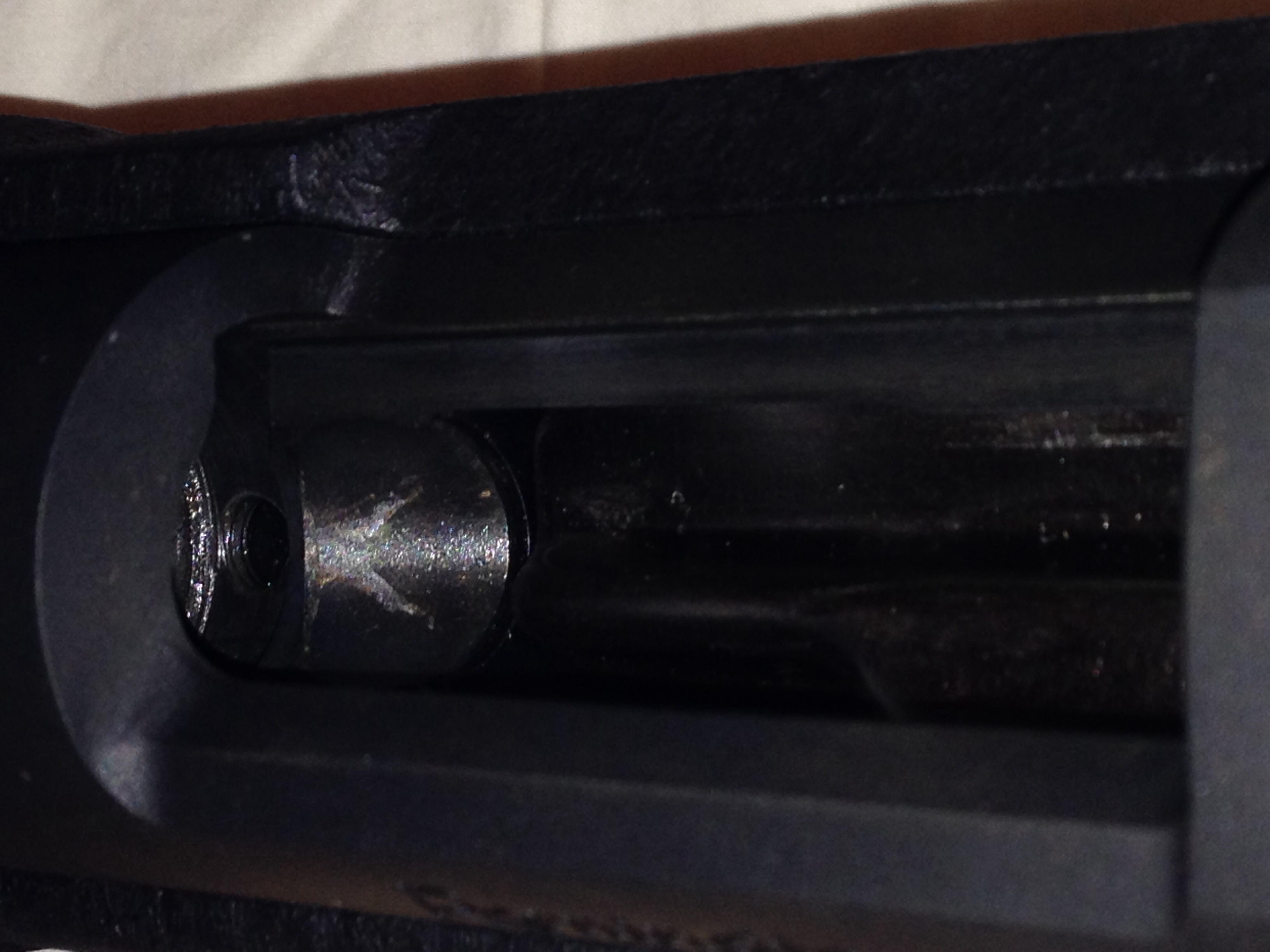

A little polishing on the feed ramp and chamber should easily solve that.
Should I just take it to a gunsmith i really don't want to mess it up or something but damn I'm a lol mad this is a brand new rifle and it scratches the bullets bad
yep, they take some polishing. the surfaces are sharp from the factory. with mine, I took 3 rounds and cycled them through repeatedly. that will reduce, but not eliminate, the case scratching.

image.jpg right when I opened the box I noticed these marks on feed ramp
